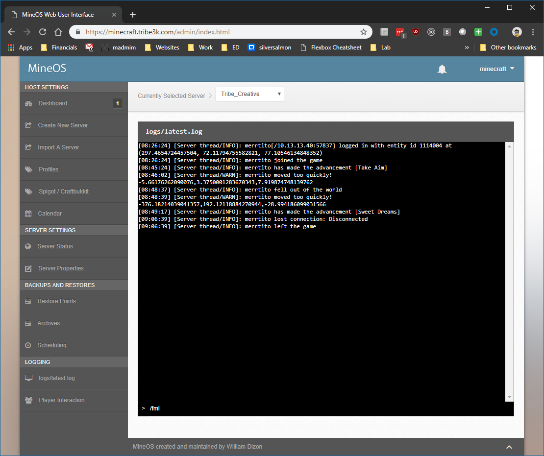

[Support] for atribe's repo Docker images
Don't know. I do reverse-proxy mine with traefik and it works fine. Are you directing it to the https version or you mineos ip address?
I map the port to the host and use the host ip address

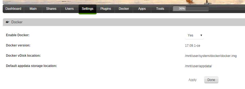

Sounds like your docker is not setup correctly. Do any docker containers persist? If not I'd check your docker settings to make sure they are similar to what I have.
