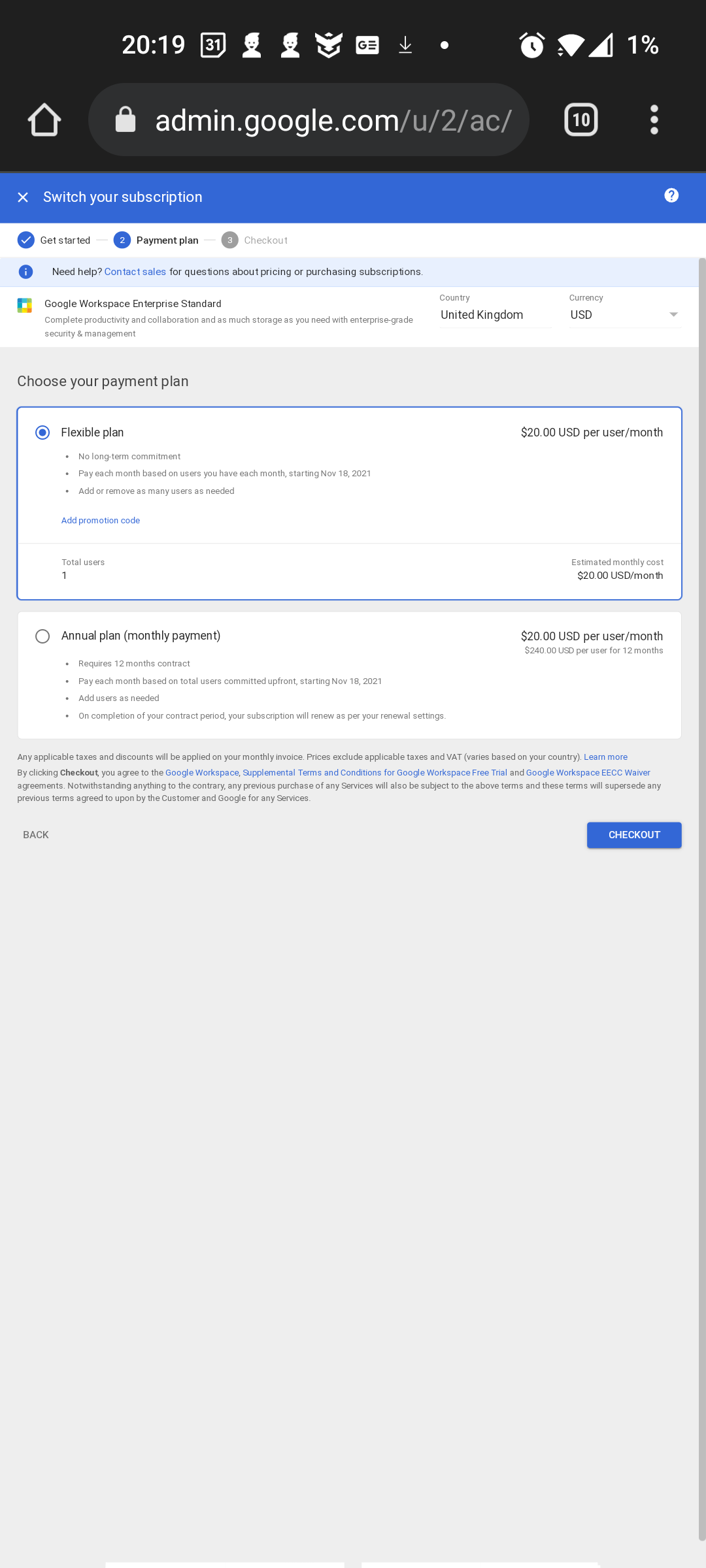

  14. Not sure, bit Enterprise Standard comes with unlimited storage and costs $20/mth

  22. If anyone finds a discount code please share!
  23. You can definitely buy enterprise standard for one user - here's my page (email just arrived). $20/mth is still a good deal. I'm going to purchase the annual plan even though there's no discount, in case Google change their mind
