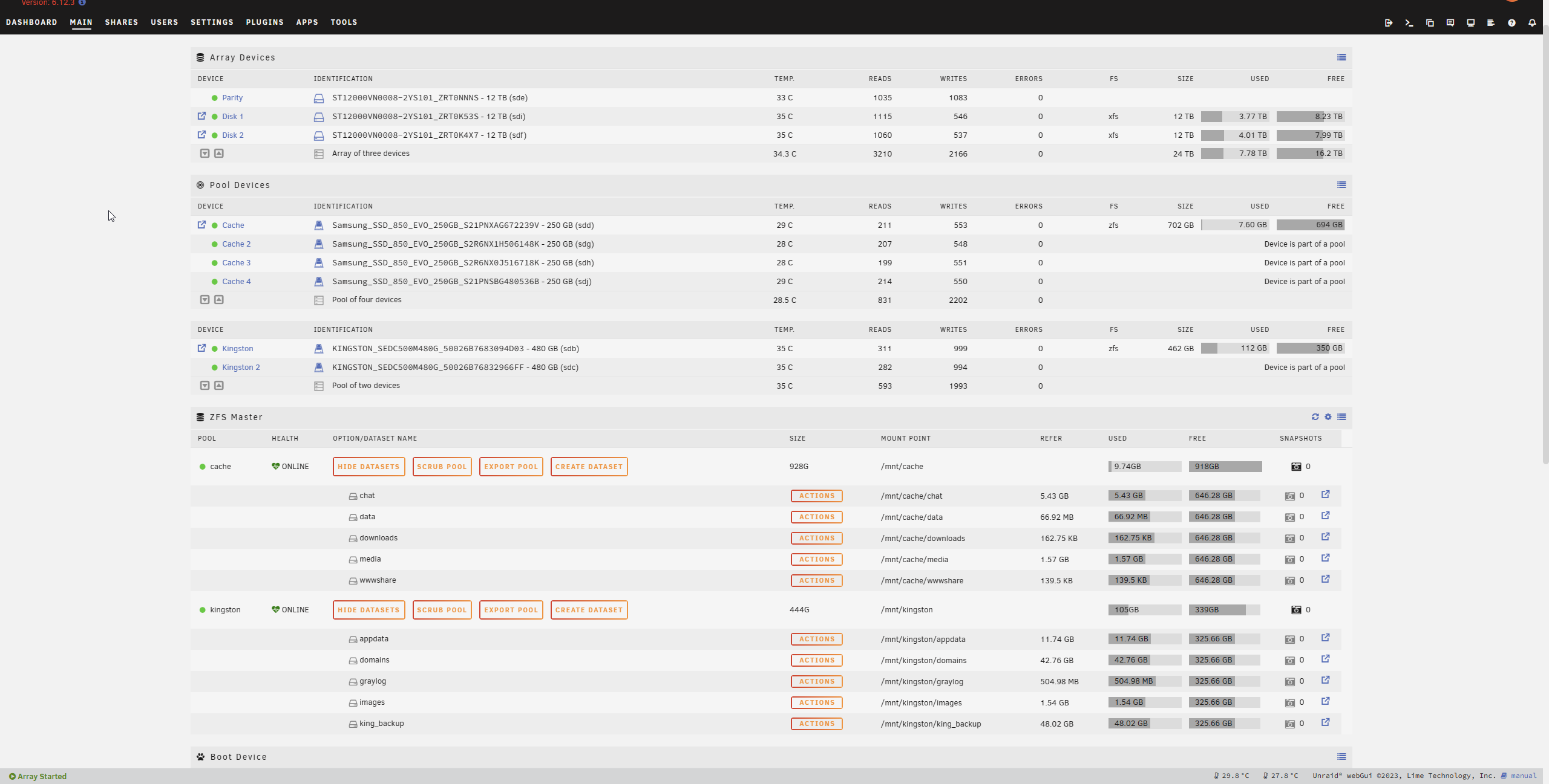

  1. Will be alot of text so i can try to explain what i did. tldr; changed pools to zfs, did something, now shares dont show and i can't create new shares on zfs pools only array. Upgraded from 6.11.5 to 6.12.3 couple of days ago. Three days ago i changed my cache to a zfs raidz pool, worked fine. Yesterday i thought i would change my other ssd pool KINGSTON to zfs also. Moved files off it and reformat it. At one point i decided to reboot for some reason. I got the following error. (ignore the date/time and servername, someone elses log but mine looked like that) Jul 24 18:55:48 CappiServer emhttpd: shcmd (4745): rmdir /mnt/user Jul 24 18:55:48 CappiServer root: rmdir: failed to remove '/mnt/user': Device or resource busy Jul 24 18:55:48 CappiServer emhttpd: shcmd (4745): exit status: 1 Jul 24 18:55:48 CappiServer emhttpd: shcmd (4747): /usr/local/sbin/update_cron Jul 24 18:55:48 CappiServer emhttpd: Retry unmounting user share(s)... Couldent figure out why, but i suspect it was a old 'screen' command that was still active i think, not really sure. Rebooted anyways. Somewhere in between this i set my KINGSTON shares to transfer from the ARRAY to KINGSTON. Oh, also put docker directory on KINGSTON zfs, which is a nono i guess? Got like 200+ datasets and the main menu was slow. Probably rebooted another time. After all this i can't see most of the cache+kingston shares, the shares cfg is still on the boot drive. I can not make new shares and select(i can see them in the list thou) either cache or kingston as primary storage, if i use edge they look greyed out. Probably missed something i did or did not do. tower-diagnostics-20230725-0950.zip
