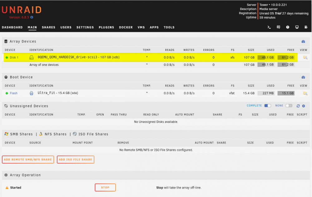

Yes, docker is enabled and i don't touch anything of the settings...... I did not think about it..... Now I try to add more disks to see if it changes anything. Thanks and I'll update you soon!
[GUIDE] Installing UnRaid (ver. 6.83) on ProxMox (ver. 6.2-4)
In fact.....I fully agree with you.......I was asking someone who has already tried ProxMox (for example the author of the guide) to understand which setting on ProxMox I may be wrong.... .
Even at the beginning of this guide if you look at this image it looks the same thing, 100GB HDD and 46GB occupied..... The proportions look the same.....
No unfortunately.....it's a new virtual disk normally added via ProxMox when you create a normal vm. I tried to format it via unRAID both xfs and btrfs but nothing changes, I don't understand why....
Or if I added a 1TB HDD would it still "only" take up 21GB? I ask because I have never tried such small disks! 🙂 Thanks for your help!
Yes, i know but a new "empty" ( virtual for test ) 50 Gb HDD suffered 21 gb occupied, isn't it a bit too much? It's the 42% occupied, isn't it a bit too much? A real attached HDD has not so much GB occupied!
Hi, @jbat66, i'm trying unRAID VM on ProxMox. It's running fine and for test i'm using only 1 50Gb vdisk but i don't understand why now is empty ( fresh install ) and 20Gb are already occupied on this QEMU HARD DRIVE. Why? What's the reason? Is there a way to have all the 50Gb free as a real Hard Disk? Thanx in advance! Zippi
