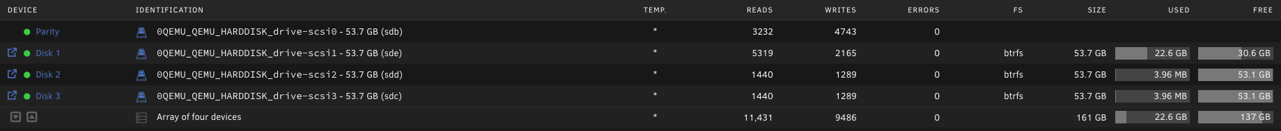

  22. Hi @jbat66, first of all thanks for your reply. As I was saying above I was just doing some tests like this to mess around with a RAID VM a bit. I'm not going to install vm in unRAID because it's obviously more "logical" to install them under ProxMox. Like you, for example, I wanted to try the applications under Docker but only out of curiosity. I already have a bare metal unRAID Server as my main server which is great for everything, I'm very happy with it! Having seen this thread and also having a ProxMox Server I wanted to give it a try as I told you out of curiosity. I just wanted to understand if there were wrong settings that I needed to fix or if @JonathanM's observation was right and apparently it does as the other 2 added HDDs have less occupied space. I obviously have no intention of using such small vHDDs! Thanks anyway for your contributions. I always have so many things to learn and experience!

  24. @JonathanM You are right! That's it! Having installed only 1 disk for the first time, what you described probably happened! I'm no expert and I'm doing some tests.... I then plugged in 2 more drives to try..... From the image that I have attached below, can you confirm that everything is OK? Just to make sure I haven't screwed up some other setting! Thank you so much!!!!!
