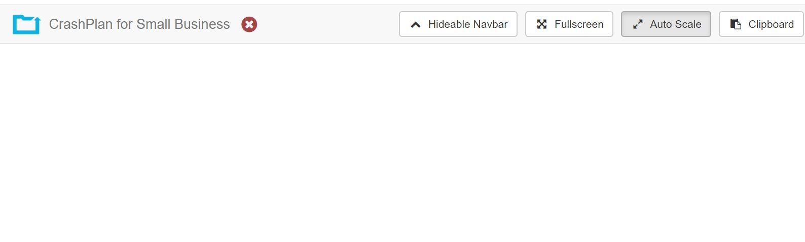

  6. Yes, there have been several reboots while trying to solve this issue. I also did verify that my Crashplan Pro account is in good standing. I normally use Chrome, but have also tried to open this in Firefox with no luck either. Attached is a pic of what I get, including the copy/paste sidebar.

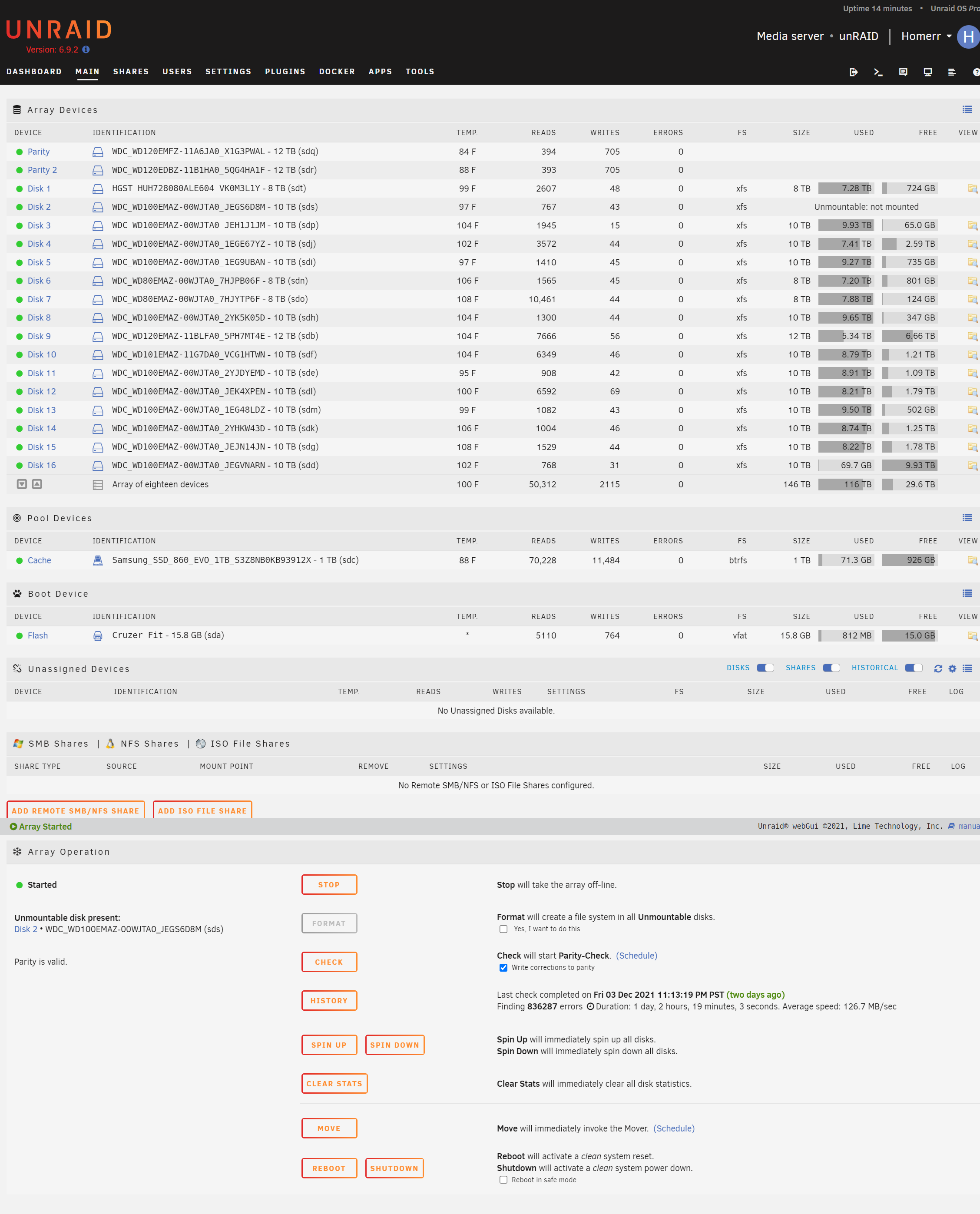

  15. Disk is XFS, I restarted in Maintenance mode and ran the check on the disk, result below. I'm at step 2 of Repairing a File System - "Add any additional parameters to the Options field required that are suggested from the check phase. If not sure then ask in the forum. The Help build into the GUI can provide guidance on what options might be applicable." Is it recommended to add any parameters? (Doing this via GUI, btw.) Step 4 notes a -L option. Phase 1 - find and verify superblock... Phase 2 - using internal log - zero log... ALERT: The filesystem has valuable metadata changes in a log which is being ignored because the -n option was used. Expect spurious inconsistencies which may be resolved by first mounting the filesystem to replay the log. - scan filesystem freespace and inode maps... block (7,74328029-74353290) multiply claimed by cnt space tree, state - 2 block (7,74169449-74170249) multiply claimed by cnt space tree, state - 2 block (7,74169449-74170249) multiply claimed by cnt space tree, state - 2 invalid start block 0 in record 51 of cnt btree block 7/2 invalid start block 0 in record 52 of cnt btree block 7/2 invalid start block 0 in record 53 of cnt btree block 7/2 invalid start block 0 in record 54 of cnt btree block 7/2 invalid start block 0 in record 55 of cnt btree block 7/2 invalid start block 0 in record 56 of cnt btree block 7/2 invalid start block 0 in record 57 of cnt btree block 7/2 invalid start block 0 in record 58 of cnt btree block 7/2 invalid start block 0 in record 59 of cnt btree block 7/2 agf_freeblks 207015525, counted 194421230 in ag 7 agi unlinked bucket 39 is 130200423 in ag 7 (inode=15162585959) sb_ifree 8809, counted 8862 sb_fdblocks 576670704, counted 604659013 - found root inode chunk Phase 3 - for each AG... - scan (but don't clear) agi unlinked lists... - process known inodes and perform inode discovery... - agno = 0 - agno = 1 - agno = 2 - agno = 3 - agno = 4 - agno = 5 - agno = 6 - agno = 7 data fork in ino 15040730579 claims free block 1953203817 data fork in ino 15162585949 claims free block 1953077194 - agno = 8 - agno = 9 - process newly discovered inodes... Phase 4 - check for duplicate blocks... - setting up duplicate extent list... - check for inodes claiming duplicate blocks... - agno = 0 - agno = 3 - agno = 6 - agno = 1 - agno = 7 - agno = 5 - agno = 4 - agno = 8 - agno = 9 - agno = 2 No modify flag set, skipping phase 5 Phase 6 - check inode connectivity... - traversing filesystem ... - traversal finished ... - moving disconnected inodes to lost+found ... disconnected inode 15162585959, would move to lost+found Phase 7 - verify link counts... would have reset inode 15162585959 nlinks from 0 to 1 No modify flag set, skipping filesystem flush and exiting.
  16. We had a power outage in our neighborhood Friday. I restarted the server that night and it ran a parity check which ended last night, it seemed everything was okay. I was then in the case late last night replacing a case fan (routine, not related to the power outage) and booted the server back up. It was late and I thought everything was okay initially. This morning I noticed that Disk 2 in unmountable. I did shutdown and reseat Disk 2's drive cage and unplug/plug the SATA cable that goes to it's backplane. I did not replace the cable as of yet. This drive is one of the 4 in my system connected to the motherboard via SATA, the others are on an LSI 9201-16i card. I do have a 12tb disk that I can use if needed and I have one spare port on the 16i setup. I did do some searching on this topic and there were serveral paths taken, I'm not sure exactly what I should do here. I don't really know the commands in Linux but can follow directions. Can anyone help me out here? unraid-diagnostics-20211205-0800.zip

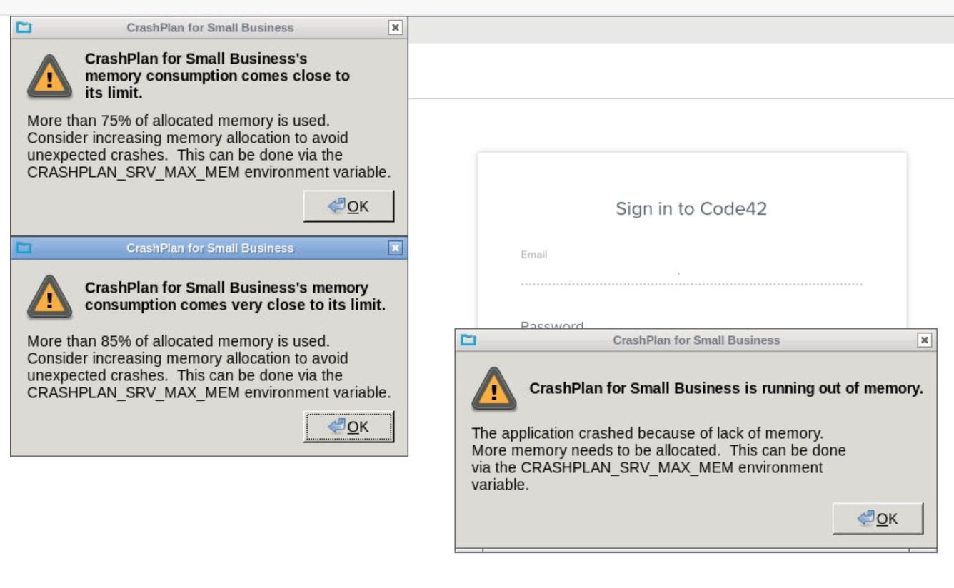

  21. I'm having similar issues to jasonmav and scud133b above with CRASHPLAN_SRV_MAX_MEM, see image below of pop-ups. I tried editing the docker settings for memory to 2048M and 4096M to no avail (I have 16gb ram fwiw). I only get the red X on the webui header now (second image is butted up under the first image with the 3 memory warning boxes). In doing the above I also broke the memory setting and I hope one of you can post a screenshot/fix. The last time I edited the docker memory settings I selected 'Remove' thinking it was to remove the value, not the actual tool. I see how to add back in the variable, I just need to see what the memory tool settings are.

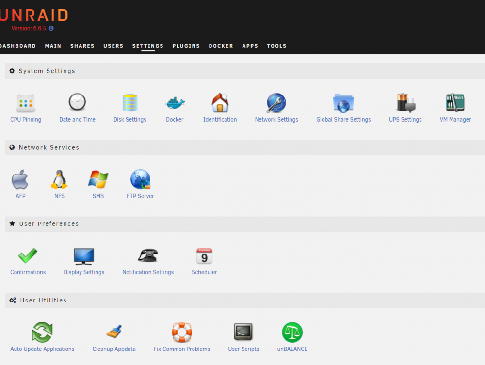

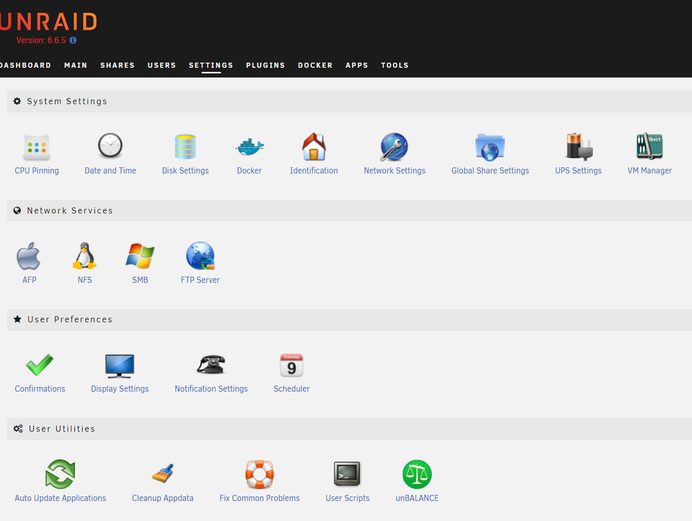

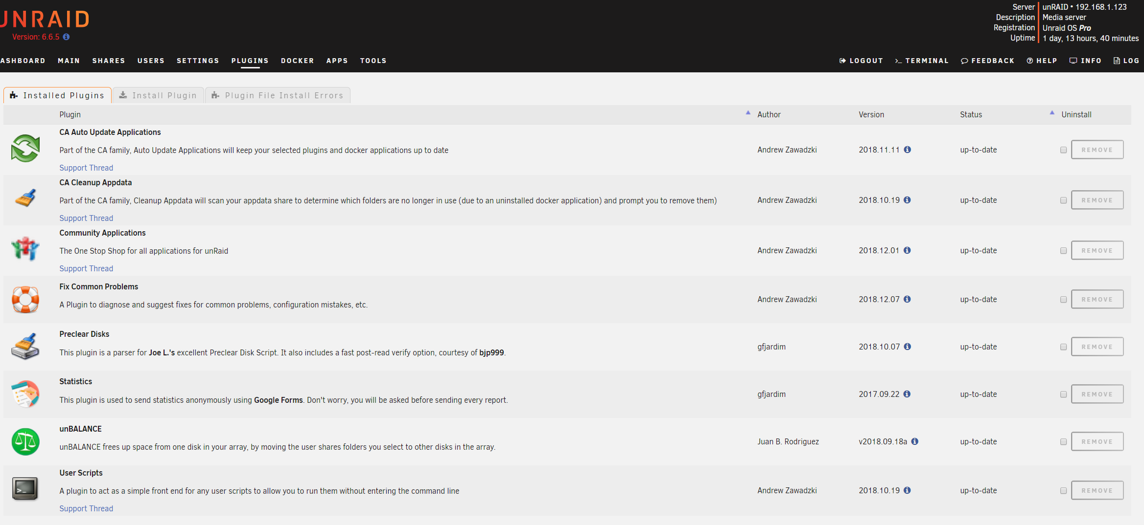

  23. Hmmm... I don't see that, but I have CA installed as seen on the Plugins tab.
  24. I'm watching Spaceinvader One's video on replacing a cache drive and he references Settings | Community Applications | Backup/Restore (linked below). I have CA installed but the CA section is absent on the Settings tab as he shows. Has CA been changed or updated and the Backup/Restore is located elsewhere? https://youtu.be/ij8AOEF1pTU?t=632
