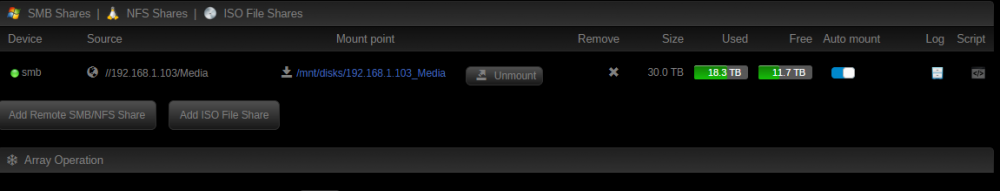

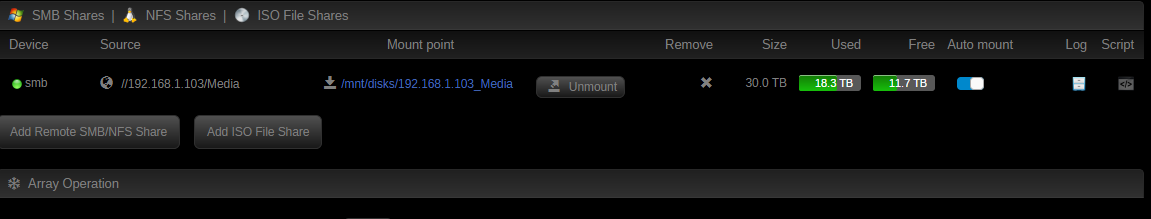

  14. As I was cycling through adding and removing the remote share at times it would show me a value under size. It was always 8.? GBs. During this period the share didn't actually mount. The used and free columns had no value.
  15. @dlandon and @itimpi Thanks for the quick reply guys. I appreciate your time. @dlandon I did notice it was not mounted but sometimes it showed me 8ish under the size. Which striked me as odd. @itimpi I hear what you're saying. I did attempt to browse, unsuccessfully, from the Linux kernel side before associating the mount point with the Krusdar docker. I just didn't want to accept the truth... Good News.. I just got it to mount!!! I bounced between the CIFS and NFS share for a while like a crazy person. "The definition of insanity" Then I had the great idea to leave the unmounted config and reboot. After reboot I saw the same thing but when I started the array the share mounted. YAY! Now I wonder what protocol would be best, NFS or CIFS ?
