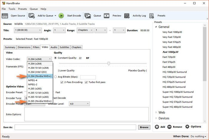

Just did a test, it shows handbrake process on the gpu for me in nvidia-smi Can you please triple check that you are using the nvidia codec, screenshot on the selection in a previous post.

You're missing something. If you have it all setup and you are using the nvenc codec, and the conversion worked, it used the GPU. nvenc codec only works with the gpu. Please keep in mind, every video transcode, including gpu transcode, has some CPU load. Lastly, the nvenc codec only does the encoding (think of nvenc as NV for nvidia and enc for encoding), the decoding is still 100% CPU based.

Common issue is not selecting the codec that is GPU accelerated.

That's correct. Although, decoding h.264 480p/720p isn't that CPU intensive. Make sure you're selecting the nvidia codec in Handbrake:
