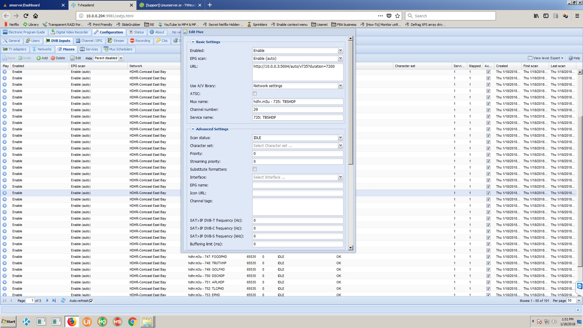

  9. I dont have the HDHomerun software on this pc to connnect directly to the HDHromerun. I can check from my other pc later if needed. I can play the channel through the play link in the mux tab through VLC so I know it is working though. The service link is bad, but the mux link is good. Is there a way to use the mux link instead? The logs says no assigned adapters. Is there a way to manually assign the adapter to the channel?

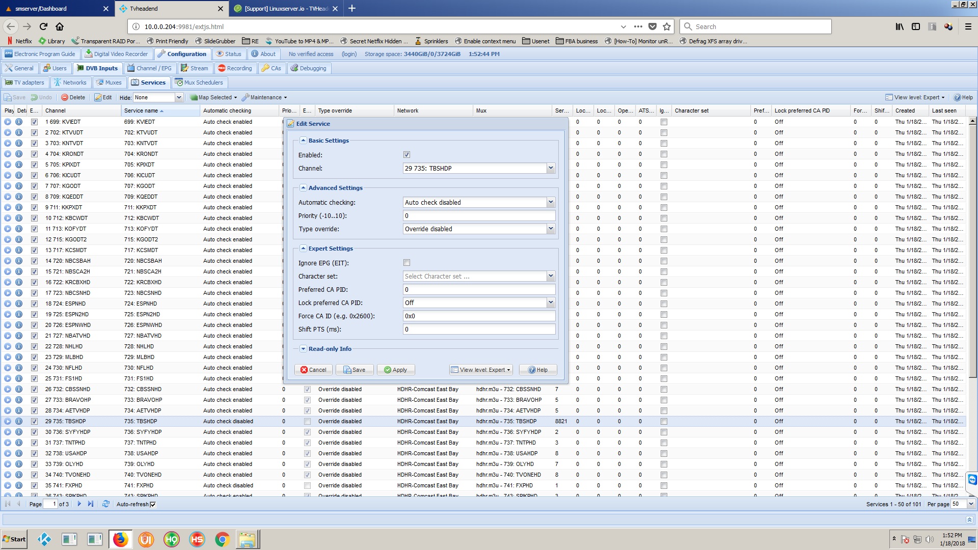

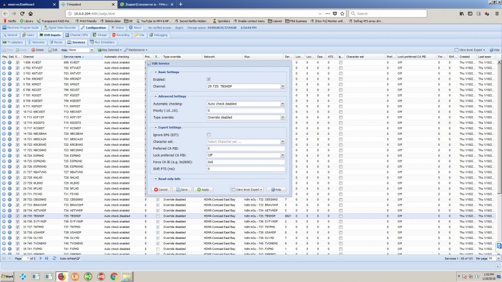

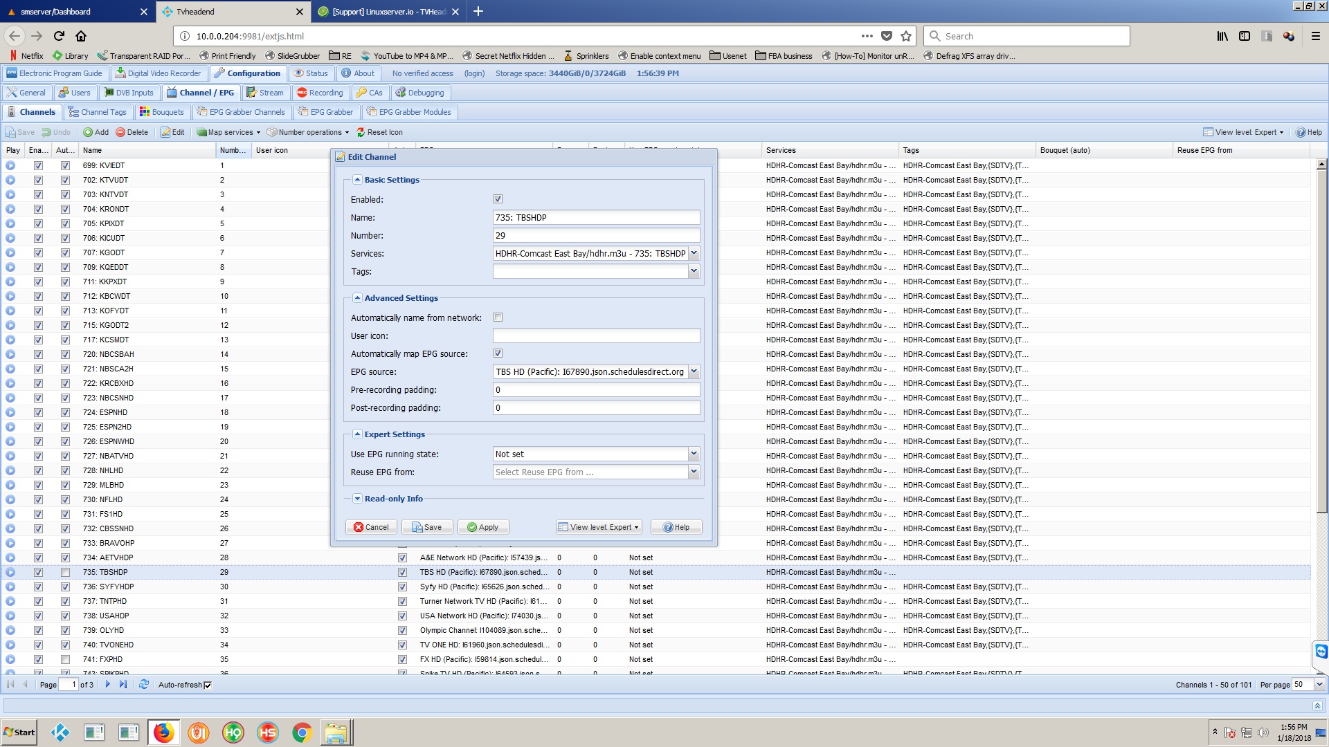

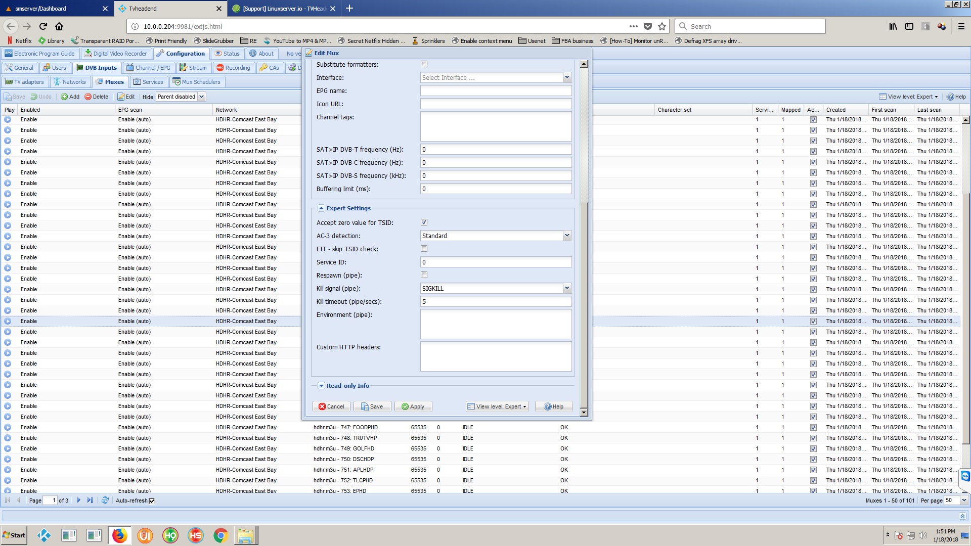

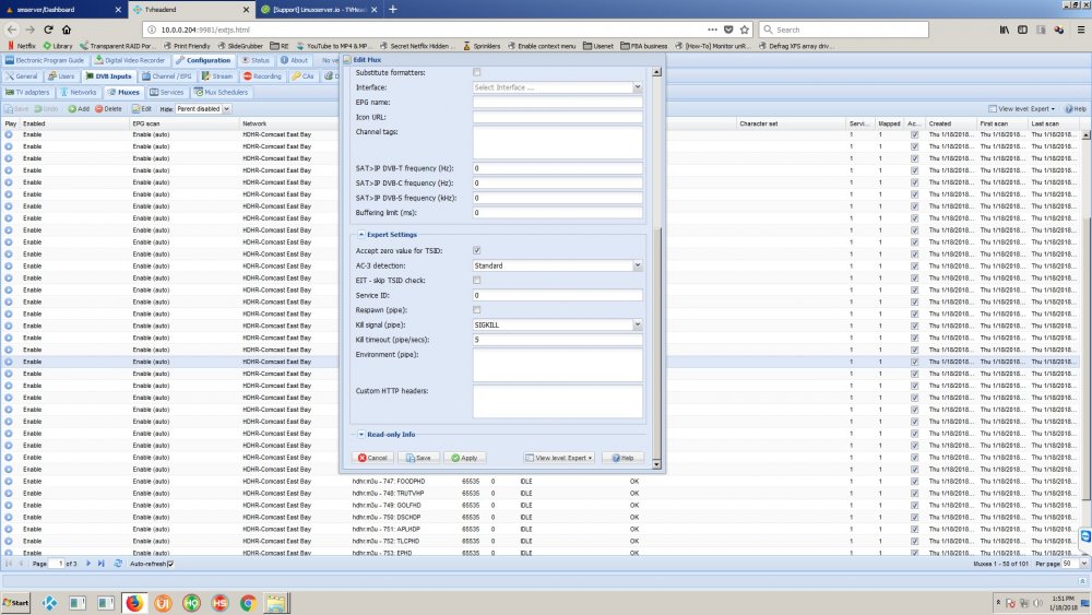

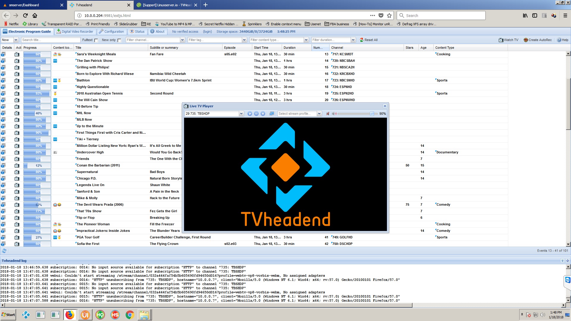

  10. Thanks for offering some help. Here are the screen shots you requested. I included one for the log window output too instead of typing it. On the services tab I did have to set hide to "none" since it says the parents are disabled. On the services tab it shows auto check disabled. I changed that in my attempts to get it working.
  11. I have gotten a HDHomerun Prime working with schedules direct EPG; for the most part. However, there are 9 channels that do not work. When I originally ran "map all" on the services they were ignored. I then manually added the channels based on some reading and set the service they connect to. The muxes pages shows them as mapped. I have been reading/trying to find out how to fix them and have discovered a few things that might give clues as to what the problem is. 1. If i play the link from the muxes tab in VLC they work. If I play the link in VLC from the services tab they do not. I do however see and active connection in the status tab when played through the services tab even though there is no output to VLC. 2. I also noticed that all of these channels do not have the "Encrypted" checkbox filled on the services tab, all the other channels do. The above leads me to believe that I can get them to work, but I cannot figure out how. Does anyone have any ideas? I am not sure what additional data/info you might need so let me know and I will get it as soon as possible.
