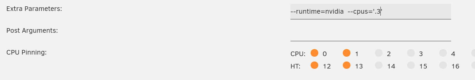

This is a separate issue. It is to be expected that a task like an FFMpeg encode would attempt to use all resources it has available to carry out the job. Audio encoding and remuxing is only being done on the CPU and your NVENC encoder will bot be used. For most people who use Unmanic, this is something that they want to have running in the background. Furthermore, it is the sort of thing that they are running in the background sharing resources with other processes. For these people (again, most people) it is HIGHLY recommended to limit resource use by your Unmanic Docker container. This is a screenshot of my config. Because I am using NVENC for hardware acceleration, I do not need the CPU to do much. I have pinned Unmanic to just a couple of cores and have then limited the use across those cores to 30% (--cpus='.3'). Even if you were not using hardware acceleration, you should be limiting the resources Unmanic can use in a similar way to this as otherwise it will affect your other processes on your server. There is currently no way to limit the workers resource use in Unmanic, and I am unsure if there will be any time soon. Therefore, Docker is the best way to run Unmanic and using the "--cpuset" ("CPU Pinning" in the Unraid templated) and "--cpus" to then limit it's resources.

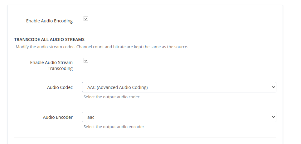

If you do not have "Enable Audio Stream Transcoding" checked, then whatever audio streams exist in the original file will be copied to the destination file with no changes made to it's codec. I personally do not have this checked as my playback devices can handle any codec fine (with the exception of the Chromecast). However, if you find that you have files in your library that are not playing well due to the audio, you may wish to enable this setting. Below it you will see a setting "Enable Audio Stream Cloning". This setting clones any surround sound audio streams (greater than 2 channels) and encodes that clone with only 2 channels according to the selected audio codec and bitrate. As an example that affects me personally, I had some videos that contained audio streams encoded with some kind of DD 7.1. My Chromecast could not play these and Plex would not transcode the audio when it tried (it would happily transcode the video, but not he audio). I didn't want to remove the surround sound streams from my files. My Chromecast (in the kitchen) only plays stereo anyway. So my solution was to add this setting to Unmanic that clones the audio stream (at the cost of an extra few MB per result file). On the Plex app I can then select the stereo channel when casting these videos to the kitchen Chromecast and the video files that were unable to play before now work perfectly fine. These settings are really dependant on your setup. You may have no issues with audio playback on any of your players. And in that circumstance I would recommend NOT selecting the "Enable Audio Encoding" checkbox at the top of that page at all. When that is not selected, then your audio streams are left completely untouched and are just "copied" into the new destination file.

Please note that with the last lot of changes, if you have "Enable Audio Stream Transcoding" enabled, Unmanic will transcode your files if the audio codec does not match what you have specified in the dropdown.
