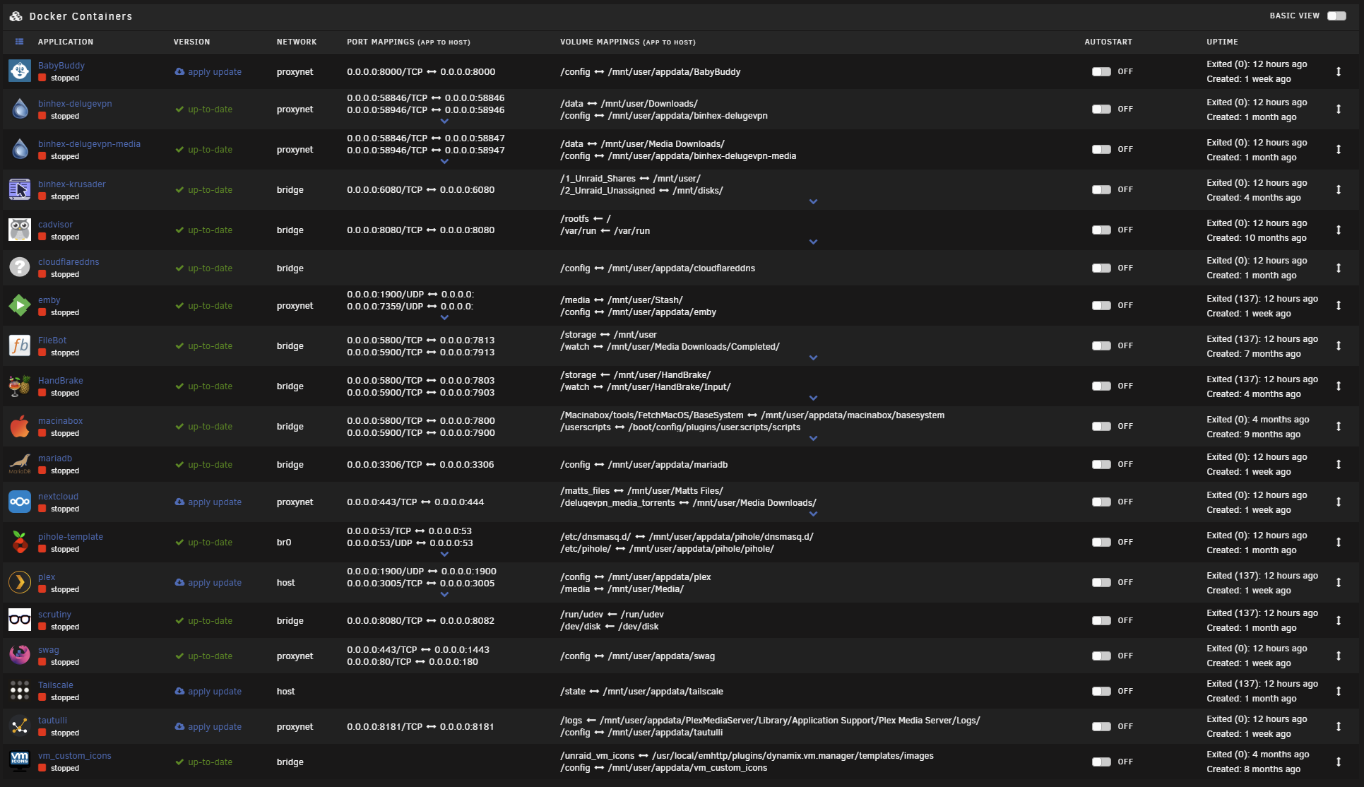

  1. @JorgeB Starting my server in safe mode and starting the array with all containers off, here are my current mappings. I don't see anything that is standing out as mis-mapped though? How can I drill down to the files taking up the space under rootfs to try and clear them out? Edit: I found that the ram from my other PC works with my server and I was able to bump up from 4 GB to 8 GB, allowing me to boot the server normally and start the array and plugins etc. How can I drill down to what's filled up my rootfs though to prevent it from growing as its sitting at 50% right now with 8 GB ram. root@JARVIS:~# df -h Filesystem Size Used Avail Use% Mounted on rootfs 3.7G 1.9G 1.9G 50% / tmpfs 32M 720K 32M 3% /run /dev/sda1 15G 1.1G 14G 7% /boot overlay 3.7G 1.9G 1.9G 50% /lib/firmware overlay 3.7G 1.9G 1.9G 50% /lib/modules devtmpfs 8.0M 0 8.0M 0% /dev tmpfs 3.8G 0 3.8G 0% /dev/shm cgroup_root 8.0M 0 8.0M 0% /sys/fs/cgroup tmpfs 128M 280K 128M 1% /var/log tmpfs 1.0M 0 1.0M 0% /mnt/disks tmpfs 1.0M 0 1.0M 0% /mnt/remotes tmpfs 1.0M 0 1.0M 0% /mnt/rootshare /dev/md1 7.3T 6.8T 561G 93% /mnt/disk1 /dev/md2 11T 8.3T 2.7T 77% /mnt/disk2 /dev/md3 7.3T 3.5T 3.8T 48% /mnt/disk3 /dev/sdg1 233G 77G 156G 33% /mnt/cache /dev/sdf1 112G 3.7M 111G 1% /mnt/download_cache shfs 26T 19T 7.0T 73% /mnt/user0 shfs 26T 19T 7.0T 73% /mnt/user /dev/loop2 30G 9.8G 19G 35% /var/lib/docker /dev/loop3 1.0G 4.3M 905M 1% /etc/libvirt tmpfs 772M 0 772M 0% /run/user/0 root@JARVIS:~#
