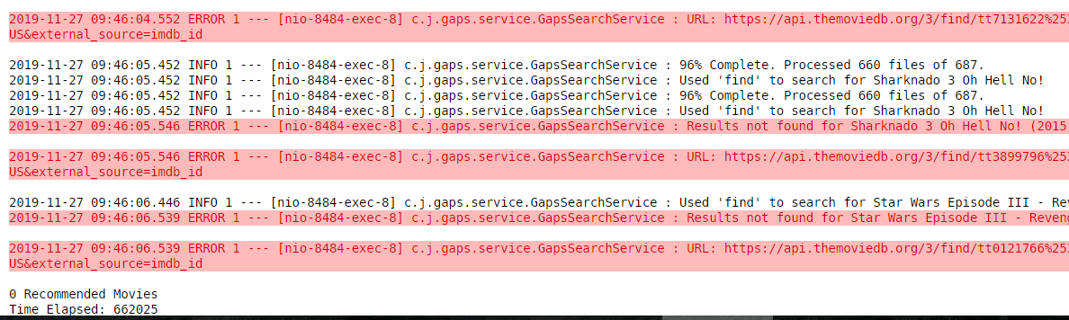

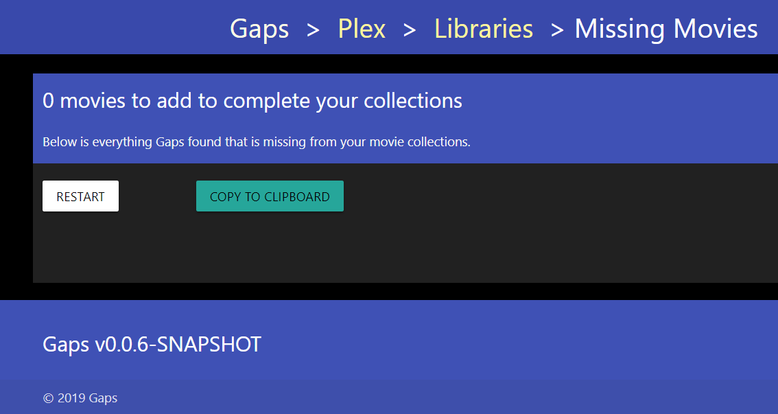

I will come back with the result of my test I started the scan of 687 movies accros 4 libraries
At the moment, log is full of "Result not fount"
I probably misconfigured something, because it not seems to work:
