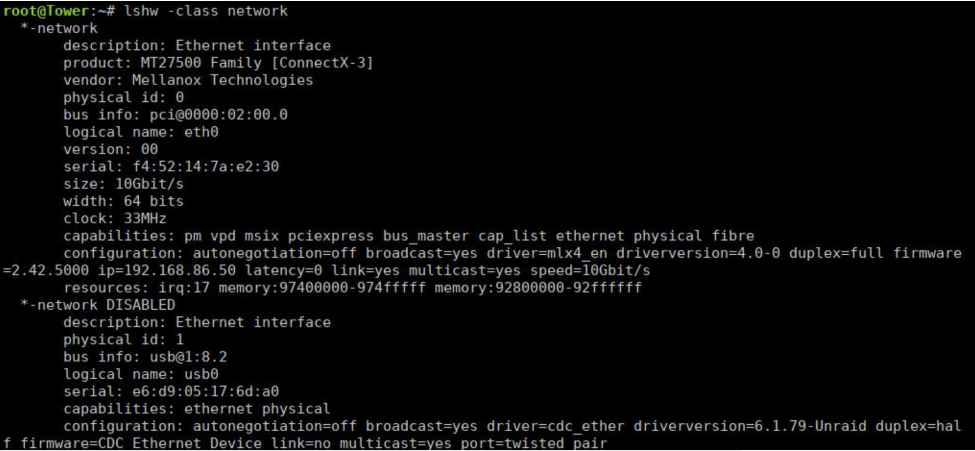

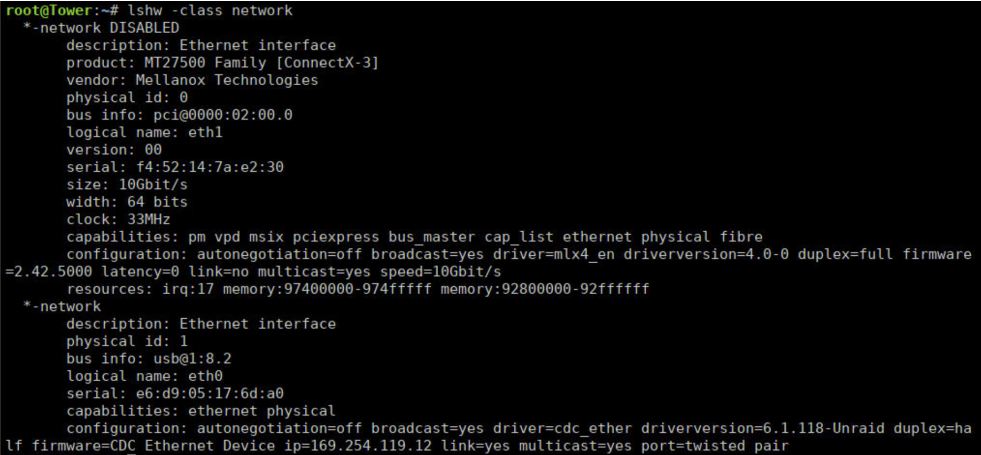

Coming from 6.12.13 - everything was working fine, but after upgrading to 6.12.14 I lost network. No hardware changes. My AsRockRack E3C246D4U motherboard has 2 onboard LAN ethernet NICs which are both disabled in BIOS. I have a Mellanox ConnectX-3 EN (MCX311A-XCAT) 10Gbe PCIe NIC installed (single port) which is what unraid should be using for network. However, in 6.12.14, Unraid has assigned eth0 to some USB NIC device I've never heard of called "CDC Ethernet Device" while it assigns my Mellanox NIC to eth1. (Screenshot from IPMI KVM below) In the previous OS version (6.12.13), the Mellanox 10Gbe NIC is automatically assigned to eth0 and the virtual USB NIC device is disabled: There is definitely no physical USB ethernet adapters connected to the server. Maybe this is a red herring, but my best guess is that this is a virtual device that is there for IPMI KVM redirection purposes?? I found a support thread from another user mentioning the same type of "cdc_ether" device and for them it ended up being related to their Dell iDRAC (Dell's IPMI implementation) "OS TO IDRAC PASS THROUGH" feature, which they disabled and that fixed their problem. I have looked all through the BMC Settings in the BIOS as well as in AsRockRack's HTML5 IPMI KVM tool and I can't find anything relating to USB NIC pass-through (there is pass-through settings but only for virtual floppy/optical/harddisk). There is no network-rules.cfg file in /boot/config and therefore no Interface Rules section in Network Settings in the GUI so I am unable to manually assign the Mellanox 10Gbe NIC to eth0. I tried to rename /boot/config/network.cfg and reboot, but this didn't fix it. In Network Settings, I tried to disable bonding and bridging on the eth0 USB NIC and reboot but that didn't work either. I also tried rebooting into Safe Mode to ensure it wasn't a plugin but the issue persists. I then rolled back to previous version and everything was working again. This is reproducable by rolling back and then updating again. I have attached Diagnostics. Appreciate any assistance! tower-diagnostics-20241209-1707 safe mode.zip

I decided to try going from 6.12.10 to 6.12.11 and was able to do so and get an IP automatically. Then I went from 6.12.11 to 6.12.13 and again was able to get an IP automatically. Then I went from 6.12.13 to 6.12.14 and have the same problem described in this thread. So the problem is definitely something with 6.12.14.

Appreciate the response/suggestion @JorgeB! I am not sure how to do that but I will look into it. I noticed in 6.10.12 the same cdc_ether device get registered to usb0: while in 6.10.14 it gets registered to eth0: Seems like something has changed with the kernel or drivers that results in the same device being recognized/registered differently in 6.10.12 vs 6.10.14. Does this seem like something that I should file a bug report for so that an official fix could maybe be implemented?

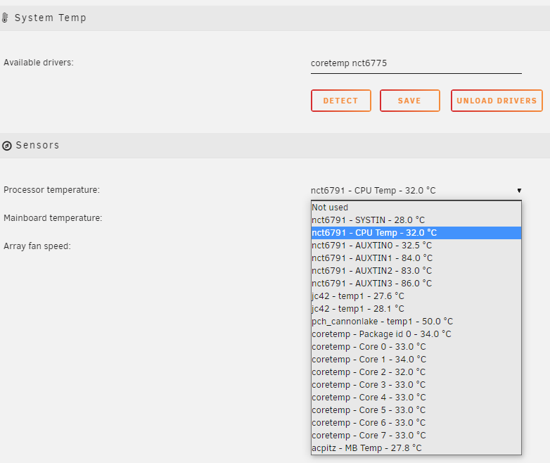

Think I figured out a workaround. So I tried running sensors-detect in terminal and the final output listed the name of the drivers associated with each adapter: Now follows a summary of the probes I have just done. Just press ENTER to continue: Driver `coretemp': * Chip `Intel digital thermal sensor' (confidence: 9) Driver `to-be-written': * ISA bus, address 0xca2 Chip `IPMI BMC KCS' (confidence: 8) Driver `jc42': * Bus `SMBus I801 adapter at efa0' Busdriver `i2c_i801', I2C address 0x18 Chip `IDT TSE2004' (confidence: 5) * Bus `SMBus I801 adapter at efa0' Busdriver `i2c_i801', I2C address 0x1a Chip `IDT TSE2004' (confidence: 5) Driver `nct6775': * ISA bus, address 0x290 Chip `Nuvoton NCT6791D Super IO Sensors' (confidence: 9) Note: there is no driver for IPMI BMC KCS yet. Check https://hwmon.wiki.kernel.org/device_support_status for updates. Do you want to generate /etc/sysconfig/lm_sensors? (yes/NO): yes Copy prog/init/lm_sensors.init to /etc/init.d/lm_sensors for initialization at boot time. You should now start the lm_sensors service to load the required kernel modules. Unloading i2c-dev... OK Then I went into the plugin and in the 'Available drivers' field I typed 'jc42' > save > load drivers. This gave me 2 new sensors that weren't showing before and all my existing sensors remained. Then I tried 'coretemp' > save > load drivers. This gave me all of the coretemp sensors that I was missing. This is what I see now:

Yes I tried unloading and reloading and even uninstalling the plugin and re-installing, same results every time.

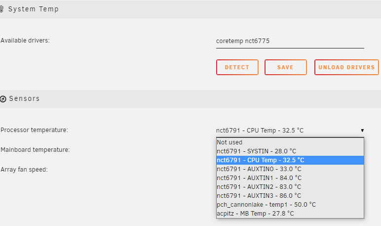

So I don't have the same sensors available...any idea why? E3C246D4U BIOS L2.34 BMC 1.80.00 ME Firmware Version 5.1.4.208 UNRAID 6.9.2 Dynamix System Temp Plugin v2020.06.20 I clicked detect > it sees 'coretemp nct6775' > save > load drivers > and I only see these options:
