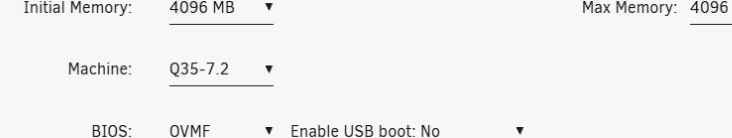

  2. Gday Johnnyc, Can you please share your VM settings from the Initial Memory section and below? I'm having dramas setting up a VM also.

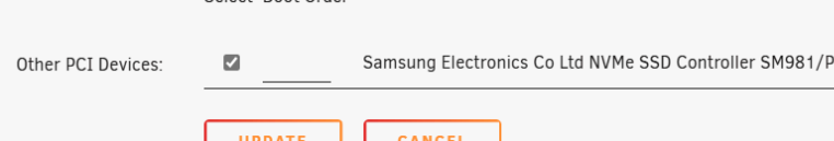

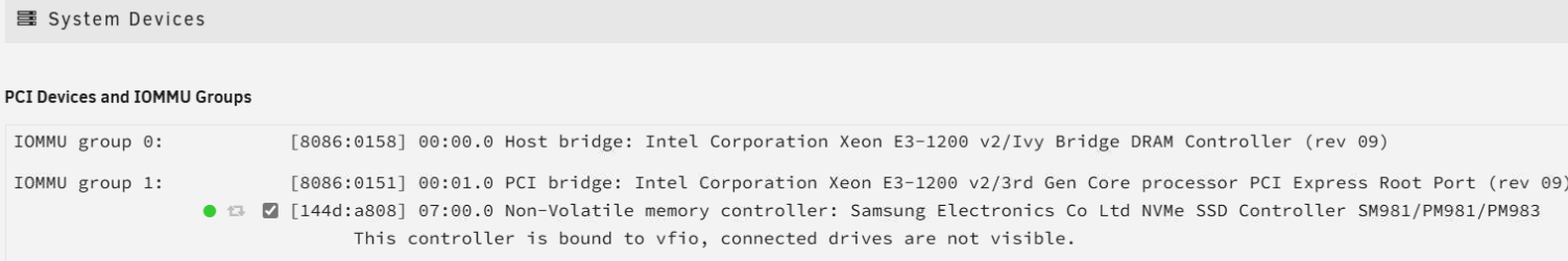

  5. Gday All, Im getting erreor "qemu-system-x86_64: -device {"driver":"vfio-pci","host":"0000:07:00.0","id":"hostdev0","bus":"pci.4","addr":"0x0"}: vfio 0000:07:00.0: failed to setup container for group 1: Failed to set group container: Operation not permitted" Ive checked through some other posts here on the forum, ive set the PCIE NVME drive to have the check box in IOMMU group 1. Then Bind to VFIO at boot and rebooted my Unraid. In the VM template, i have Q35-7.2 set for "Machine". The VM just won't start. Keep erroring as at start of post. Down in the "Other PCI Devices" section i have a tick box enabled for the Samsung SSD SM981/PM981/PM983 NVme device. any other logs / advice.... ? Cheers Guys, Mark.
