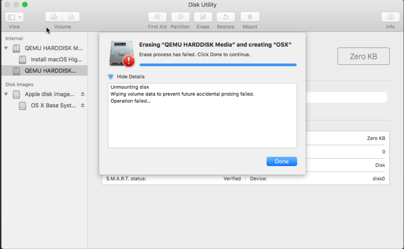

**VIDEO GUIDE** How to Install MacOS Mojave or High Sierra as a VM
spxlabs replied to SpaceInvaderOne's topic in VMs
Got everything working up until the part where I need to format my vdisk with Disk Utility, I get an error everytime I try to format the disk. the vdisk I created is set to SATA like you explicitly say. Not sure how to proceed. I have tried formatting the disk with several of the available options, all fail, with the same error. -
