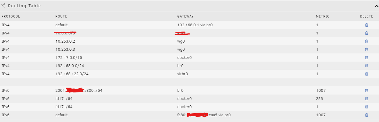

  2. It is normal that your local DNS is listed in there, so no need to change that. You are running it in Bridge mode, which is correct, which I can see from the log Looking extensively at your log, I don't see anything different compared to mine. Kinda out of ideas, only I could suggest now is to restart your Unraid and check your Docker and Network settings. In Unraid, can you check if Settings -> Docker (show advanced view) -> IPv4/6 custom network info makes sense. For comparison mine: IPv4 custom network on interface br0: Subnet: 192.168.0.0/24 Gateway: 192.168.0.1 IPv6 custom network on interface br0: Subnet: 2001::a300::/64 Gateway: fe80::eaa5 For all DHCP pool: not set And also, check you Settings -> Network Settings Here is my routing table for comparison:
