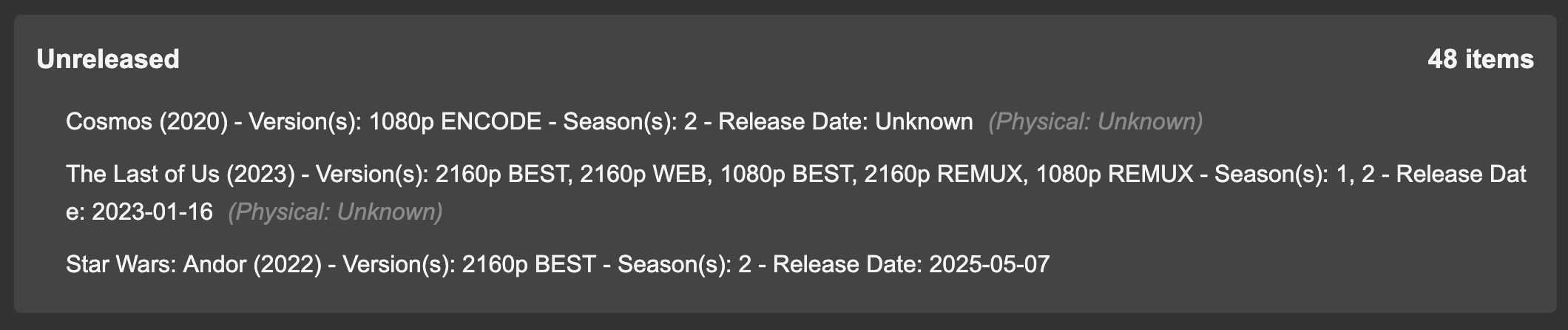

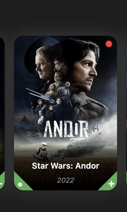

  3. Anyone a clue why Andor is showing with blacklsited icon (red dot) and won't download? It's not in my blacklist... It's also showing up in the unreleased section on cli_debrid

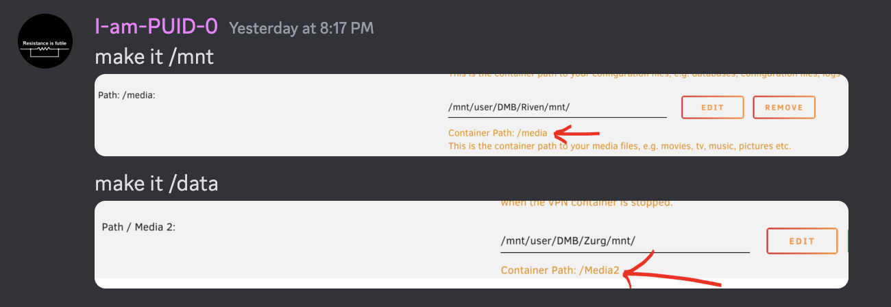

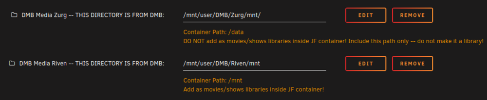

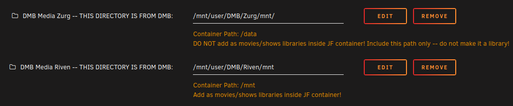

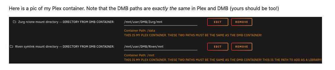

  6. Happy to point out what confused me if it's helpful. this image has the /data. and /mnt container paths in, but I read the instructions as making sure the variable paths were identical (so the /mnt/ser/DMB/Zurg or Riven/mnt ones), and missed that I had to edit the plex container path (and add a new one as plex only gives one initially). The other bit is outside your guide I think, when linked to the Riven guide from the developer it shoes different paths like this: So I changed my paths to match it! Woops. I ended up going through the filtering options individually and it works nicely. Just couldn't get the predefined "best" one to do anything. Trakt also ended up working, a bit too well! I was expecting it to provide a list of shows to then REquest in Riven, but it dumped the whole lot in my plex library. Started it again and will be careful what lists I add. Seems to be going pretty well now after the last few updates.
  7. Thanks for the extensive reply, really appreciate it. I started it all again and didn't mess with any settings (was confused as the linked guide had images that didn't match my Riven's defaults), and it's working now. I also seemingly had to change the contrainer path names in Plex from /media to /mnt, something not mentioned in any guides but the guys on Discord told me about: I thought I was having issues with symlinks not being created, but you just can't see them in unraid's file manager! they eventually got picked up by plex. I'm pursuing this as I have endless audio sync issues on Firesticks, I've moved things to apple TV and main streaming platforms are much better. Plex still has issues but now I'm using infuse I think that will be better too. I'm looking at the torrent ranking now, the instructions talk about easy switching between two preset profiles, default and best. Seemingly saying I just change the name to Best in settings.json and the rest of the settings would adjust, but I must be misunderstanding that as they've all remained the same. Unless that's all I needed to do to get 4K and it ignores the resolutions section and the other "default" settings? "ranking": { "profile": "best", "require": [], "exclude": [], "preferred": [], "resolutions": { "2160p": false, "1080p": true, "720p": false, "480p": false, "360p": false, "unknown": true Or do I need to comb through it and change everything else individually? I think this platform is very promising!

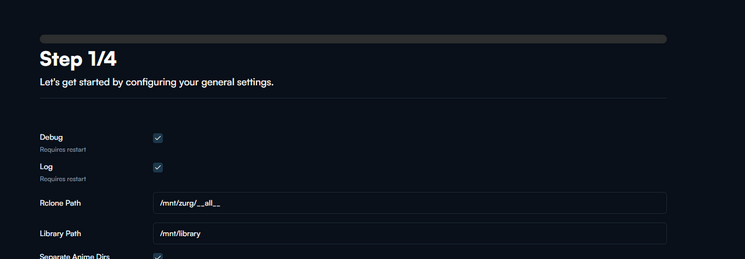

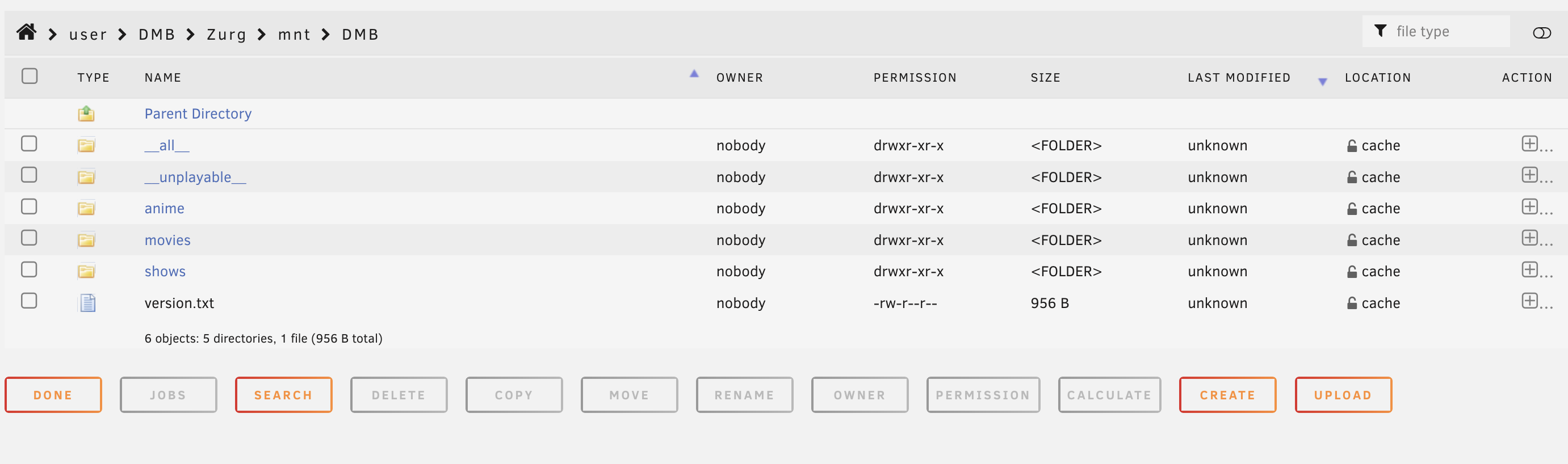

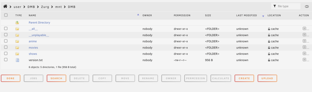

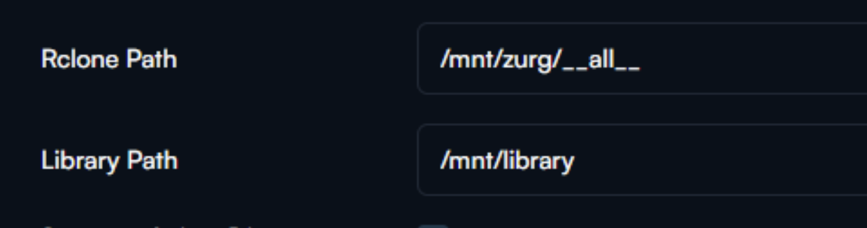

  9. Glad I found this, I was about to follow the guides for plex_debrid etc without realising it wasn't being developed anymore. I have a few questions.. I've been following the guide in the link on the docker: https://github.com/Unlearned6688/unraid-templates/blob/main/template-readmes/dmb-readme.md My folders ended up like this: Initially I added the Zurg folder to plex config as it had things in (from my RD account? not sure, but they worked and streamed from RD) , but looks like I need to add the Riven/mnt ones instead. These are empty. I only have space for one directory in my plex config, but the guide shows using the Zurg and Riven folders here: Not sure what to do about that. Next part where I come unstuck is in Riven setup. What do I put in the rclone and library paths? Leave it as is in the Riven guide? this config fails to initialise. Further to that, I am now unable to load Riven, 500 server error. Didn't change anything as far as I know, but these are the logs when I boot it up: Oct 28, 2024 14:48:18 - INFO - Zilean subprocess: | "Zilean.DmmScraper.Features.Dmm.DmmScraping" | Processed "fbf00af9-cdec-42a9-9927-d8deb6eb4985.html" with 36095 torrents Oct 28, 2024 14:48:18 - INFO - Zilean subprocess: Processing DMM Hashlists: 99% Oct 28, 2024 14:48:18 - INFO - Zilean subprocess: | "Zilean.DmmScraper.Features.Dmm.DmmScraping" | All files processed Oct 28, 2024 14:48:19 - INFO - Zilean subprocess: | "Zilean.DmmScraper.Features.PythonSupport.ParseTorrentNameService" | RTN: Parsing 726241 torrents Oct 28, 2024 14:48:23 - INFO - Attempt 9/10 to fetch settings from http://127.0.0.1:8080/settings/get/all Oct 28, 2024 14:48:23 - ERROR - Error fetching settings: HTTPConnectionPool(host='127.0.0.1', port=8080): Max retries exceeded with url: /settings/get/all (Caused by NewConnectionError('<urllib3.connection.HTTPConnection object at 0x153103c06e10>: Failed to establish a new connection: [Errno 111] Connection refused')) Oct 28, 2024 14:48:23 - INFO - Retrying in 5 seconds... (9/10) Oct 28, 2024 14:48:28 - INFO - Attempt 10/10 to fetch settings from http://127.0.0.1:8080/settings/get/all Oct 28, 2024 14:48:28 - ERROR - Error fetching settings: HTTPConnectionPool(host='127.0.0.1', port=8080): Max retries exceeded with url: /settings/get/all (Caused by NewConnectionError('<urllib3.connection.HTTPConnection object at 0x153103c0ce90>: Failed to establish a new connection: [Errno 111] Connection refused')) Oct 28, 2024 14:48:28 - ERROR - Max retries reached. Failed to fetch settings from http://127.0.0.1:8080/settings/get/all Oct 28, 2024 14:48:28 - ERROR - Failed to load settings: Max retries reached Oct 28, 2024 14:48:28 - INFO - Configuring riven_frontend Oct 28, 2024 14:48:28 - INFO - riven_frontend current version: v0.16.3 Oct 28, 2024 14:48:28 - INFO - Automatic updates set to 24 hours for riven_frontend Oct 28, 2024 14:48:28 - INFO - Checking for available riven_frontend updates Oct 28, 2024 14:48:28 - INFO - Currently installed [v0.16.3] for riven_frontend Oct 28, 2024 14:48:28 - INFO - Latest available version [v0.16.3] for riven_frontend Oct 28, 2024 14:48:28 - INFO - Automatic update not required for riven_frontend Oct 28, 2024 14:48:28 - INFO - Starting riven_frontend process Oct 28, 2024 14:48:28 - INFO - riven_frontend process started with PID: 173 Oct 28, 2024 14:48:28 - INFO - riven_frontend subprocess: Listening on 0.0.0.0:3000 Oct 28, 2024 14:48:31 - ERROR - The Riven backend process is not running. Oct 28, 2024 14:49:31 - ERROR - The Riven backend process is not running. Oct 28, 2024 14:50:32 - ERROR - The Riven backend process is not running. Oct 28, 2024 14:51:32 - ERROR - The Riven backend process is not running. Oct 28, 2024 14:52:32 - ERROR - The Riven backend process is not running. Oct 28, 2024 14:53:32 - ERROR - The Riven backend process is not running. Oct 28, 2024 14:54:32 - ERROR - The Riven backend process is not running. Oct 28, 2024 14:55:33 - ERROR - The Riven backend process is not running. Oct 28, 2024 14:56:33 - ERROR - The Riven backend process is not running. Oct 28, 2024 14:56:41 - INFO - riven_frontend subprocess: TypeError: fetch failed Oct 28, 2024 14:56:41 - INFO - riven_frontend subprocess: at node:internal/deps/undici/undici:12500:13 Oct 28, 2024 14:56:41 - INFO - riven_frontend subprocess: at process.processTicksAndRejections (node:internal/process/task_queues:95:5) Oct 28, 2024 14:56:41 - INFO - riven_frontend subprocess: at async s (file:///riven/frontend/node_modules/.pnpm/@[email protected]/node_modules/@hey-api/client-fetch/dist/index.js:1:5004) Oct 28, 2024 14:56:41 - INFO - riven_frontend subprocess: at async onboarding (file:///riven/frontend/build/server/chunks/hooks.server-BJJXyftd.js:44:39) Oct 28, 2024 14:56:41 - INFO - riven_frontend subprocess: at async respond (file:///riven/frontend/build/server/index.js:3405:22) Oct 28, 2024 14:56:41 - INFO - riven_frontend subprocess: at async Array.ssr (file:///riven/frontend/build/handler.js:1270:3) { Oct 28, 2024 14:56:41 - INFO - riven_frontend subprocess: [cause]: Error: connect ECONNREFUSED 127.0.0.1:8080 Oct 28, 2024 14:56:41 - INFO - riven_frontend subprocess: at TCPConnectWrap.afterConnect [as oncomplete] (node:net:1605:16) { Oct 28, 2024 14:56:41 - INFO - riven_frontend subprocess: errno: -111, Oct 28, 2024 14:56:41 - INFO - riven_frontend subprocess: code: 'ECONNREFUSED', Oct 28, 2024 14:56:41 - INFO - riven_frontend subprocess: syscall: 'connect', Oct 28, 2024 14:56:41 - INFO - riven_frontend subprocess: address: '127.0.0.1', Oct 28, 2024 14:56:41 - INFO - riven_frontend subprocess: port: 8080 Oct 28, 2024 14:56:41 - INFO - riven_frontend subprocess: } Oct 28, 2024 14:56:41 - INFO - riven_frontend subprocess: } Oct 28, 2024 14:57:33 - ERROR - The Riven backend process is not running. Oct 28, 2024 14:58:33 - ERROR - The Riven backend process is not running. Any help much appreciated, sorry if this is super obvious.
