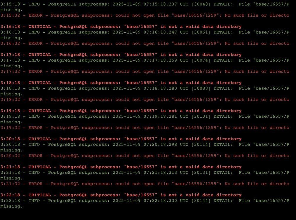

Hi I am running DMB, but it won't start - the logs indicate it fails trying to get the latest zurg-testing - I don't know why it wouldn't be ables to access GitHub, and I have followed setup instruction. Any help would be welcomed.
onError("<urllib3.connection.HTTPSConnection object at 0x147be85e5d90>: Failed to resolve 'api.github.com' ([Errno -3] Try again)"))
Oct 10, 2024 16:57:01 - ERROR - Failed to fetch https://api.github.com/repos/debridmediamanager/zurg-testing/releases/latest after 5 attempts.

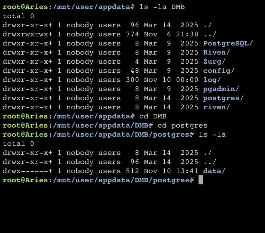

Many possibilities here.
1. First try this command to see the owner of your directories
ls -l /path/to/file
For example
ls -l /mnt/user/appdata/DMB
and
ls -l /mnt/user/DMB
In my case, which is just the default I also set the container to use. Config files in the /appdata directory. Mounts, symlinks, etc. in a directory I named DMB which could be on the array or a cache or whatever.
You should get something like this
total 0
drwxr-xr-x 1 nobody users   8 Oct  8 21:11 PostgreSQL/
drwxr-xr-x 1 nobody users   8 Oct  8 21:11 Riven/
drwxr-xr-x 1 nobody users   4 Oct  8 21:11 Zurg/
drwxr-xr-x 1 nobody users  26 Oct  8 21:11 config/
drwxr-xr-x 1 nobody users 116 Oct 10 13:14 log/
ls -l /mnt/user/DMB
total 0
drwxr-xr-x 1 nobody users  6 Oct  8 21:11 Riven/
drwxr-xr-x 1 nobody users  6 Oct  8 21:11 Zurg/
drwxr-xr-x 1 nobody users 18 Oct 10 16:40 transcoder-temp/
drwxr-xr-x 1 nobody users  8 Sep 23 17:47 zilean/
The key thing being the user should be "nobody" and the group "users" for all of the directories.
2. If the owner:group is correct, it's possible GitHub and/or your connection and/or a connection between you and GitHub was having issues earlier.
Try manually restarting DMB and then check the log .txt file for the error.
3. If that doesn't work, try this command in unRAID terminal
curl https://api.github.com/repos/debridmediamanager/zurg-testing/releases/latest
It should give a huge pile of text/URLs as a reply and not any sort of connection errors. The text will contain all the links to the zurg releases. (This command isn't downloading or changing anything, btw, it's just so you can see what your server can see). If there's a connection error you'll just have to troubleshoot that. Something like DNS filter might be catching the API request. Try running the curl command in your router's terminal if you have access and can. Try it on other computers. I can tell you that the URL works for me at the moment.
If you're still having issues, take a screenshot of your DMB template filled-in (redact any API keys or anything sensitive). If the container is just straight up not starting (red square) then post the docker run output. And post the logs for the latest run. Thanks.

Hi @UnJustice,
I hope you're doing well. I'm running DMB 5.3.0 on Unraid using the Docker container and I've been experiencing an issue where zombie dotnet processes accumulate over time. This seems to make the Zurg and Riven folders completely unusable until I restart the DMB container. After restarting DMB, I also need to restart Plex, Emby, or Jellyfin to get everything working again, which makes this issue quite disruptive.
Based on what I've observed, I suspect the issue might be tied to the Riven process, as it manages the symlinks and backend data that interact with these folders. I've tried this on two separate Unraid servers, and both exhibit the same behavior.

Oct 28, 2024 14:48:18 - INFO - Zilean subprocess:  | "Zilean.DmmScraper.Features.Dmm.DmmScraping" | Processed "fbf00af9-cdec-42a9-9927-d8deb6eb4985.html" with 36095 torrents
Oct 28, 2024 14:48:18 - INFO - Zilean subprocess: Processing DMM Hashlists: 99%
Oct 28, 2024 14:48:18 - INFO - Zilean subprocess:  | "Zilean.DmmScraper.Features.Dmm.DmmScraping" | All files processed
Oct 28, 2024 14:48:19 - INFO - Zilean subprocess:  | "Zilean.DmmScraper.Features.PythonSupport.ParseTorrentNameService" | RTN: Parsing 726241 torrents
Oct 28, 2024 14:48:23 - INFO - Attempt 9/10 to fetch settings from http://127.0.0.1:8080/settings/get/all
Oct 28, 2024 14:48:23 - ERROR - Error fetching settings: HTTPConnectionPool(host='127.0.0.1', port=8080): Max retries exceeded with url: /settings/get/all (Caused by NewConnectionError('<urllib3.connection.HTTPConnection object at 0x153103c06e10>: Failed to establish a new connection: [Errno 111] Connection refused'))
Oct 28, 2024 14:48:23 - INFO - Retrying in 5 seconds... (9/10)
Oct 28, 2024 14:48:28 - INFO - Attempt 10/10 to fetch settings from http://127.0.0.1:8080/settings/get/all
Oct 28, 2024 14:48:28 - ERROR - Error fetching settings: HTTPConnectionPool(host='127.0.0.1', port=8080): Max retries exceeded with url: /settings/get/all (Caused by NewConnectionError('<urllib3.connection.HTTPConnection object at 0x153103c0ce90>: Failed to establish a new connection: [Errno 111] Connection refused'))
Oct 28, 2024 14:48:28 - ERROR - Max retries reached. Failed to fetch settings from http://127.0.0.1:8080/settings/get/all
Oct 28, 2024 14:48:28 - ERROR - Failed to load settings: Max retries reached

Oct 28, 2024 14:48:31 - ERROR - The Riven backend process is not running.
Oct 28, 2024 14:49:31 - ERROR - The Riven backend process is not running.
Oct 28, 2024 14:50:32 - ERROR - The Riven backend process is not running.
Oct 28, 2024 14:51:32 - ERROR - The Riven backend process is not running.
Oct 28, 2024 14:52:32 - ERROR - The Riven backend process is not running.
Oct 28, 2024 14:53:32 - ERROR - The Riven backend process is not running.
Oct 28, 2024 14:54:32 - ERROR - The Riven backend process is not running.
Oct 28, 2024 14:55:33 - ERROR - The Riven backend process is not running.
Oct 28, 2024 14:56:33 - ERROR - The Riven backend process is not running.
Oct 28, 2024 14:56:41 - INFO - riven_frontend subprocess: TypeError: fetch failed
Oct 28, 2024 14:56:41 - INFO - riven_frontend subprocess: at node:internal/deps/undici/undici:12500:13
Oct 28, 2024 14:56:41 - INFO - riven_frontend subprocess: at process.processTicksAndRejections (node:internal/process/task_queues:95:5)
Oct 28, 2024 14:56:41 - INFO - riven_frontend subprocess: at async s (file:///riven/frontend/node_modules/.pnpm/@[email protected]/node_modules/@hey-api/client-fetch/dist/index.js:1:5004)
Oct 28, 2024 14:56:41 - INFO - riven_frontend subprocess: at async onboarding (file:///riven/frontend/build/server/chunks/hooks.server-BJJXyftd.js:44:39)
Oct 28, 2024 14:56:41 - INFO - riven_frontend subprocess: at async respond (file:///riven/frontend/build/server/index.js:3405:22)
Oct 28, 2024 14:56:41 - INFO - riven_frontend subprocess: at async Array.ssr (file:///riven/frontend/build/handler.js:1270:3) {
Oct 28, 2024 14:56:41 - INFO - riven_frontend subprocess: [cause]: Error: connect ECONNREFUSED 127.0.0.1:8080
Oct 28, 2024 14:56:41 - INFO - riven_frontend subprocess: at TCPConnectWrap.afterConnect [as oncomplete] (node:net:1605:16) {
Oct 28, 2024 14:56:41 - INFO - riven_frontend subprocess: errno: -111,
Oct 28, 2024 14:56:41 - INFO - riven_frontend subprocess: code: 'ECONNREFUSED',
Oct 28, 2024 14:56:41 - INFO - riven_frontend subprocess: syscall: 'connect',
Oct 28, 2024 14:56:41 - INFO - riven_frontend subprocess: address: '127.0.0.1',
Oct 28, 2024 14:56:41 - INFO - riven_frontend subprocess: port: 8080
Oct 28, 2024 14:56:41 - INFO - riven_frontend subprocess: }
Oct 28, 2024 14:57:33 - ERROR - The Riven backend process is not running.
Oct 28, 2024 14:58:33 - ERROR - The Riven backend process is not running.
Any help much appreciated, sorry if this is super obvious.
