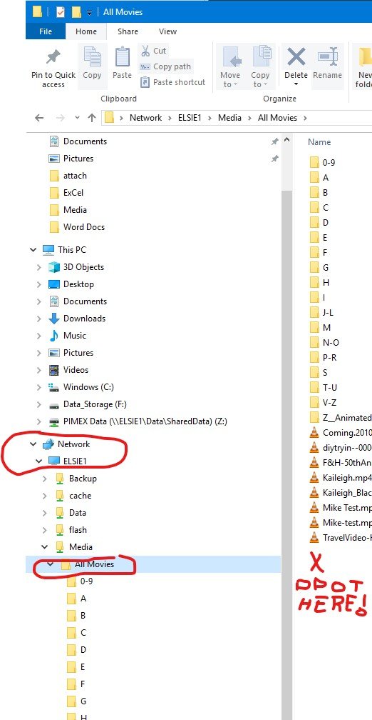

First, try using the Windows Explorer to as the destination window that you drag-and-drop the file into:
If that does not work.  MS is trying to add more and more security to SMB usage in Windows.  Here is a thread to read.  Start on page three as it contains the most recent stuff that MS is doing to the default settings.
