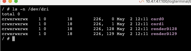

  9. Also tried this in the docker console / # vainfo Trying display: drm libva info: VA-API version 1.22.0 libva info: Trying to open /lib/dri/iHD_drv_video.so libva info: Found init function __vaDriverInit_1_22 libva error: /lib/dri/iHD_drv_video.so init failed libva info: va_openDriver() returns 18 vaInitialize failed with error code 18 (invalid parameter),exit / # Seems like it's iHD_drv_video.so that fails to initialize.
  10. Yes it's there. I tried the latest and beta branch. Also tried the other emby dockers. Could it be a problem directly in unraid or since the card is detected, it's a problem from emby?
