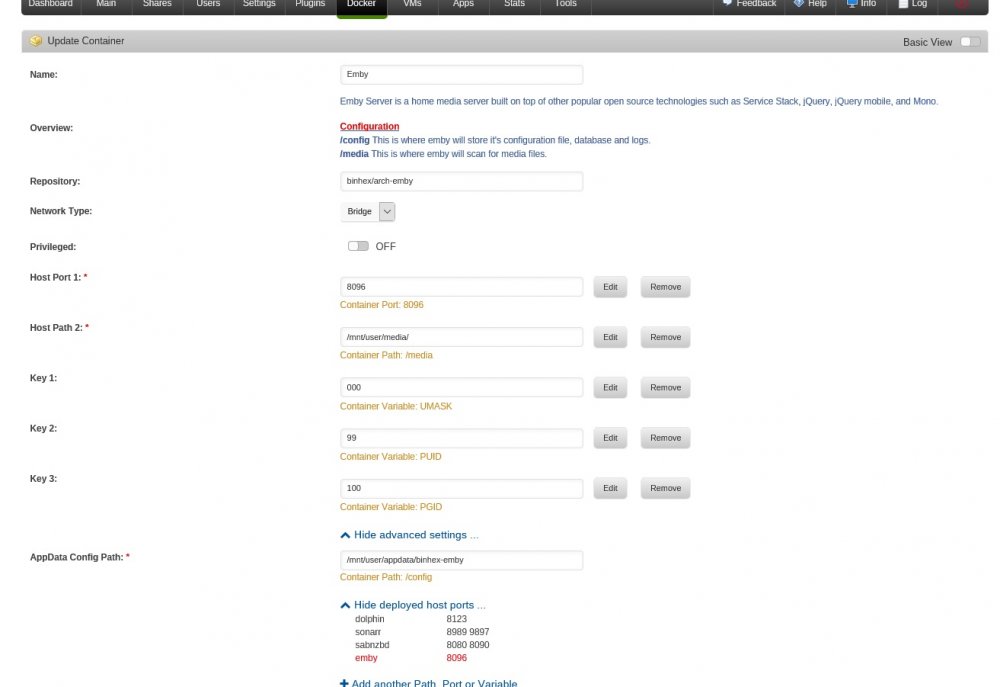

I have re installed emby due to my appdata getting deleted.
I have reinstalled and am having some problems i have not had before. I was hoping anyone with experience with emby could help me incase it is something simple.
I use a laptop and an nvidea shield tv to access emby server on local network. Laptop is wireless shield is wired.
Playback on the laptop through the emby web interface is perfect.
edit....... same is happening on laptop as below but get error playing video message after about 10 seconds
However on the shield its a different story.
1. When emby is transcoding to the shield the quality is terrible. The video will play for 10 seconds then loop back to the point video playback started.
Transcoding used to be fine. My server has a 14 core cpu and 64 gigs of ram. The directory for transcoding is set to a folder on the ssd cache.
2. When playing a direct stream on the shield the video plays but will stop and artifact every 10 to 15 seconds then continue
I have tried playing the same files from kodi on shield from smb share and is perfect so it cant be network related.
this is how my docker is setup
My path substitution is
/media/TVShows
To
\\192.168.1.199\media\TVShows
Anyone got any ideas. Strange thing is it all worked fine until i reinstalled. All settings are the same unless there is something i have forgotten?
Not sure but maybe change Bridge to HOST??
Thanks yes i tried that and it made no difference.
i have since installed  emby server from Emby Repository and this docker works fine. no idea why binhexs didnt?

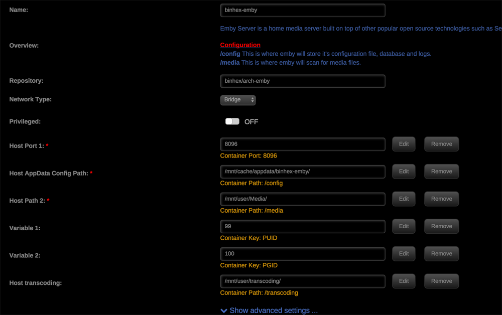

I am new to docker so bear with me.
I want to add binhex-emby through CA.
Once I click add, in the next page, what should i put in these field?
Host path 2:        mnt/user (default value)
                          Container path : /media (tips below)
Should I just use default value? Should I change the value to the tips below (/media)? What is the recommended value and why?
Thanks.

ok this is one of those key things you need to wrap your head around, have a read here for a start:-
http://lime-technology.com/forum/index.php?topic=40937.msg387520#msg387520
and also for my attempt to explain this:-
http://lime-technology.com/forum/index.php?topic=45811.msg437673#msg437673 (FAQ Q4.)

Thanks. Much appreciated.

I'm running a new install of Unraid (also new to Unraid in general) but am running into issues with this (and Sonarr/Radarr). I managed to get Sabnzbd up and running no problem.
Attached is my container settings. Also the log in case this helps. Basically when I click on the WebUI link I get a generic browser unable to connect message.
Hopefully you can point me in the right direction :)

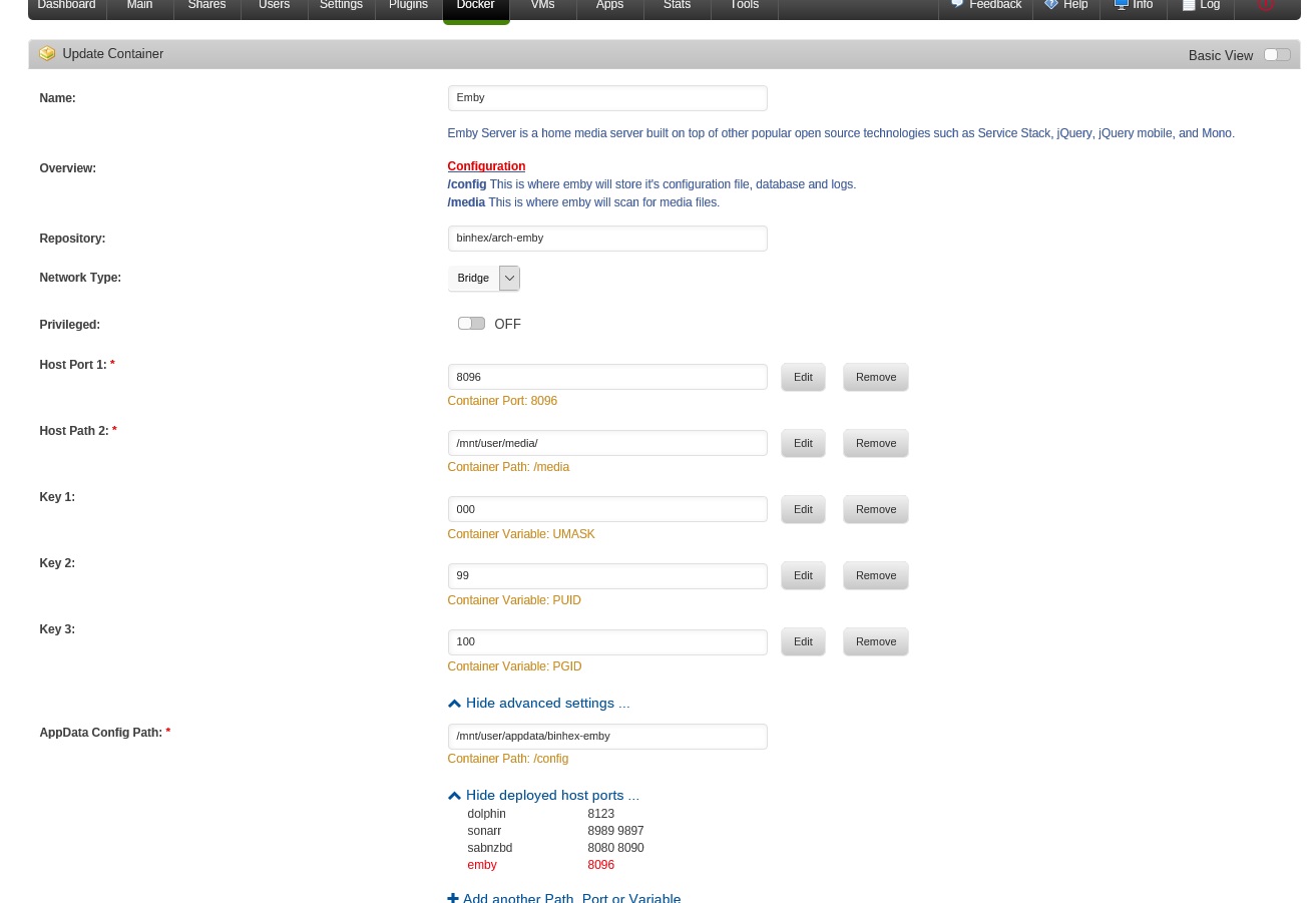

Hi Binhex thanks for your great Docker containers!
Hopefully you can point me in the right direction [emoji4]
