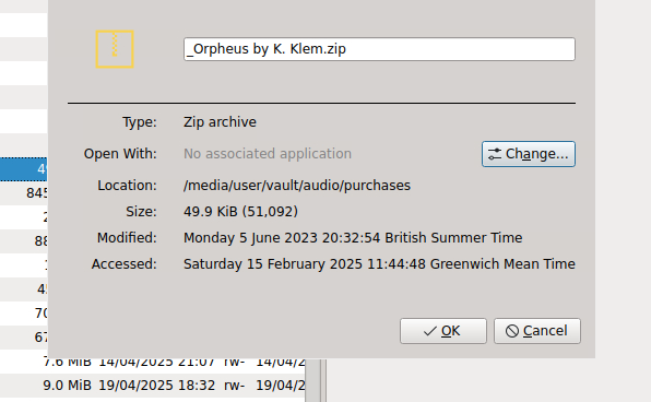

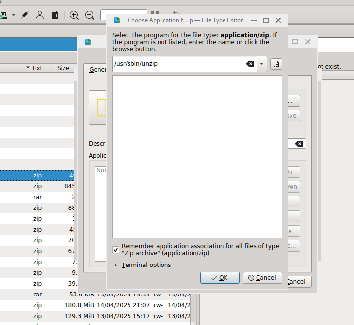

Hi when i change the open with association - its doesn't save and the dialogue box continues to pop up? any ideas how i fix this?
image.png.c0b28dd1e43641828061385ef798d92d.pngimage.png.ffe829ba2bfbca50a6df7d1f84cb26a0.png
