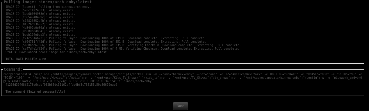

Might be a problem with the latest version.  I tried to install and it only downloads 4MB and doesn't start.  Appdata folder contains two files, perms and supervisor log.
2017-11-27 21:11:00.960595 [info] Host is running unRAID
2017-11-27 21:11:01.004655 [info] System information Linux 41203d39f68f 4.9.30-unRAID #1 SMP PREEMPT Fri May 26 13:56:36 PDT 2017 x86_64 GNU/Linux
2017-11-27 21:11:01.052360 [info] PUID defined as '99'
2017-11-27 21:11:01.096736 [info] PGID defined as '100'
2017-11-27 21:11:01.395183 [info] UMASK defined as '000'
2017-11-27 21:11:01.436201 [info] Setting permissions recursively on volume mappings...
chown: cannot access '/etc/conf.d/emby-server': No such file or directory
chown: cannot access '/usr/lib/emby-server': No such file or directory
chown: cannot access '/usr/bin/emby-server': No such file or directory

ok guys, its all fixed up please grab the newly built image, looks like arch linux had a shuffle around with packages and dependencies, so needed to do some work to shore that up, all good now.
Thanks again for the hard work, Binhex.
Thank you. My kid can watch Moana again :)
Working good, thanks!
