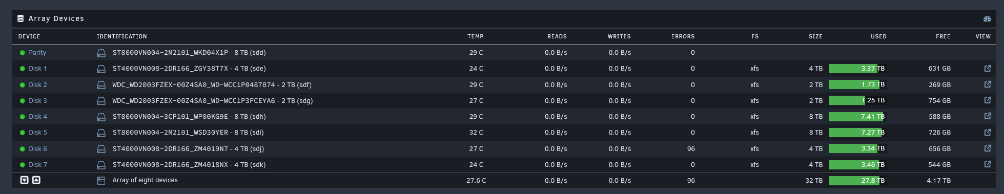

  8. Hi! I'm in the midst of a read/write heavy procedure unpacking about 25 TB of rared content with unpackerr, throwing a few hundred gigs at it at a time. During last night I got a push from unraid saying Reported uncorrect on one drive increased from 0 to 1 in the middle of the current batch of unpacking. When done unraid indicated 32 errors on the drive (I assume these are corrected?) I then proceeded to run a short smart test followed by an extended smart test. During the extended smart test, reported uncorrect increased to 3. However, the test seems to say that the drive passed. See test results below: Num Test_Description Status Remaining LifeTime(hours) LBA_of_first_error # 1 Extended offline Completed without error 00% 37799 - # 2 Short offline Completed without error 00% 37786 - After the extended smart test unraid now indicates 96 errors on the drive: Reported uncorrect now sits at 3 after the extended test: 187 Reported uncorrect 0x0032 097 097 000 Old age Always Never 3 I've attached my diagnostics. (Disk 6 is the disk with the errors) Is it safe to acknowledge the error and keep using the disk but keep an eye out for increasing values and other smart errors? Or should I be looking at replacing the drive ASAP? Thanks! unraid-diagnostics-20230329-2137.zip

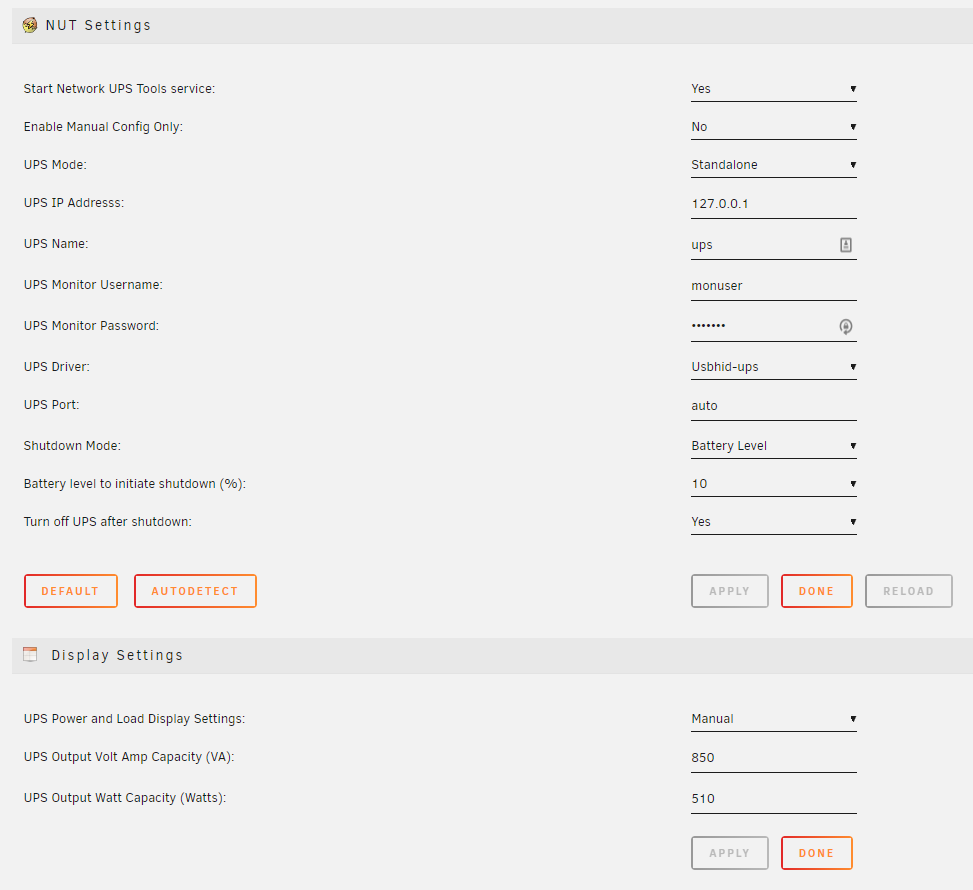

  13. I have done some more testing, and whatever setting I choose it automatically intiate shutdown procedures at exactly 5 minutes. My UPS was not listed on the compatibility list so I guess it's as you said som driver issue, and it safely shutdown at some default value instead which is 5 minutes. Makes kinda sense. Well I'm happy at least knowing what causes it and battery time before it shuts down.
  14. Thanks for the heads up! I did not know that. Yes it is using SLA batteries. I'll take this into consideration, however I do not get many power failures. Can't remember I have had any at all since I moved in 4 years ago. From the dashboard in unraid while I was monitoring it when testing the UPS, I was monitoring what NUT reported constantly. The display on the UPS itself was at 2/4 bars battery with about 6-7 minutes left. NUT seems to be reporting about the same as the UPS itself, the battery percentage dropped at an expected rate in NUT. Would it be better to try runtime left or time on battery? I timed the server to need about 1,5m to shutdown properly.

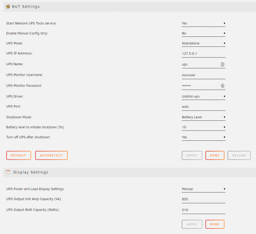

  15. Hi! I have an Eaton Ellipse PRO 850 that I am using with this plugin on my unRAID-machine. I am having some trouble getting my shutdown settings to work 100%. I have set NUT to intiate shutdown at 10% left on battery, however it intiates shutdown way to early at around 59% from the two times I have tested now. Here is my NUT Settings: Here is the log from the shutdown procedure: Jan 8 23:14:17 unRAID upsmon[23159]: UPS [email protected] on battery Jan 8 23:19:27 unRAID upsmon[23159]: UPS [email protected] battery is low Jan 8 23:19:27 unRAID upsd[23155]: Client [email protected] set FSD on UPS [ups] Jan 8 23:19:27 unRAID upsmon[23159]: Executing automatic power-fail shutdown Jan 8 23:19:27 unRAID upsmon[23159]: Auto logout and shutdown proceeding Jan 8 23:19:32 unRAID shutdown[12858]: shutting down for system halt Jan 8 23:19:32 unRAID init: Switching to runlevel: 0 Jan 8 23:19:33 unRAID init: Trying to re-exec init Jan 8 23:19:39 unRAID emhttpd: req (5): cmdStop=apply&csrf_token=**************** Jan 8 23:19:39 unRAID kernel: mdcmd (49): nocheck Jan 8 23:19:39 unRAID emhttpd: Spinning up all drives... Jan 8 23:19:39 unRAID kernel: md: nocheck_array: check not active Jan 8 23:19:39 unRAID emhttpd: shcmd (3637): /usr/sbin/hdparm -S0 /dev/sdb Jan 8 23:19:39 unRAID kernel: mdcmd (50): spinup 0 Jan 8 23:19:39 unRAID kernel: mdcmd (51): spinup 1 Jan 8 23:19:39 unRAID kernel: mdcmd (52): spinup 2 Jan 8 23:19:39 unRAID kernel: mdcmd (53): spinup 3 Jan 8 23:19:39 unRAID kernel: mdcmd (54): spinup 4 Jan 8 23:19:39 unRAID kernel: mdcmd (55): spinup 5 Jan 8 23:19:39 unRAID kernel: mdcmd (56): spinup 6 Jan 8 23:19:39 unRAID root: Jan 8 23:19:39 unRAID root: /dev/sdb: Jan 8 23:19:39 unRAID root: setting standby to 0 (off) Jan 8 23:19:39 unRAID emhttpd: shcmd (3638): /usr/sbin/hdparm -S0 /dev/sdc Jan 8 23:19:39 unRAID root: Jan 8 23:19:39 unRAID root: /dev/sdc: Jan 8 23:19:39 unRAID root: setting standby to 0 (off) Jan 8 23:19:47 unRAID emhttpd: Stopping services... Jan 8 23:19:47 unRAID emhttpd: shcmd (3640): /etc/rc.d/rc.libvirt stop Jan 8 23:19:49 unRAID root: Domain e4ccb7aa-8d12-682a-06b3-307208dabd56 is being shutdown Jan 8 23:19:49 unRAID root: Jan 8 23:19:49 unRAID root: Domain 3e293166-fb30-b06a-1c27-1a7d1f74abce is being shutdown Jan 8 23:19:49 unRAID root: Jan 8 23:19:51 unRAID avahi-daemon[10125]: Interface vnet0.IPv6 no longer relevant for mDNS. Jan 8 23:19:51 unRAID avahi-daemon[10125]: Leaving mDNS multicast group on interface vnet0.IPv6 with address fe80::fc54:ff:fecf:fa47. Jan 8 23:19:51 unRAID kernel: br0: port 2(vnet0) entered disabled state Jan 8 23:19:51 unRAID kernel: device vnet0 left promiscuous mode Jan 8 23:19:51 unRAID kernel: br0: port 2(vnet0) entered disabled state Jan 8 23:19:51 unRAID avahi-daemon[10125]: Withdrawing address record for fe80::fc54:ff:fecf:fa47 on vnet0. Jan 8 23:20:04 unRAID avahi-daemon[10125]: Interface vnet1.IPv6 no longer relevant for mDNS. Jan 8 23:20:04 unRAID avahi-daemon[10125]: Leaving mDNS multicast group on interface vnet1.IPv6 with address fe80::fc54:ff:fe0b:b049. Jan 8 23:20:04 unRAID kernel: br0: port 3(vnet1) entered disabled state Jan 8 23:20:04 unRAID kernel: device vnet1 left promiscuous mode Jan 8 23:20:04 unRAID kernel: br0: port 3(vnet1) entered disabled state Jan 8 23:20:04 unRAID avahi-daemon[10125]: Withdrawing address record for fe80::fc54:ff:fe0b:b049 on vnet1. Jan 8 23:20:04 unRAID root: Waiting on VMs to shutdown............... Jan 8 23:20:04 unRAID root: Stopping libvirtd... Jan 8 23:20:04 unRAID dnsmasq[12878]: exiting on receipt of SIGTERM Jan 8 23:20:04 unRAID kernel: device virbr0-nic left promiscuous mode Jan 8 23:20:04 unRAID kernel: virbr0: port 1(virbr0-nic) entered disabled state Jan 8 23:20:04 unRAID avahi-daemon[10125]: Interface virbr0.IPv4 no longer relevant for mDNS. Jan 8 23:20:04 unRAID avahi-daemon[10125]: Leaving mDNS multicast group on interface virbr0.IPv4 with address 192.168.122.1. Jan 8 23:20:04 unRAID dhcpcd[1675]: virbr0: new hardware address: Jan 8 23:20:04 unRAID avahi-daemon[10125]: Withdrawing address record for 192.168.122.1 on virbr0. Jan 8 23:20:04 unRAID root: Network 7e6a3e65-1f8a-40ba-881f-e3fc72e43adf destroyed Jan 8 23:20:04 unRAID root: Jan 8 23:20:08 unRAID root: Stopping virtlogd... Jan 8 23:20:09 unRAID root: Stopping virtlockd... Jan 8 23:20:10 unRAID emhttpd: shcmd (3641): umount /etc/libvirt Jan 8 23:20:10 unRAID root: Stopping docker_load Jan 8 23:20:10 unRAID emhttpd: shcmd (3643): /etc/rc.d/rc.docker stop Jan 8 23:20:12 unRAID kernel: device br0 left promiscuous mode Jan 8 23:20:12 unRAID kernel: veth5ddce05: renamed from eth0 Jan 8 23:20:13 unRAID root: stopping dockerd ... Jan 8 23:20:14 unRAID root: waiting for docker to die ... Jan 8 23:20:15 unRAID avahi-daemon[10125]: Interface docker0.IPv4 no longer relevant for mDNS. Jan 8 23:20:15 unRAID avahi-daemon[10125]: Leaving mDNS multicast group on interface docker0.IPv4 with address 172.17.0.1. Jan 8 23:20:15 unRAID avahi-daemon[10125]: Withdrawing address record for 172.17.0.1 on docker0. Jan 8 23:20:15 unRAID emhttpd: shcmd (3644): umount /var/lib/docker Jan 8 23:20:15 unRAID cache_dirs: Stopping cache_dirs process 11711 Jan 8 23:20:17 unRAID cache_dirs: cache_dirs service rc.cachedirs: Stopped Jan 8 23:20:17 unRAID unassigned.devices: Unmounting All Devices... Jan 8 23:20:18 unRAID emhttpd: shcmd (3645): /etc/rc.d/rc.samba stop Jan 8 23:20:18 unRAID emhttpd: shcmd (3646): rm -f /etc/avahi/services/smb.service Jan 8 23:20:18 unRAID avahi-daemon[10125]: Files changed, reloading. Jan 8 23:20:18 unRAID avahi-daemon[10125]: Service group file /services/smb.service vanished, removing services. Jan 8 23:20:18 unRAID emhttpd: Stopping mover... Jan 8 23:20:18 unRAID emhttpd: shcmd (3649): /usr/local/sbin/mover stop Jan 8 23:20:18 unRAID root: mover: not running Jan 8 23:20:18 unRAID emhttpd: Sync filesystems... Jan 8 23:20:18 unRAID emhttpd: shcmd (3650): sync Jan 8 23:20:18 unRAID emhttpd: Stopping ProFTPd... Jan 8 23:20:19 unRAID proftpd[2608]: 127.0.0.1 - ProFTPD killed (signal 15) Jan 8 23:20:19 unRAID proftpd[2608]: 127.0.0.1 - ProFTPD 1.3.6 standalone mode SHUTDOWN Jan 8 23:20:20 unRAID emhttpd: ... Stop OK Jan 8 23:20:21 unRAID emhttpd: shcmd (3651): umount /mnt/user0 Jan 8 23:20:21 unRAID emhttpd: shcmd (3652): rmdir /mnt/user0 Jan 8 23:20:21 unRAID emhttpd: shcmd (3653): umount /mnt/user Jan 8 23:20:21 unRAID emhttpd: shcmd (3654): rmdir /mnt/user Jan 8 23:20:21 unRAID emhttpd: shcmd (3655): rm -f /boot/config/plugins/dynamix/mover.cron Jan 8 23:20:21 unRAID emhttpd: shcmd (3656): /usr/local/sbin/update_cron Jan 8 23:20:21 unRAID emhttpd: Unmounting disks... Jan 8 23:20:21 unRAID emhttpd: shcmd (3657): umount /mnt/disk1 Jan 8 23:20:21 unRAID kernel: XFS (md1): Unmounting Filesystem Jan 8 23:20:28 unRAID emhttpd: shcmd (3658): rmdir /mnt/disk1 Jan 8 23:20:28 unRAID emhttpd: shcmd (3659): umount /mnt/disk2 Jan 8 23:20:28 unRAID kernel: XFS (md2): Unmounting Filesystem Jan 8 23:20:28 unRAID emhttpd: shcmd (3660): rmdir /mnt/disk2 Jan 8 23:20:28 unRAID emhttpd: shcmd (3661): umount /mnt/disk3 Jan 8 23:20:28 unRAID kernel: XFS (md3): Unmounting Filesystem Jan 8 23:20:28 unRAID emhttpd: shcmd (3662): rmdir /mnt/disk3 Jan 8 23:20:28 unRAID emhttpd: shcmd (3663): umount /mnt/disk4 Jan 8 23:20:29 unRAID kernel: XFS (md4): Unmounting Filesystem Jan 8 23:20:29 unRAID emhttpd: shcmd (3664): rmdir /mnt/disk4 Jan 8 23:20:29 unRAID emhttpd: shcmd (3665): umount /mnt/disk5 Jan 8 23:20:29 unRAID kernel: XFS (md5): Unmounting Filesystem Jan 8 23:20:29 unRAID emhttpd: shcmd (3666): rmdir /mnt/disk5 Jan 8 23:20:29 unRAID emhttpd: shcmd (3667): umount /mnt/disk6 Jan 8 23:20:29 unRAID kernel: XFS (md6): Unmounting Filesystem Jan 8 23:20:29 unRAID emhttpd: shcmd (3668): rmdir /mnt/disk6 Jan 8 23:20:29 unRAID emhttpd: shcmd (3669): umount /mnt/cache Jan 8 23:20:29 unRAID emhttpd: shcmd (3670): rmdir /mnt/cache Jan 8 23:20:29 unRAID root: Stopping diskload Jan 8 23:20:29 unRAID kernel: mdcmd (57): stop Jan 8 23:20:29 unRAID kernel: md1: stopping Jan 8 23:20:29 unRAID kernel: md2: stopping Jan 8 23:20:29 unRAID kernel: md3: stopping Jan 8 23:20:29 unRAID kernel: md4: stopping Jan 8 23:20:30 unRAID kernel: md5: stopping Jan 8 23:20:30 unRAID kernel: md6: stopping Jan 8 23:20:30 unRAID emhttpd: Starting services... Jan 8 23:20:30 unRAID emhttpd: shcmd (3672): /etc/rc.d/rc.samba start Jan 8 23:20:30 unRAID root: Starting Samba: /usr/sbin/nmbd -D Jan 8 23:20:30 unRAID root: /usr/sbin/smbd -D Jan 8 23:20:30 unRAID root: /usr/sbin/winbindd -D Jan 8 23:20:30 unRAID emhttpd: shcmd (3673): cp /tmp/emhttp/smb.service /etc/avahi/services/smb.service Jan 8 23:20:30 unRAID avahi-daemon[10125]: Files changed, reloading. Jan 8 23:20:30 unRAID avahi-daemon[10125]: Loading service file /services/smb.service. Can anyone help me figure out what is wrong? Thanks!
