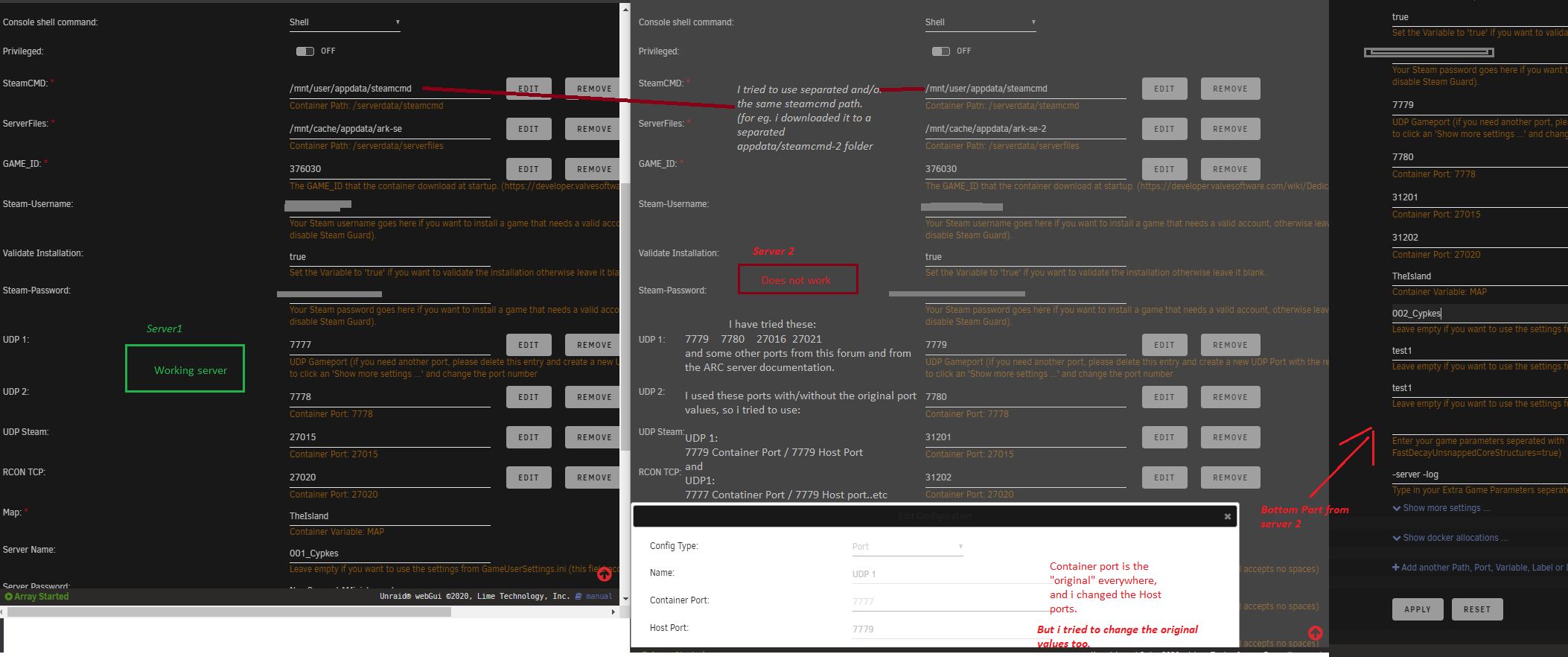

  1. 1. Are you trying to access to second map from a VM on the same UnRaid server, another machine in the LAN, or from an external source? - i bought the game for a secondary steam account, and i use that account in unraid, and we play from external pcs on the server1/map1 with other steam accounts. (download from steam works well) but server2 was not visible in ARK game clients. (i know there are 16000+ servers, so ive tried to find it many times ) 2. What ports are your internal config files pointed to on your second map? Probably this is the problem. Thank you for the quesstion! ive found 2 configs: ShooterGame/Config/DefaultEngine.ini [OnlineSubsystemSteam] GameServerQueryPort=27015 ShooterGame\Saved\Config\LinuxServer\GameUserSettings.ini [ServerSettings] RCONPort=27020 i tried to change these without success. Based on this Should i change these? Should i change something somewhere else ? Basically.. when i try to a run server, 1., reDownload or Copy the container. - SteamCMD is the same, i use only one steamCMD location, for eg. appdata/streamcmd - Game itself is separated, i use a secondary folder, for eg. appdata/ark-se-2 2. Delete every ports from the template 3. Create new ports (version "A") Container port -> Host port 7777 -> 7779 UDP 7778 ->7780 UDP 27015 ->27016 UDP 27020 -> 27021 TCP or. (version "B") 7779 -> 7779 UDP 7780 ->7780 UDP 27016 -> 27016 UDP 27021 -> 27021 TCP Then., when i use version B., i change these: GameServerQueryPort=27015 change to 27016 RCONPort=27020 change to 27021 And port forward in the router. i fill the other settings, server name/pass..etc but probably these are OK, i learnt it when i ran the first server (and th again, if i can fix this with your help, ill definitely write a "how to" docs for the other noobs like me.. )
  2. Could you help me please, whats wrong with my setup ? I have read the whole tread in the last 5 hours but i couldn't find the fix. My problem: I have one running server, (this is cool, thank you for the template) now i want to create a second running server on another map. As the first step, tried to start it on the same map, as a test but the second server is not visible in ARK game, or it does not work correctly. I tried to use the recommended ports (Server game instance 2 7779 7780 27016 27021) from here, then i tried to use different ports (3320x) based on a few screenshots from this thread. And i tried to use the the same appdata/ark-se folder in Server2 too. (Port forwarding triple checked too.. ) Do you have an idea ? Thank you!
