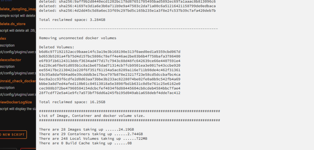

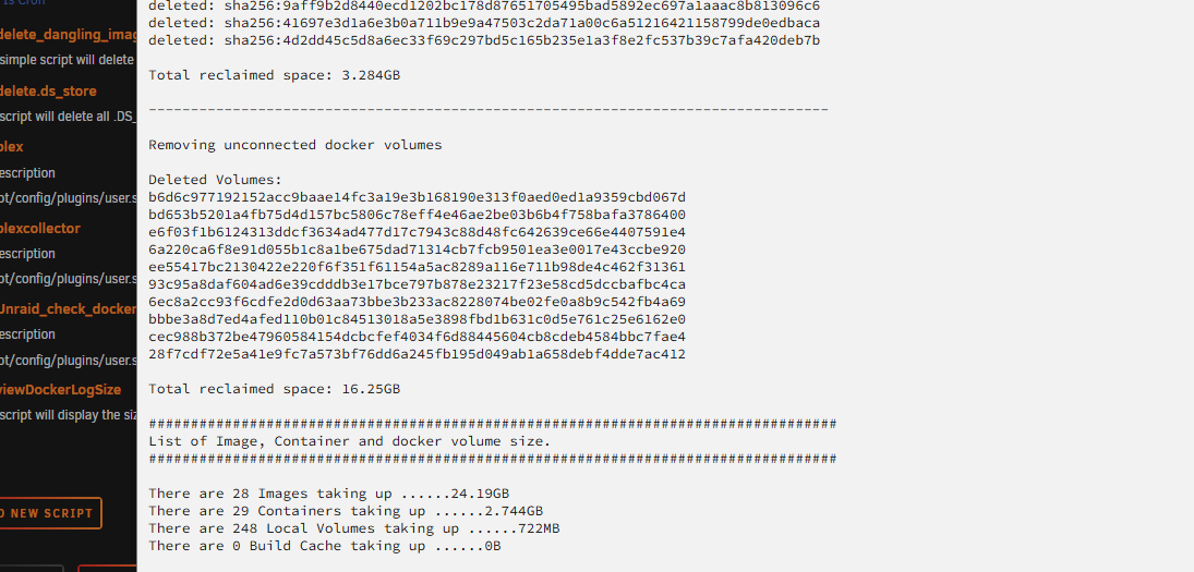

  2. "This volume connected to has a size of 6.6G" - that means that it's unconnected any docker? If i run the script with 'yes' it should delete that correct? -n
  3. Got it, how to you know what ID is what? See the data but... Script location: /tmp/user.scripts/tmpScripts/Unraid_check_docker_script/script Note that closing this window will abort the execution of this script ################################################################################## Cleanup before starting (if requested in script) ################################################################################## Not removing orphaned images (this can be set in script if you want to) --------------------------------------------------------------------------------- Not removing unconnected docker volumes (this can be set in script if you want to) ################################################################################## List of Image, Container and docker volume size. ################################################################################## There are 35 Images taking up ......27.48GB There are 29 Containers taking up ......2.743GB There are 258 Local Volumes taking up ......16.97GB There are 0 Build Cache taking up ......0B ################################################################################## List of containers showing size and virtual size ################################################################################## First size is the writable layers of the container (Virtual size is writable and read only layers) 0B (virtual 1.55GB) Is being taken up by ......... jellyfin/jellyfin:latest 227kB (virtual 1.3GB) Is being taken up by ......... binhex/arch-nzbhydra2 23B (virtual 1.04GB) Is being taken up by ......... fyb3roptik/threadfin:latest-nvidia 0B (virtual 419MB) Is being taken up by ......... linuxserver/swag 0B (virtual 651MB) Is being taken up by ......... jlesage/filebot 190B (virtual 74.3MB) Is being taken up by ......... authelia/authelia 22.8kB (virtual 187MB) Is being taken up by ......... linuxserver/jackett 498MB (virtual 703MB) Is being taken up by ......... linuxserver/sonarr:latest 318MB (virtual 1.45GB) Is being taken up by ......... linuxserver/nextcloud:latest 0B (virtual 246MB) Is being taken up by ......... vaultwarden/server 7.33MB (virtual 120MB) Is being taken up by ......... bitnami/redis:latest 0B (virtual 246MB) Is being taken up by ......... vaultwarden/server 0B (virtual 603MB) Is being taken up by ......... nodered/node-red 4.4kB (virtual 683MB) Is being taken up by ......... ghcr.io/mealie-recipes/mealie:nightly 0B (virtual 75.1MB) Is being taken up by ......... gcr.io/cadvisor/cadvisor 226MB (virtual 2.23GB) Is being taken up by ......... binhex/arch-plexpass 70.9kB (virtual 260MB) Is being taken up by ......... hotio/radarr:nightly 471MB (virtual 4.13GB) Is being taken up by ......... ghcr.io/haveagitgat/tdarr_node 914MB (virtual 5.11GB) Is being taken up by ......... ghcr.io/haveagitgat/tdarr 133MB (virtual 1.53GB) Is being taken up by ......... binhex/arch-sabnzbd 49.6kB (virtual 189MB) Is being taken up by ......... jlesage/nginx-proxy-manager 2.66kB (virtual 204MB) Is being taken up by ......... tautulli/tautulli 12MB (virtual 2.64GB) Is being taken up by ......... binhex/arch-delugevpn 0B (virtual 991MB) Is being taken up by ......... ghcr.io/ajnart/homarr:latest 158MB (virtual 966MB) Is being taken up by ......... uldiseihenbergs/meshcentral 0B (virtual 397MB) Is being taken up by ......... meisnate12/plex-meta-manager:latest 0B (virtual 616MB) Is being taken up by ......... tzahi12345/youtubedl-material 4.6MB (virtual 1.18GB) Is being taken up by ......... ghcr.io/home-assistant/intel-nuc-homeassistant:2021.10.4 87.8kB (virtual 555MB) Is being taken up by ......... djaydev/handbrake ################################################################################## List of containers in size order ################################################################################## 4190MB - ghcr.io/haveagitgat/tdarr 3660MB - ghcr.io/haveagitgat/tdarr_node 2630MB - binhex/arch-delugevpn 2000MB - binhex/arch-plexpass 1550MB - jellyfin/jellyfin 1390MB - binhex/arch-sabnzbd 1300MB - binhex/arch-nzbhydra2 1180MB - ghcr.io/home-assistant/intel-nuc-homeassistant 1130MB - linuxserver/nextcloud 1040MB - fyb3roptik/threadfin 991MB - ghcr.io/ajnart/homarr 808MB - uldiseihenbergs/meshcentral 683MB - ghcr.io/mealie-recipes/mealie 651MB - jlesage/filebot 628MB - linuxserver/sonarr 616MB - tzahi12345/youtubedl-material 603MB - nodered/node-red 555MB - djaydev/handbrake 516MB - linuxserver/nextcloud 464MB - linuxserver/nextcloud 460MB - linuxserver/nextcloud 447MB - linuxserver/nextcloud 421MB - linuxserver/nextcloud 420MB - linuxserver/nextcloud 419MB - linuxserver/swag 397MB - meisnate12/plex-meta-manager 260MB - hotio/radarr 246MB - vaultwarden/server 205MB - linuxserver/sonarr 204MB - tautulli/tautulli 189MB - jlesage/nginx-proxy-manager 187MB - linuxserver/jackett 113MB - bitnami/redis 75.1MB - gcr.io/cadvisor/cadvisor 74.3MB - authelia/authelia ################################################################################## List of docker volumes, the container which they are connected to their size ################################################################################## ID 0a6f1e5d7412990e219cb7bce15e6a161fd0e5a50b28459c742b451e4aaa5903 This volume connected to has a size of 0 ID 0a621207ad768a6005f62b40d255364d280cee4d4b337d9cf5c832d6bbbd846e This volume connected to has a size of 0 ID 6a220ca6f8e91d055b1c8a1be675dad71314cb7fcb9501ea3e0017e43ccbe920 This volume connected to has a size of 3.7G ID 6cba2a515464595409587f897badc05f8c2b1f197a945b54e77c0b414f1b7d7f This volume connected to has a size of 87M ID 6d500b41124061de129efc8c1e8dd95026f363609f51b0c1c40cfbcaa217e903 This volume connected to has a size of 0 ID 6ec8a2cc93f6cdfe2d0d63aa73bbe3b233ac8228074be02fe0a8b9c542fb4a69 This volume connected to has a size of 34M ID 8b28e164d5cac45dbc8351147cdf6c84bb5726b0e62ffcb754b29b8e6fd1bec0 This volume connected to has a size of 87M ID 11b29f39283cd4e0d312cdba079587f52221f6a9d6bc79035de2b7ebe452b43f This volume connected to Jellyfin has a size of 0 ID 15ab81e5870429ad6dcdffdb42c2c4d6f93e55bd3b6b5f1514b21837e593b0f4 This volume connected to has a size of 0 ID 15c287c8e91ae606accec9835a8d7a89c9760802435d398703aa83e5f106e563 This volume connected to has a size of 0 ID 15df070eb7ea72c2e3a1eb0b33570816ba02750dabdeae61d0f9d4ea2b77f625 This volume connected to has a size of 0 ID 261a09df0f92044c77354999476890006c77a3b194169bb47c4b8819ae5712d2 This volume connected to has a size of 87M ID 02376bd9fd37368e3065ddb15859b7a557e64af0c140dc8fae362ae0bb41fe19 This volume connected to has a size of 87M ID 5084ec02c6ff26b2668c6b84f590c85aedb5b067949c961a86cf489bbf9257ad This volume connected to has a size of 87M ID 10568d3336d0b67dbef30dac2c8af8a5c3607a93abfd9d6a7c3356e431caa0a3 This volume connected to has a size of 1.6M ID bbbe3a8d7ed4afed110b01c84513018a5e3898fbd1b631c0d5e761c25e6162e0 This volume connected to has a size of 5.1G ID bdd37308f8b848c84188dafa94c98a73a0ac4ffaf8c3b2443cd093e8bca8300b This volume connected to has a size of 87M ID e8983087422fad5eb4d4dd7b0c0d1cddbdb191615d77e1ba355df7753d110ccb This volume connected to has a size of 87M ID ee55417bc2130422e220f6f351f61154a5ac8289a116e711b98de4c462f31361 This volume connected to has a size of 6.6G ID f8aabebe4c5e11576511c959a72695b41ae2e2787549b2044f11312dd7081809 This volume connected to has a size of 992K ##################################################################################

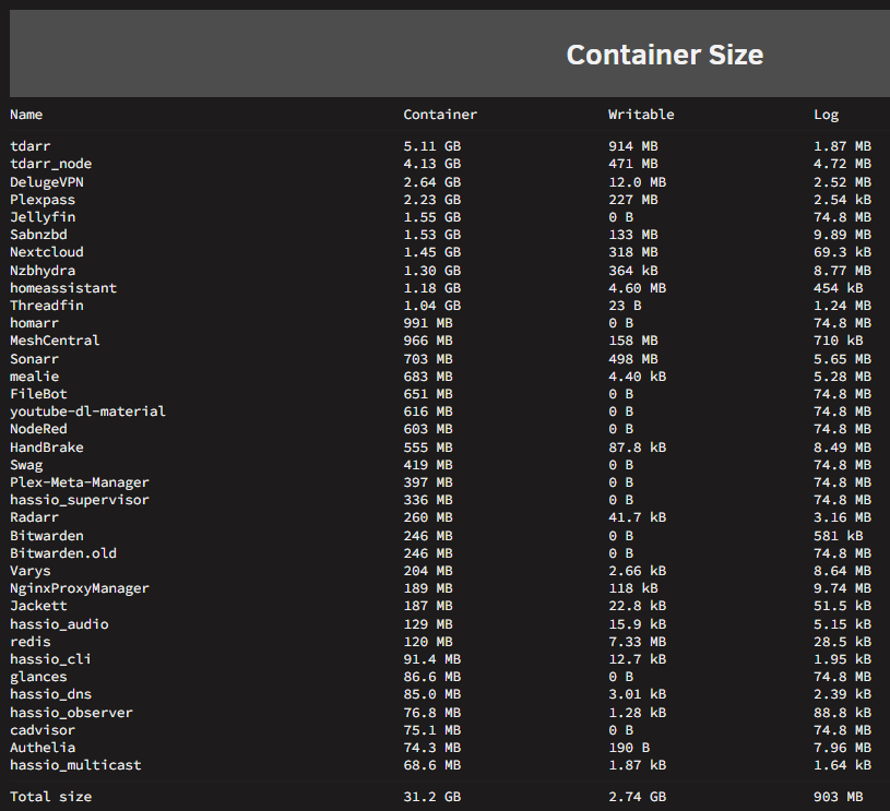

  4. That is a plugin? How to you install it?
  5. I am struggling with the docker size. I was trying to setup jellyfin and poof it hit 100%. However, I don't see that here? Would you look at my logs for me and see what is going on? noelsflix-diagnostics-20260204-0849.zip

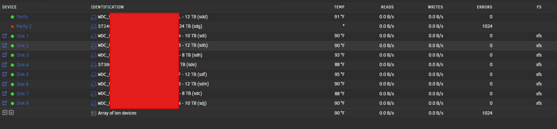

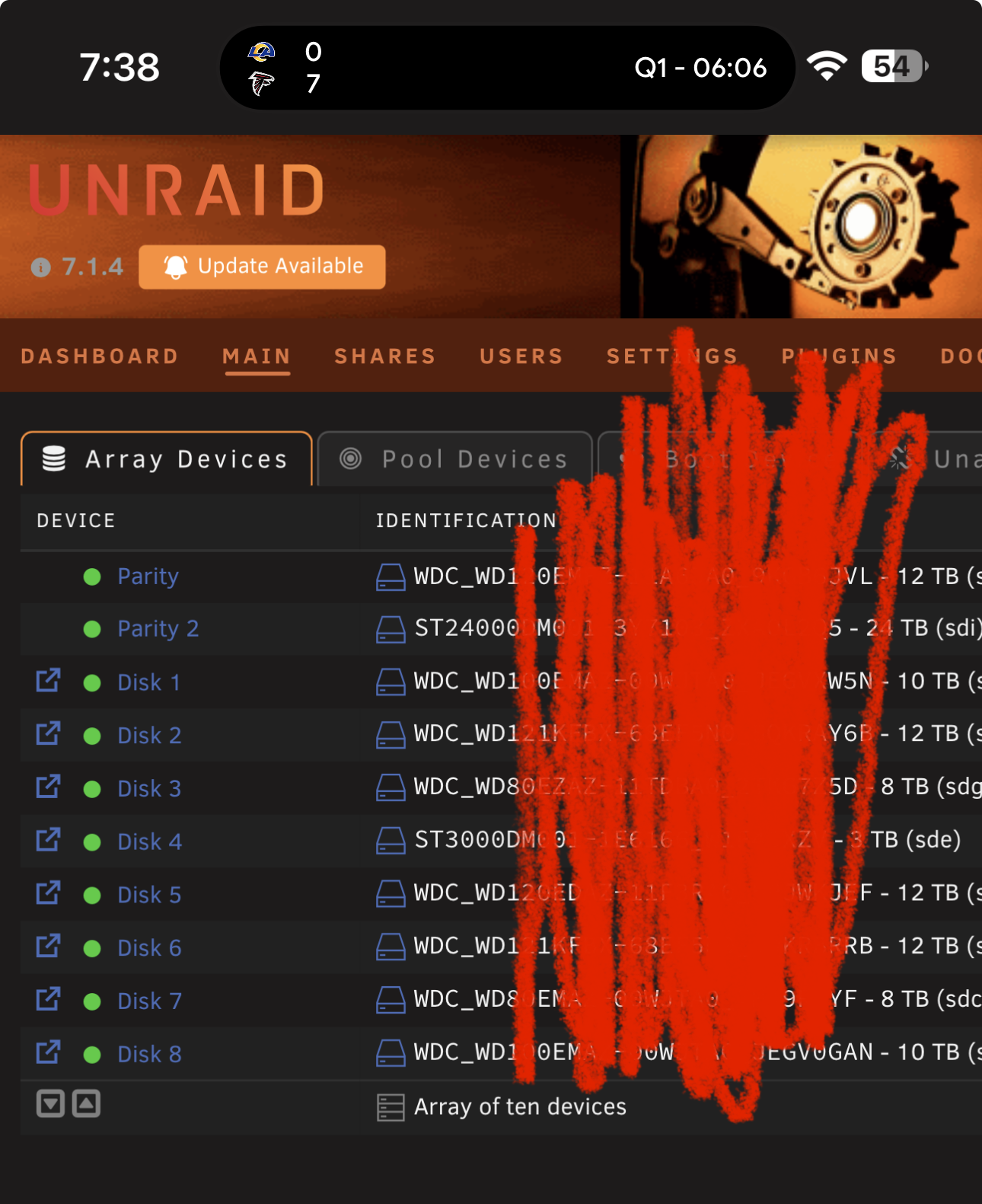

  6. I moved to a different slot and that took it. Thank you, Jorge. Now, what I understand, I can just stop the array and replace the 12 with the 24 and start it up?
  7. Hahaha, I was just looking at that right now. I have a Supermicro X9DR3-F with 2× Intel® Xeon® E5-2670 CPUs @ 2.60GHz, 128 GiB DDR3 Multi-bit ECC, and about 75 TB of storage (currently). I’ll need to check it when I get home—I forgot what I plugged in or not, you know? I haven’t touched the inside for about five years or so, lol.

  9. Merry Christmas!!! I’m trying to add three drives to Unraid. I have two 24TB drives that I want to add to parity (currently, I have one 12TB parity drive). After that, I should be able to wipe them and add them to my array. The last drive is a 20TB. However, I’m having issues doing this—could you please check my diagnostic logs? Right now, I’m just trying to add the second drive first, but I’m getting a ton of errors during the rebuild, and it keeps pausing. noelsflix-diagnostics-20251225-2113.zip

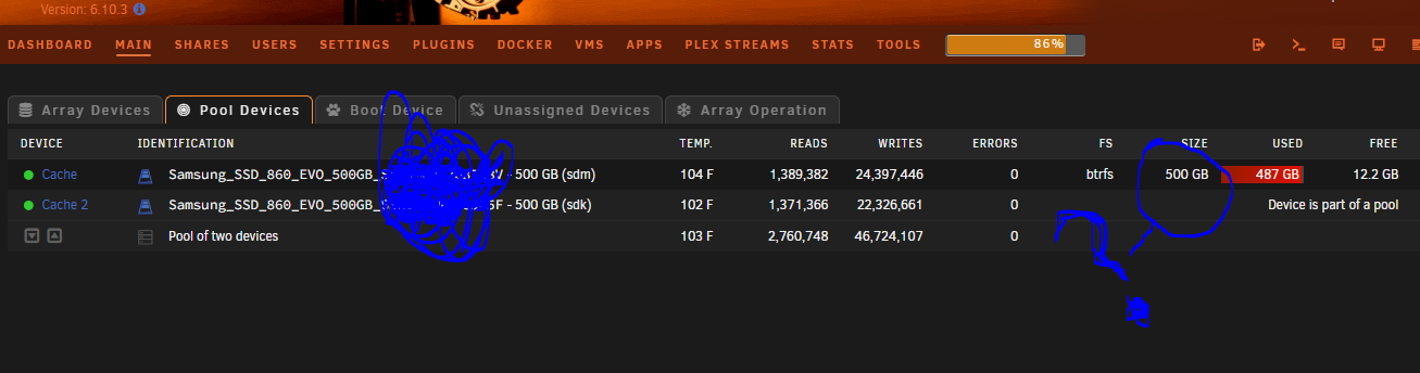

  10. I have two 500gb however it is only showing 500gb?
