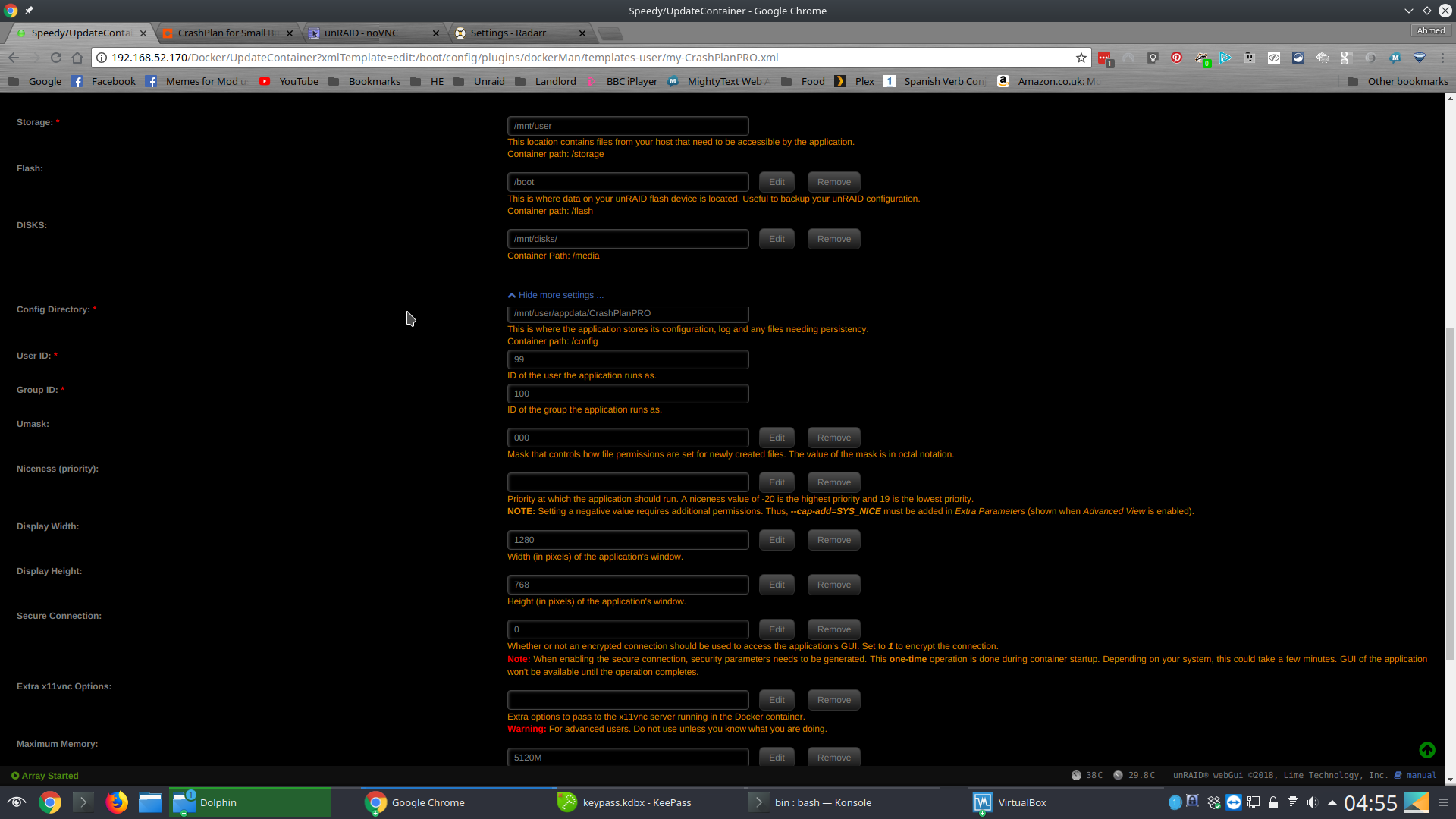

Ownership was set to root:root. I changed it recursively to nobody:users, changed the destination in Device Preferences>Destinations and it is now block syncing. Hooray!! Although it seems to be working correctly now, can you please confirm that these permissions settings are correct? Thanks for the heads up and guidance btw, it's really appreciated :-)

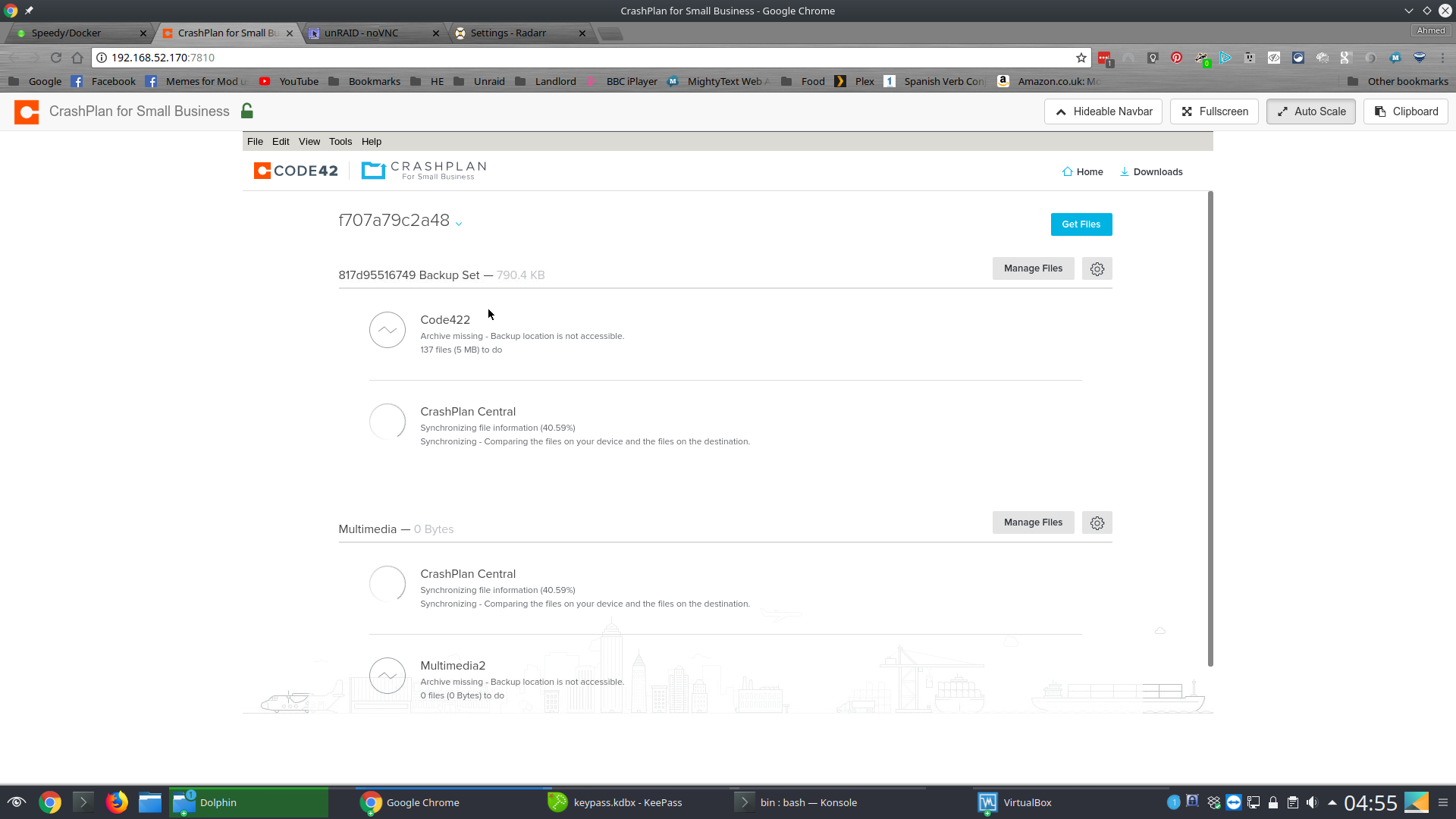

I didn't originally, but Fix Common Problems plugin brought it up as an error for me, so I changed it. It still didn't work after this. Just in case cache was causing the issue, I stopped the container and cleared it before starting the container again, but this didn't work either. In Device Preferences>Destinations, I thought I might delete the archive on that ext hdd and start again, but the app would not let me delete it. Briefly after this, the hard drive was visible on the main page and began to sync, but then returned with the same error of Archive missing- backup location not available.

Of course it is. What a doofus I am. Too little sleep and too much going on make me do silly mistakes! Thanks for the pointer. Have you any idea how I can get the container to mount the ext hdd? I've mapped the /media drive to /mnt/disks. When I go to Device Preferences>Destinations and click on the drive to change location, it sees the drive in the dialogue box (and sometimes sees the backup archive, but not always), but after selecting the drive, it still shows as archive missing as per the above screen grab.

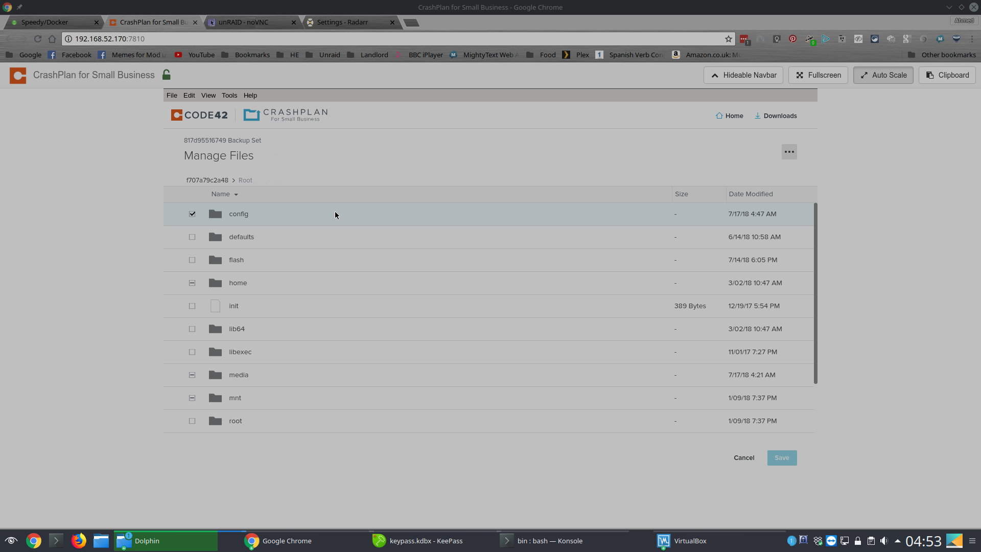

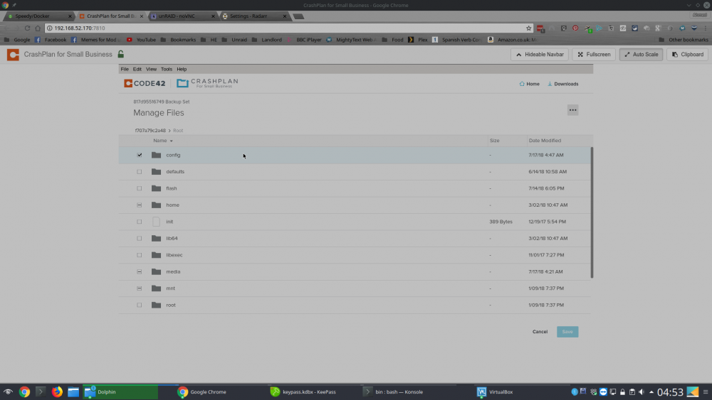

/storage isn't present in the Manage Files section though, so I am unable to access it

Unfortunately, the rest has not been plain sailing. When logging into my account and following the instructions to take over existing backup, very few of my files are present and the folder structure in the Manage Files section does not contain many of the the contents of the mapped location, so I can't add them to the selection. I copied across from my old desktop to /mnt/user all the data that I previously backed on the desktop and I more or less kept the folder structure. I should have about 1.3 tb in one set, instead I have less than 4MB. The folder /storage doesn't show in the folder list under root in the Manage Files section. The only time I could see /storage was when I looked to restore files. I could not see the ext hdd when attempting to restore from disk, so I mapped it to /mnt. This was found in device preferences, but when I tried to access it, I got an error saying the archive was missing and the location was not accessible. The integrity of my data is still ok, I have it all on the original desktop. When I go back to the desktop and transfer CrashPlan there, it all works fine and all the file structure is fully in place and non of my data is missing. It is also able to see the hard drive backup archive and read/write to it. I have installed and removed this container many times to no avail. Please someone tell me what I've been doing wrong.
