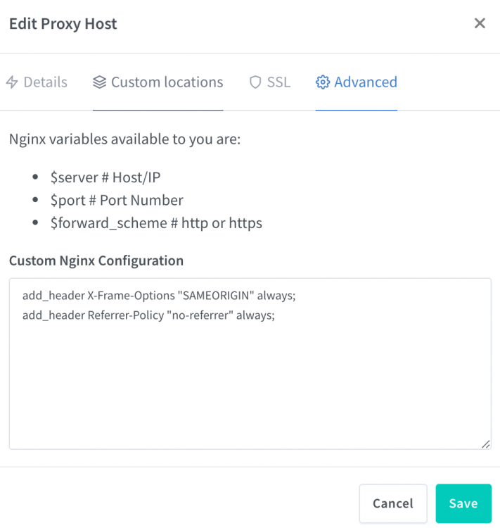

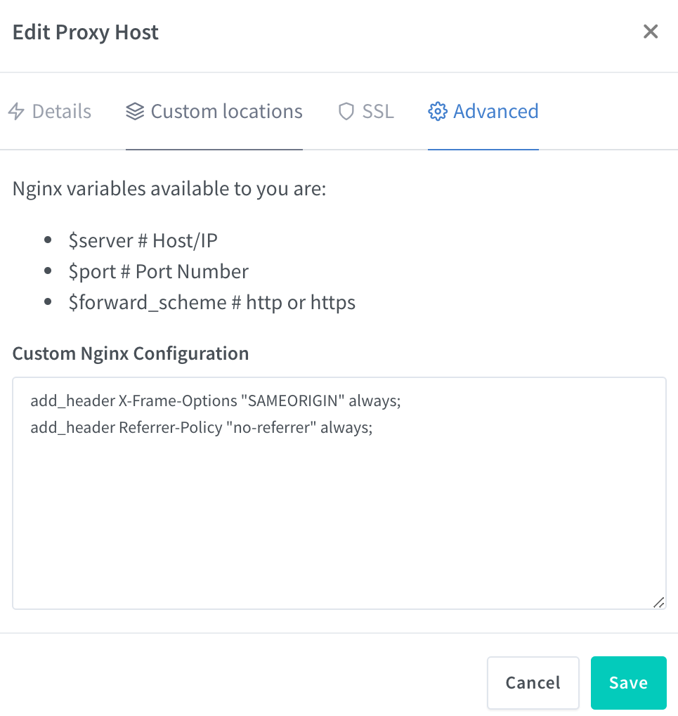

  6. Both of the headers I have listed in my advanced tab are NOT set according to https://securityheaders.com
  7. This didn't work. Here's my advanced tab. The warning remains. I restarted npm docker (not sure if that needs to be done or not) and it still persists. Do I need to restart nextcloud?

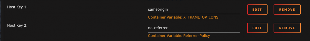

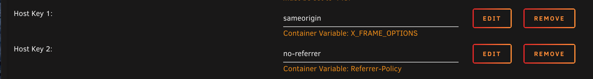

  8. I am getting a couple security warnings on nextcloud, same as I've seen on here. The project instructions at: say to set the variables thusly: After doing this the security headers scan shows the same result, that x_frame_options and referrer policy are still not set. Is the attached screen shot the way to accomplish this? Because it didn't work. How should I do this?
