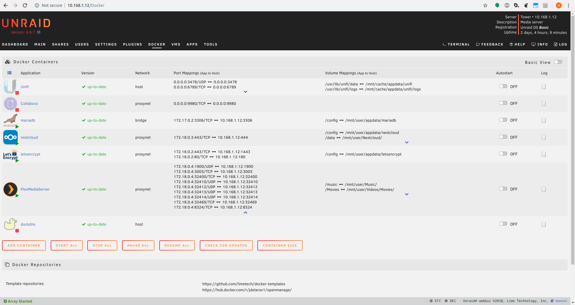

March 19, 20197 yr I have recently set up UnRaid mostly following "SpaceInvader One's" youtube videos. In particular this one - I struggled a lot to get it set up initially until I eventually realise that I could not port forward to WAN due to Carrier Grade NAT. I managed to get in contact with my ISP who were able to sort me out with a static IP. I have since managed to get https and my domain name working with LetsEncrypt and Nextcloud. However, I cannot seem to get Plex working with https and my domain name. It have managed to set it up behind the reverse proxy like so: And if I open up Plex I it is shows the green tick for Remote Access and I can connect remotely with my phone, etc. However, the last piece of the puzzle I have struggled with over the last month is: HTTPS - How to get https working using Let's Encrypt? Domain Name - How to set up Plex such that I can access it by simply going to "plex.mydomainname.com" in my browser? (I have pfSense running on my router with port 32400 forward to my UnRaid server). I assume I am probably missing something relatively obvious... Edited March 19, 20197 yr by Ntouchable Wrong Picture
