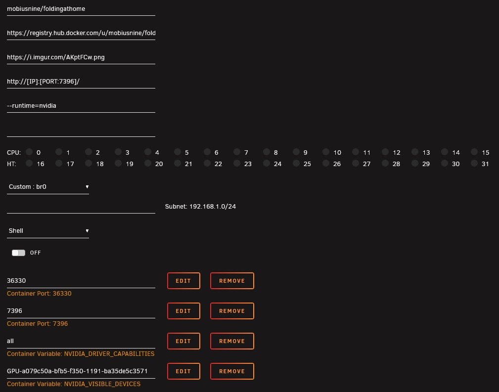

  5. I am passing all as shown in the attached picture, and yes, the latest image is accessible through Community Apps. I wonder if using a quadro is causing some other sort of issue.
