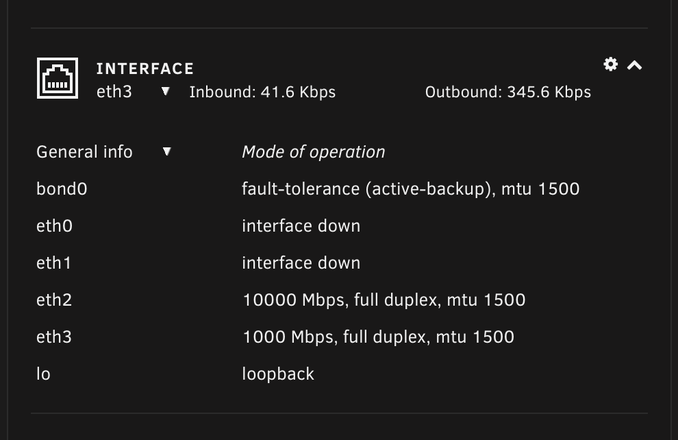

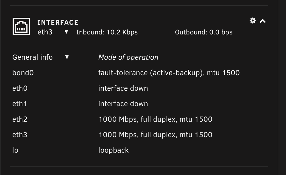

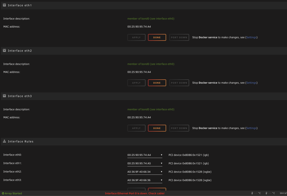

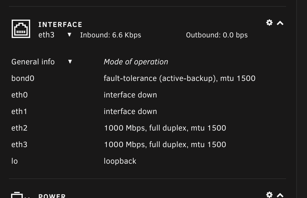

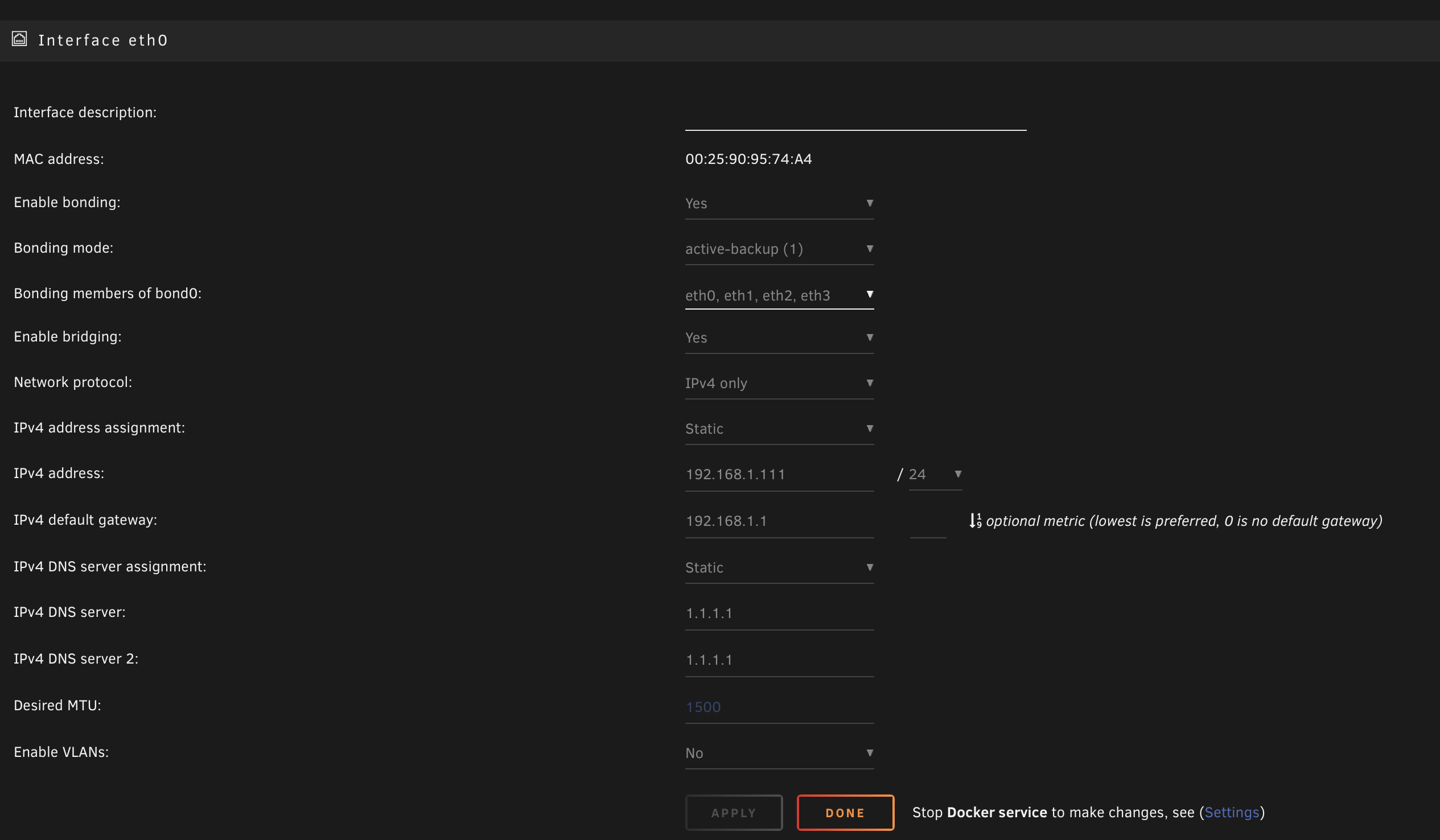

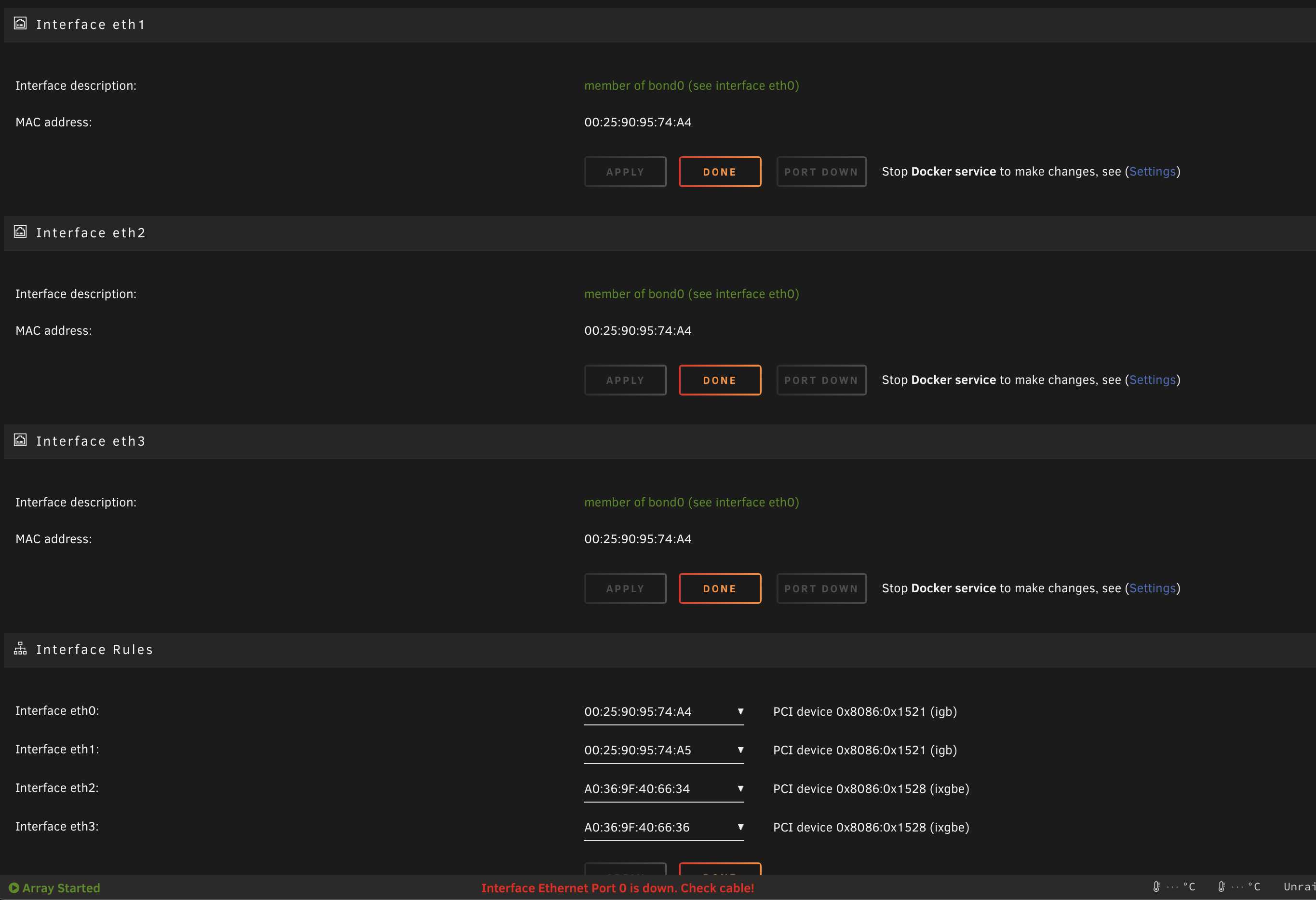

  4. Thanks for your answer ! You were right, 2.5 wasn't supported; I plug with to the 10 gbps port and I ve got 10000mbps now On my switch I ve got 4x 2.5 and 2 SPF+ 10 Gbps, that why I tried the 2.5 gbps; My internet router got only 1 x 2.5 gbps out ... and curious: why do you use 4 nics in a bond??? thats overkill and surely will get troubles) Actually I don t really know; I ve got on my mother board super micro 3 ethernet; I use one for service, and I disconnected the 2 other to plug the PCI 10 gbps card now. What do you suggest me ? To remove the bonding? To be honest I don t really know what for is it ๐Ÿ˜… Thanks again for your help !
  5. Hello today I upgrade my ethernet connection ... I just install a Dual 10 gbps PCI card on my unraid: X540-T2 Intel X540 Chipset PCIe x8 touristes Cuivre RJ45 10Gbps Port Unraid see the card, I connect the card to my 2.5 GPBS switch and I can see the unraid is connected on 1000 Mbps ... Is it because I connect to the 2.5 GB port on my Switch ? On the 10 GBPS NIC it doesn't work at all ... ( I use a SFP+ RJ45 adaptor) Did I miss something ? Any idea ? Thanks !!! tower-diagnostics-20231229-1300.zip

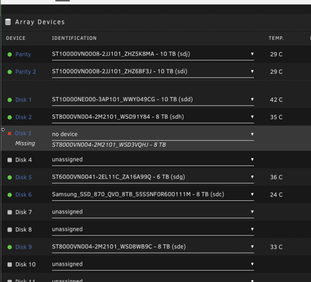

  8. Thanks for your help !! So you suggest to stop array unasigne disk 3 then I should format the disk 3 and reduilt?

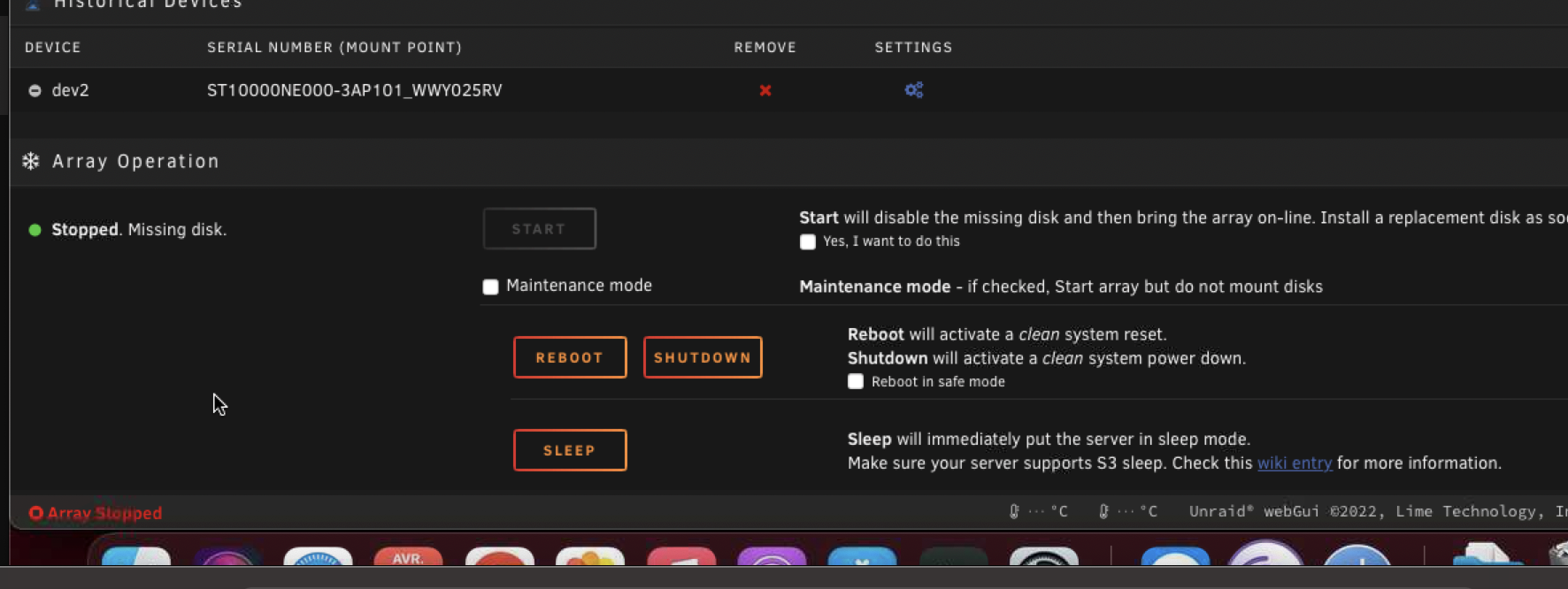

  24. Hello I recently has two problems with two ssds, I lost the first one few days ago, but I had a time to copy my files to another disque, after that I deleted the ssd of my array and make a new config without this one. After that, another ssd crashed, I wasn't able to go inside the folders, instead of that I had: NO LISTING: TOO MANY FILES. So I tried to repair the disk using the method: Checking and fixing drives in the webGui. I tried but unfortunately without success, I wasn't able to run: -nv or any others commands, nothing happen after click on "check" So I switch from maintenance mode to normal and from this action the disk 9 is now mentioned like: "Not installed" ... I m a bit lost ๐Ÿ˜… I m of course afraid to lost all the data from the disk 9... Please kindly find attached my diag files... Thanks for your time tower-diagnostics-20220819-0100.zip
