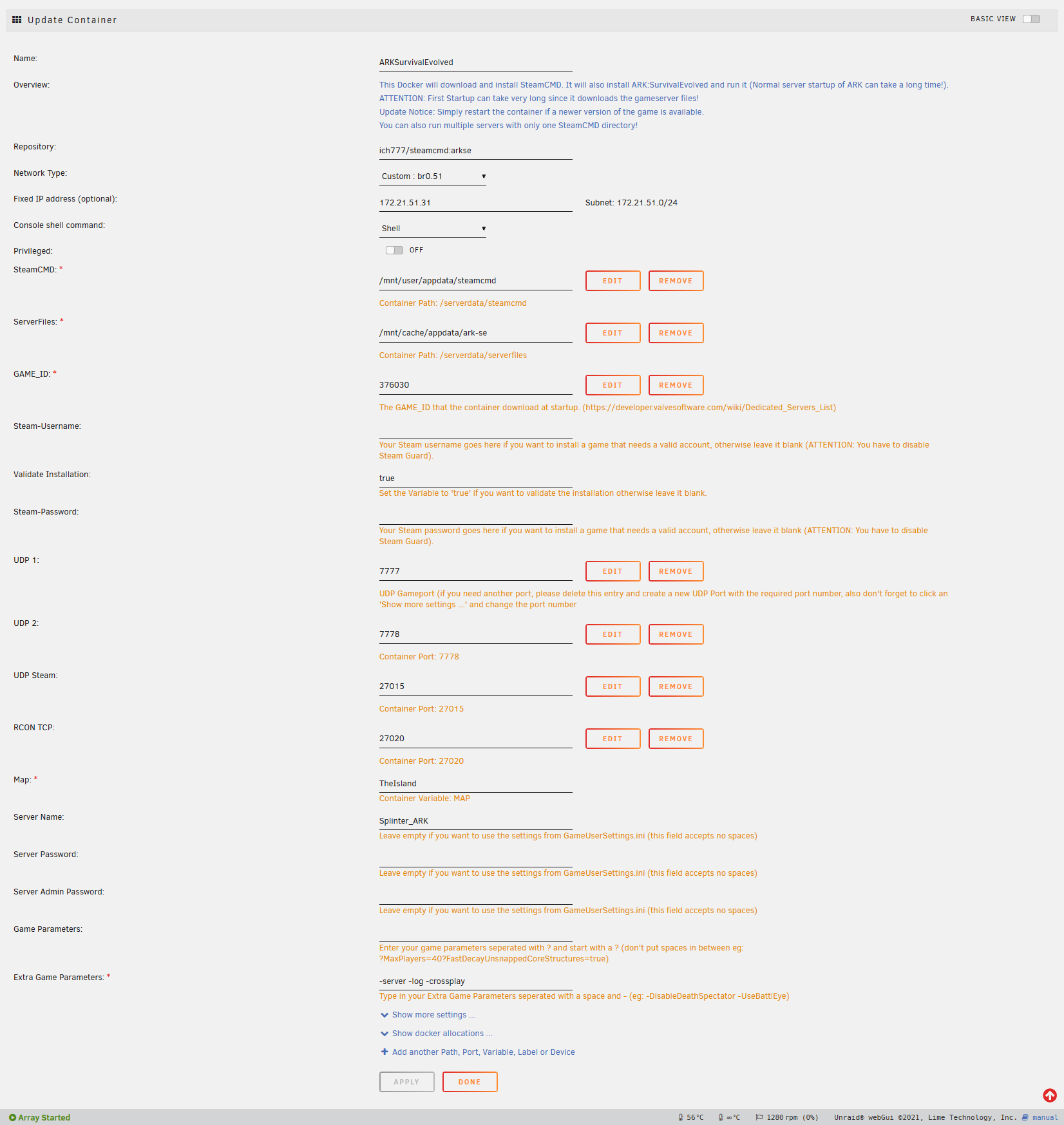

  10. i tried that before, still dont work, the only thing i change from default is: the IP address portion "Validate Installation:" to true "server Name" to Splinter_ARK ofcos the "Game Parameters:" to +exec autoexec.cfg this round i test using my steam version of the same also, dont work as well

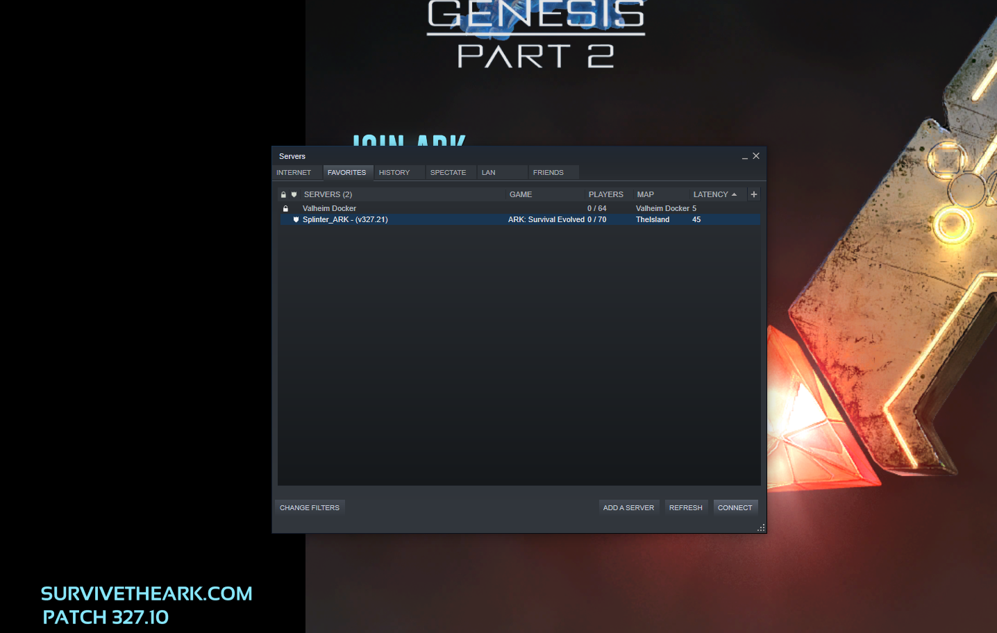

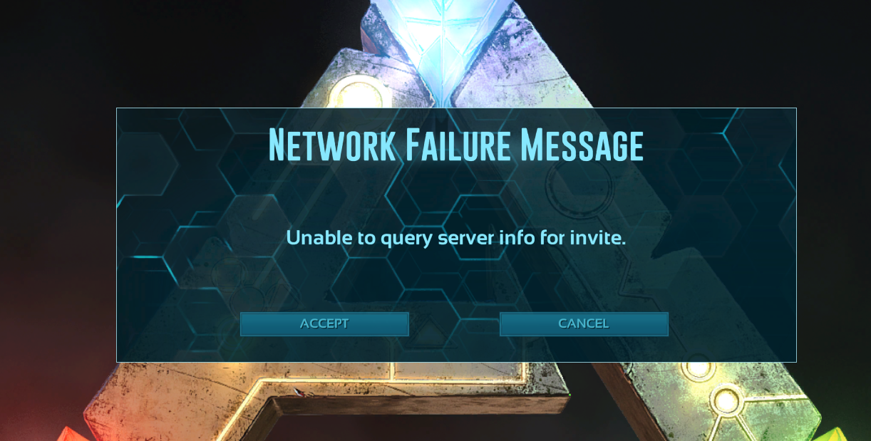

  11. how do i restart SteamCMD? i have my Valheim Docker running without Issue. can c both my my docker game server, Valheim run without issue. this is my ingame error added this as well. still same issue.
  12. @ich777 this is my setting page, did i set something wrong? im my steam server i also can c, but just when connect it have error

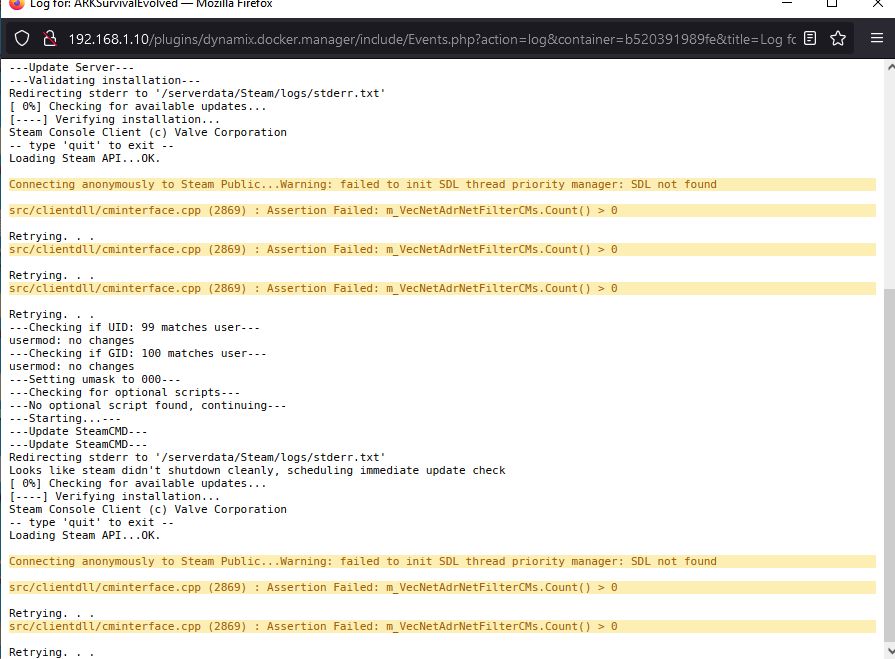

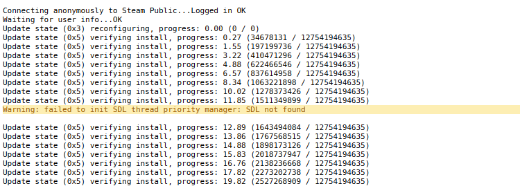

  13. do you have this "Warning: failed to init SDL thread priority manager: SDL not found" in your log?
  14. it havent, becos i have this link of warning log, i search the forum, seem like it need the "libsdl2-2.0 libsdl2-2.0-0:i386" but i donno where to run this, i try to run on the docker console, cannot. and yes i try 7777 it say authentication error thing, using steam server also cannot. i think the "Warning: failed to init SDL thread priority manager: SDL not found" is the issue, the server was not fully up yet.
