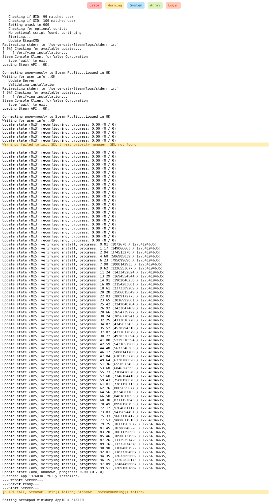

Hi all, i having some problem with my server and i have just rebuild my shinobi pro docker, and i keep having this log. how do i fix this ya many thanks -

do you have this "Warning: failed to init SDL thread priority manager: SDL not found" in your log?
it havent, becos i have this link of warning log, i search the forum, seem like it need the "libsdl2-2.0 libsdl2-2.0-0:i386" but i donno where to run this, i try to run on the docker console, cannot. and yes i try 7777 it say authentication error thing, using steam server also cannot. i think the "Warning: failed to init SDL thread priority manager: SDL not found" is the issue, the server was not fully up yet.
