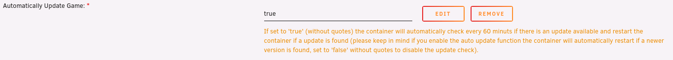

  • The description actually says that you simply have to restart the container if a update of the game is released:   The reason why I asked @Snipe3000 is because I implemented also a upd
The reason why I asked @Snipe3000 is because I implemented also a update script (because many user requested it) that will check automagically if a newer version is available every hour and restart the container if a new version is found if this variable is set to 'true':
