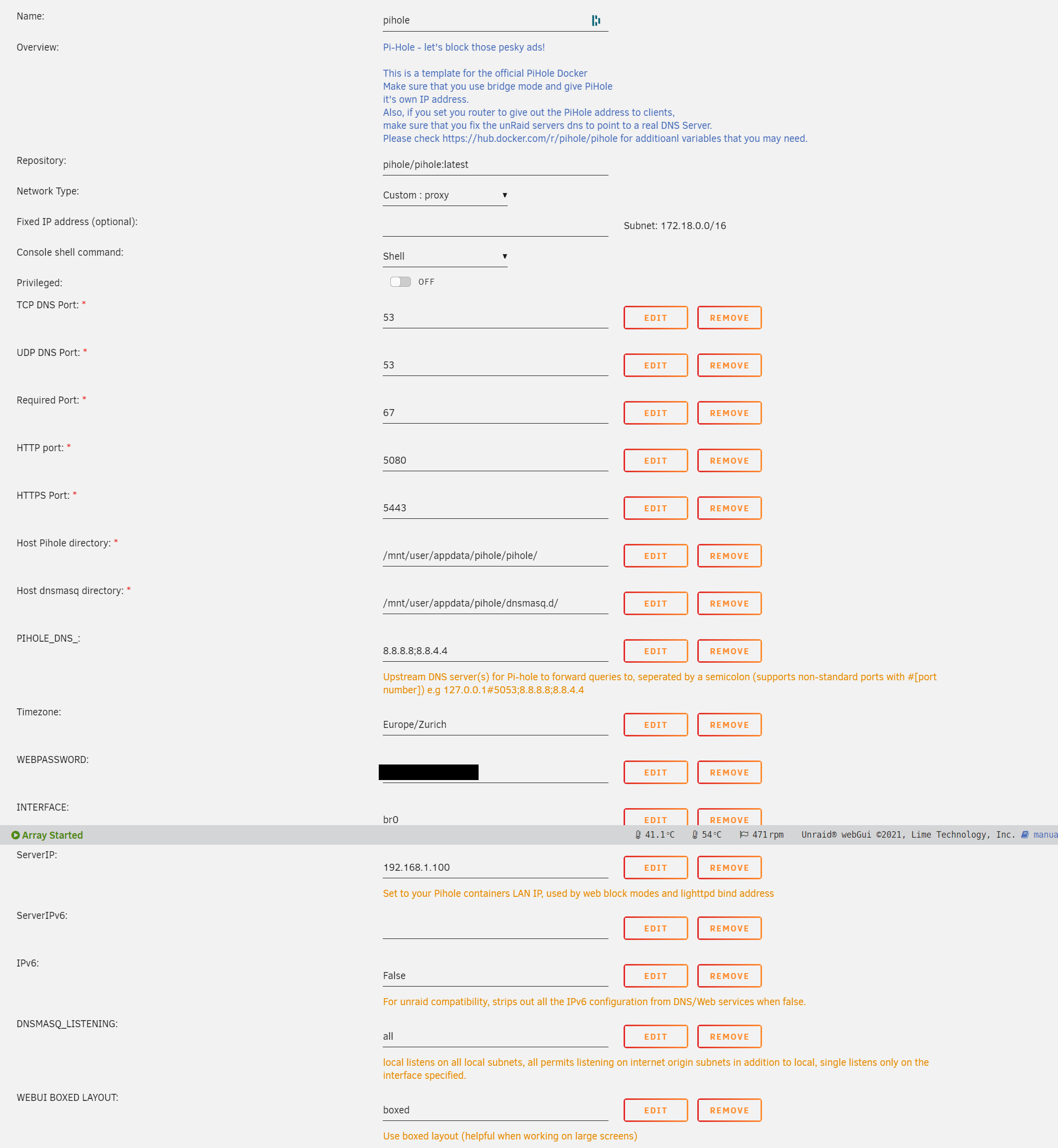

  8. I just did a fresh reinstall and it seems like pihole has an issue reaching the upstream DNS servers when updating the blocklist: # cat /etc/resolv.conf nameserver 127.0.0.11 options ndots:0 # pihole -g [✗] DNS resolution is currently unavailable [i] Time until retry: 120^C [i] User-abort detected PIHOLE_DNS_ is correctly set to 8.8.8.8;8.8.4.4 but that doesn't seem to be used here.
