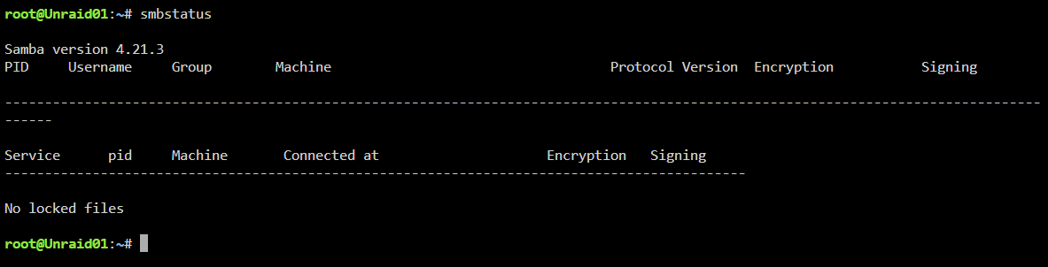

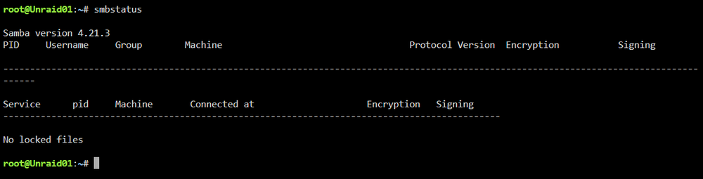

  14. I should word that a bit differently. I'm able to access my other NAS (Synology) and its shared folders from my windows PC. Only one client computer is involved. The only Server with the problem is the Unraid server. I'm only able to access the Unraid shared folders if I use the IP address instead of the server name "UNRAID01"
  15. Here is what I'm seeing: And nothing returns when I use the Get-SmbConnection command in a admin powershell terminal.
