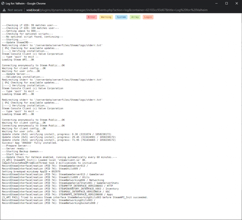

I dont know what i am doing wrong...
i have tried to set up the server with Valheim Plus for a day now without any luck. i allwas get stuck and get this error message "[S_API FAIL] Tried to access Steam interface SteamNetworkingUtils003 before SteamAPI_Init succeeded."
Settings i changed:
Network type: fixed ip (Custom: br0)
validate instalation == true
Servername
worldname
Public Server == 0
Valheim Plus == true
Edit: the hole log befor it stops:
Please use the support thread for the container (click on the Valheim icon on the Docker page and on Support), but from what I see you do nothing wrong. ;)
What is wrong with this message? Nothing to worry about.
Do you need a static IP? I would recommend to use bridge mode but that won't prevent the connection to the container.
Please don't set this to ture because this will always force a validiation from the game files and the start takes much longer than usual.
The log looks perfectly fine and the server is waiting for connections.
How did you try to connect or whats the issue?
Have you made sure that the password is at least 6 characters?

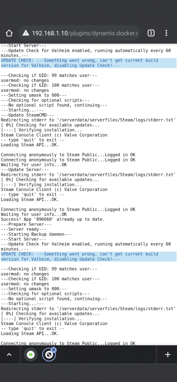

I managed to get it up somehow, but I ran nto another problem. after the last update it went back to just creating a new world. and it hadn't taken any backups between december 30.th and January 8.th. I managed to restore a backup from December 29.th (all others where empty new worlds) even though we had played until probably a few days ago with no issue. I tried to enable debugmode to rebuild what we lost. It lets me enable devcommands, but not debug mode, saying it's "Not valid in the current context" even though I copy-pasted my steam ID into the admin list.... I tried reinstalling the server. Letting it start and create a new world, upload my world files, and copy the neames of the new world over to my old files and deleting the new one. But it now again just starts a new world.

4 hours ago, HaakonS said:
  ServerFiles: /mnt/cache/appdata/valheim
This is probably your issue, make sure if you select /mnt/cache/appdata/... that your appdata stays on the cache and the mover takes no action.
