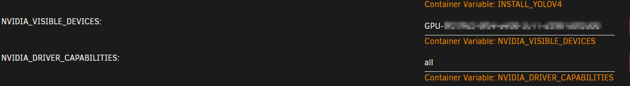

@dlandon - I was curious if the order in the two nvidia variables was to blame. When watching the re-install after updating parameters I noticed this:

Working on recompiling with GPU support. I've added the two variables mentioned in the link GPU thread @dlandon include in his GPU support section of the first post. How can I tell if the ZM container sees the graphics card? I don't see any ZM related GPU processes using "watch nvidia-smi". Is there another method? Could this be related to my monitor settings (moddetect/nodetect)? ** update ** I guess I have some other problem here. Towards the end of the opencv.sh script +-----------------------------------------------------------------------------+ | Processes: GPU Memory | | GPU PID Type Process name Usage | |=============================================================================| +-----------------------------------------------------------------------------+ ################################################################################## Verify your Nvidia GPU is seen and the driver is loaded. If not, stop the script and fix the problem. plex related container working fine:
