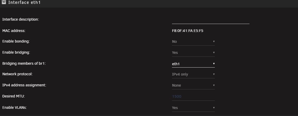

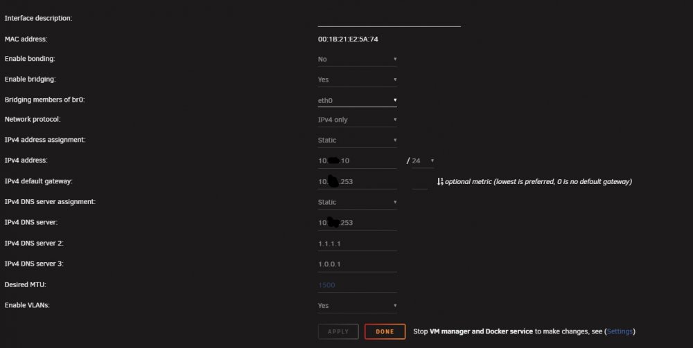

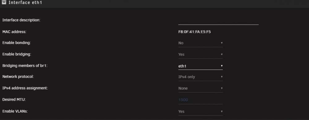

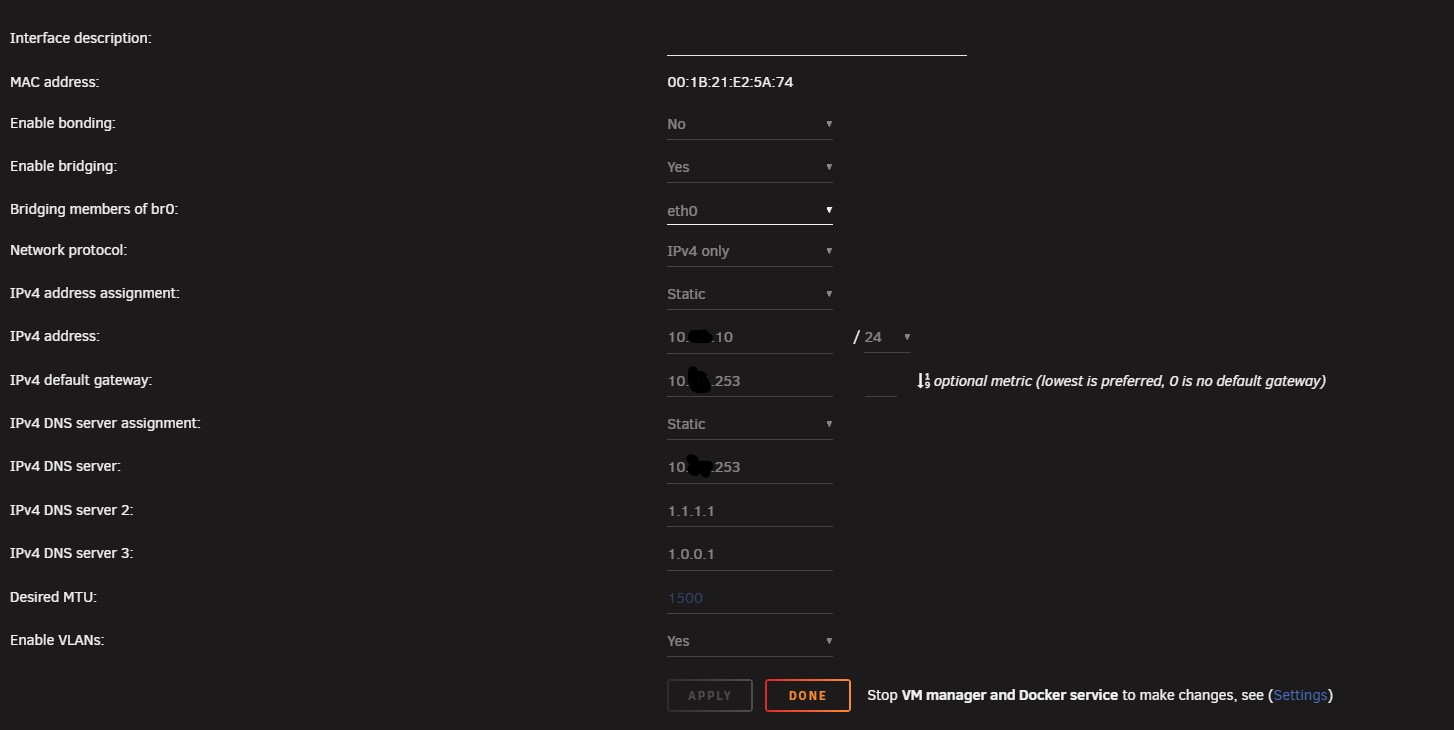

KVM can not access Dockers on same netowork when using different interfaces
Ok, I will try that thank you. Will that affect my VLANs on eth1? Also note: eth0 is a 10G, and eth1 a 1G interface, does that matter... i.e. will eth0 still be used to access the unraid and files, dockers, and eth1 the KVM/others used on eth1?

VLANs, or easier if you have multiple nics. More details on your system would help. I have this working with VLANS and smart switches (unifi). Once you have the bridge/nic installed and setup, you need to enable its use in the Docker -> Advanced menu. KVMs I believe it just shows up in the list of available network sources- KVM can not access Dockers on same netowork when using different interfaces
60 views and no ideas? should I email unraid directly? Thank you to those that took the time to read but unfortunately don't have an answer for me- KVM can not access Dockers on same netowork when using different interfaces
I have several network adapters on my unRaid server 6.10.3. Dockers run on the default eth0, aka, br0, well I assume that based upon choosing "Network Type" to "Bridge", it will use the same adapter that the unRaid web ui is presented on. So a docker running on the default "bridge" network. KVM running on eth1 (which i have connected to the same LAN as eth0, i wan't to spread out network traffic to KVMs vs File Share/dockers). I can Access the KVMs and the Dockers just fine from another computer. Issues arrise when I try to access a Docker from the KVM. I keep getting "connection reset by peer". I assume some kind of firewall/issue on unRaid is causing this? or is it Docker? Is there a command I can run to fix this issue? Thank you!- Can't access host from VM or some Dockers
