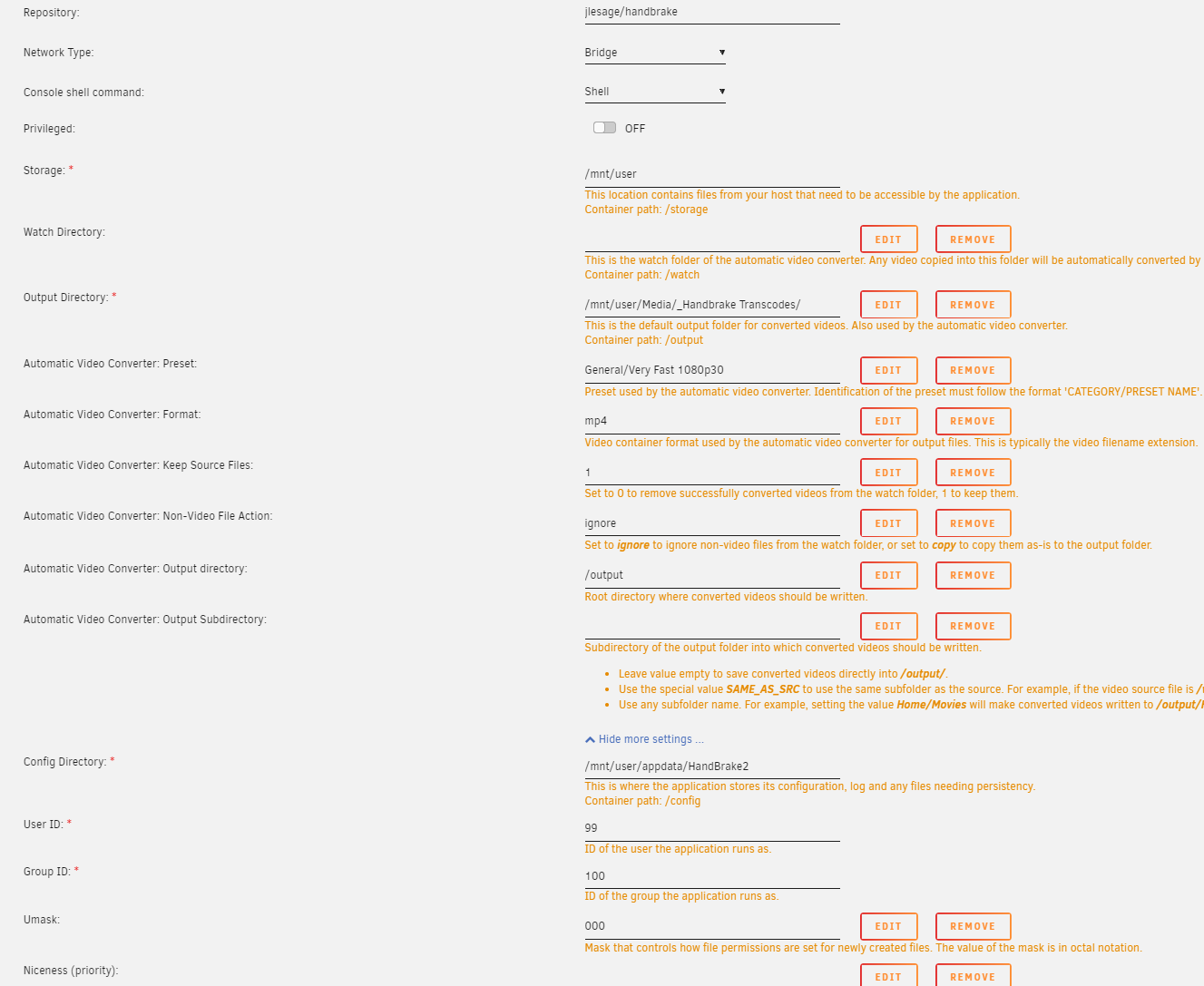

  2. Hi guys. Been using unraid/handrake for a couple years now and successfully encoded TB of video, all of a sudden I'm getting the "Cannot read or write the directory error" I haven't changed permissions anywhere to my knowledge, output folder is set to : /mnt/user/Media/_Handbrake Transcodes/ and this is the folder i'm choosing to save to. I have tried different folders with the same error. permissions look right to me: ls -la "/mnt/user/Media/_Handbrake Transcodes" total 23851556 drwxrwx--- 1 nobody users 41 Mar 30 2021 ./ drwxrwxrwx 1 nobody users 23 Feb 2 2021 ../ handbrake docker settings and diagnostics attached. There's no encode log because encoding won't even start. Edit: I can encode from within windows handbrake to this directory no problem, its only in unraid that I'm having this issue. I've removed and installed fresh docker image.. nothing working for me. Hope someone can point out what will probably be an obvious mistake, thanks! diagnostics-20220226-1150.zip
