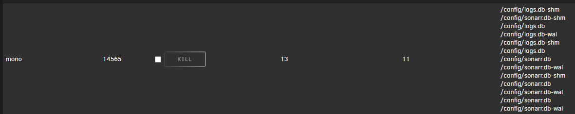

@Kaizac FIXED!!!! Solution was permissions were FUBAR majorly, and I finally moved enough of the file structure to 99:100 which solved it. Thank you so much for working through this with me. Weirdly, I still have had an error a few times with sonarr container not stopping because of mono as shown above. -

I'm still working through some permutations but wanted to add a bit more info. When I try to stop the Sonarr container after it has the importing issues above, I get an execution error and I can't stop the container. Using OpenFiles I can see that mono is what's using sonarr and keeping it from closing. Here's the listing in case it's helpful.
