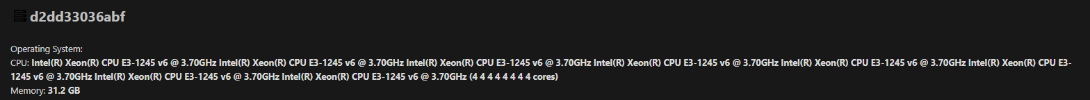

  10. Hi, can we rename the machine in nextcloud? Under Settings>Administration>System, could we change the machine name? (the d2dd33036abf?) Additionally, what happen to the cpu info? can it be fixed? Thanks
  11. Hello, I would like to share my solution to getting an out of the box Bluetooth and wifi solution for the macOS vm. With bonus hot plug USB ports. (Also works for windows vm) Using: 1) Broadcom BCM43602CS (wifi card from an MacBook) on a PCI-E x1 adaptor card with Bluetooth wires 2) ORICO 2 Port USB3.0 PCI-E Expansion Card (PME-4UI) [Fresco FL1100 controller & a 19 pin USB3.0 port] 3) USB3.0 19 pin female to USB2.0 9pin male adaptor I put both cards in 2 PCI-E x1 slots, and connected the Bluetooth wires to the orico card 19 pin slot through the 19pin to 9pin adaptor. All recognised in unraid system devices. Then using vfio-pci.ids command and xml edits I passed the 2 cards to the macOS vm. Now I have full wifi and Bluetooth functions on the vm, as well as 2 hot plug USB 3 ports available and working. With boot camp drivers, I am able to also get the wifi and Bluetooth working on a windows vm, as well as the USB ports. As a side note, now my previously working ORICO 4 Port USB3.0 PCI-E Expansion Card (PME-4U) is now undetectedable by unraid, which now only sees the 2 port version. Now the 4 port card does not appear system devices (PCI Devices and IOMMU groups) and will not in see any usb devices in the 4 port card. Anyone has any ideas how to fix this?
