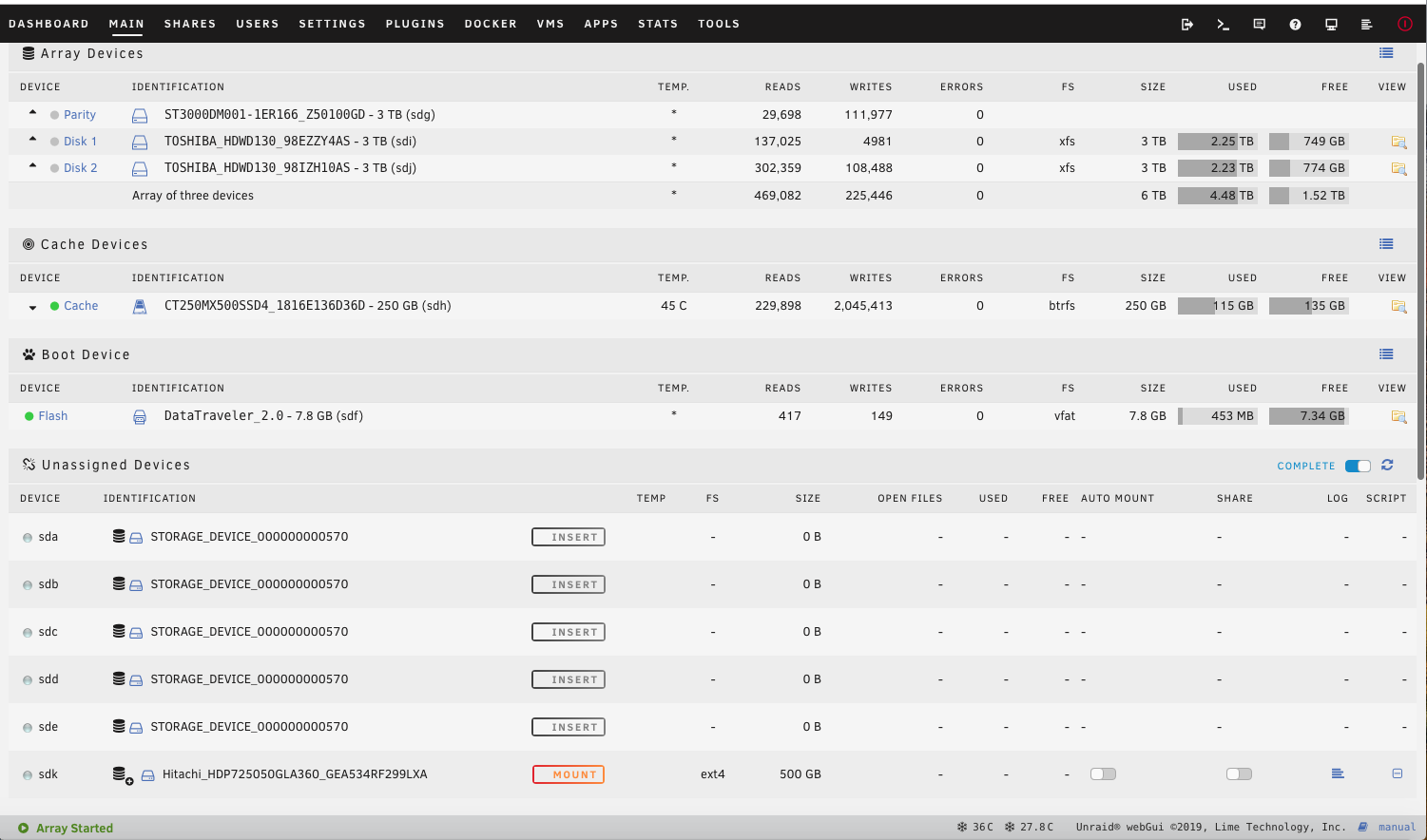

Yes, it does spin up the drive! I assume you intended me to change the X to the actual drive letter?
Ok so I removed UD plugin and the drive doesn't spin-up! Have re-installed and it spins-up again, so its UD that is making the drive spin-up!
Yes I’m on rc5, ok. I’ll try your suggestion of removing the plugin over the weekend! cheers, Tim

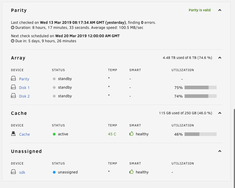

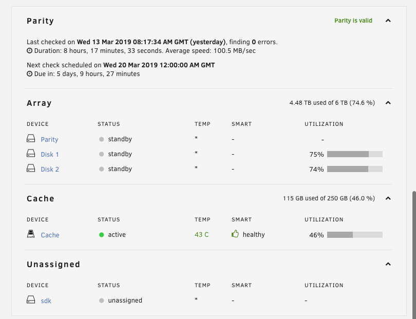

sdk is spinning up. I know it's this one as it spins up no matter what the array is doing! I the following screenshots you'll see that the array is actually spun down and so is the sdk drive, I access Main page and here a drive spin up, go back to the Dashboard and the only change is sdk.
Ok done that and sorry still spins-up.

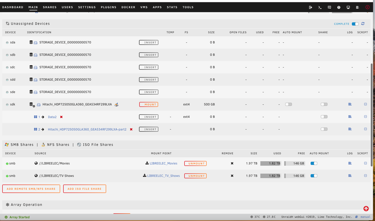

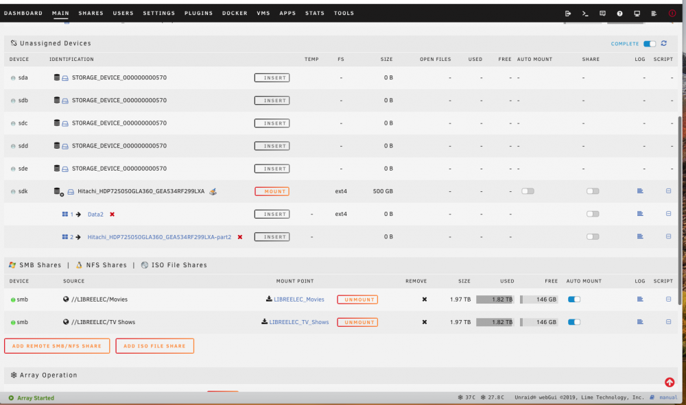

Hi, screenshot attached. There is only one disk now as moved the other to the array, as you'll see it has 2 partitions. 1 partition is used in Ubuntu VM and the other in Windows 10 VM. Cheers, Tim
Hi, sorry no still the same, I also re-booted server just in case!
Hi, sorry and thanks for clarifying, I had read that bit when I was trying to work this out myself. So I added the default script hoping that it would fix the problem but unfortunately, it didn't! Thought I'd deleted it but it was still there just empty, have now deleted it by clicking the red cross. Still have the same problem though, drive spins up when accessing Main page? Cheers, Tim
Hi, thanks for responding but that doesn't answer my question. Unassigned devices shows the status of the drive ie. spun up or down temp etc. What I'd like is for them not to spin up when I access the Main page on Unraid UI, I know they do it because I hear them start up, then the only way to spin them down again is via command line! Is this possible? Cheers, Tim

Hi, not sure if this is a fixable problem but my drives are unmounted and used only for VM's as I only use a VM maybe once a week I want them to remain spun-down, but whenever I access the Main page they spin-up and the only way to spin them back down seems to be to open a terminal and use hdparm? How do I stop them from spinning up unless needed? Cheers, Tim
