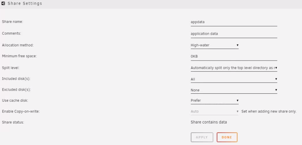

  11. Gotcha, it appears to be using just the Cache (7.5gb). I'm not sure if you saw my edit before which showed the details of the /appdata share settings Should I be changing the Included Disks from All to Disk X? If I do that, would you anticipate any issues with loss of data even though everything is on /cache right now?
  12. Thanks for the heads up. Which setting are you referring to when you say it depends on the appdata share settings? Under Global Share Settings, I have Enable Disk Shares set to Auto, User shares set to Yes, and Included Disks set to All. Is there another setting that you were referring to? Edit: Under the Shares section the /appdata share is also configured to use All Disks here. Should I be changing this to only a specific disk? Can I do this safely without losing data?
