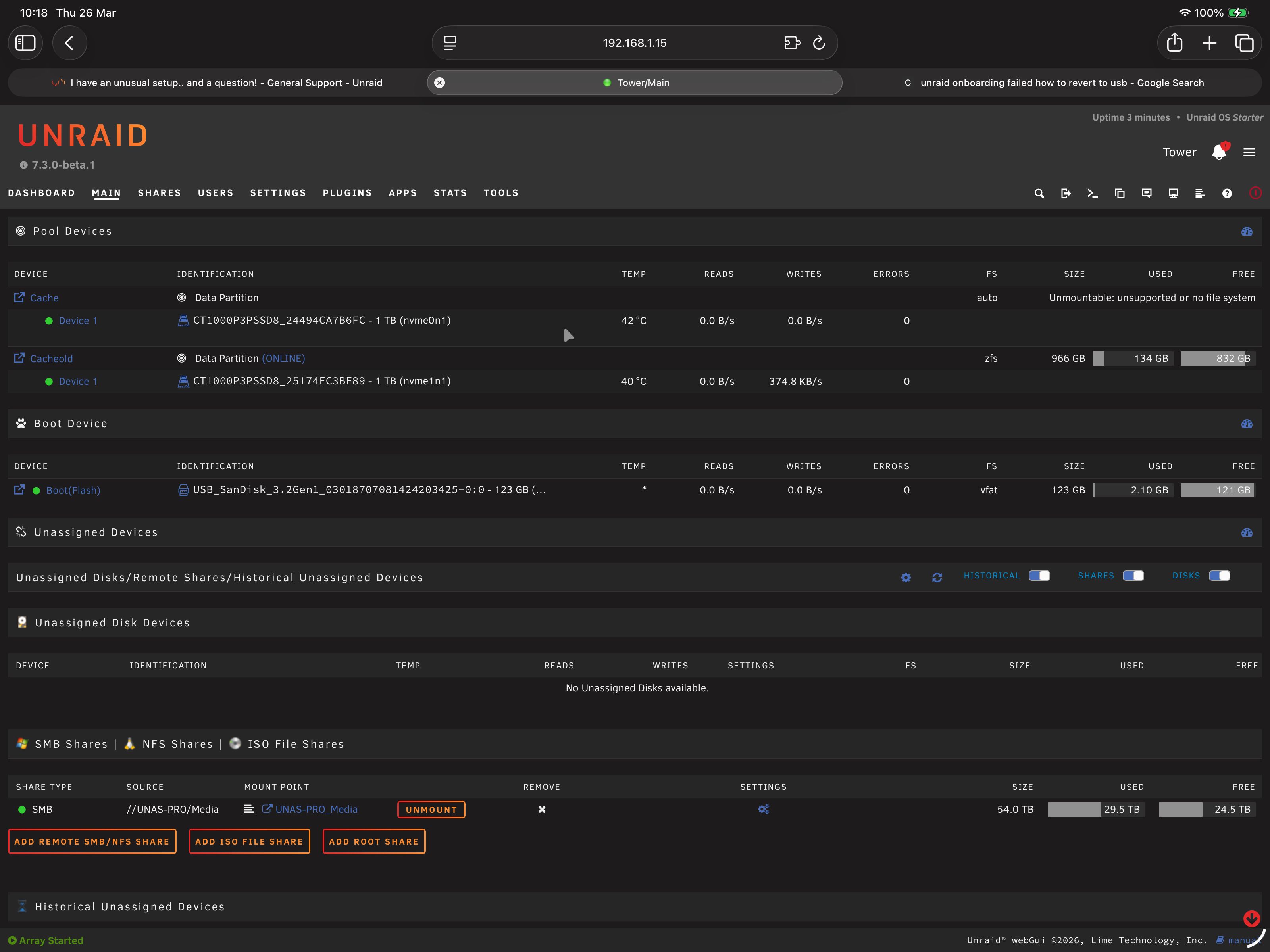

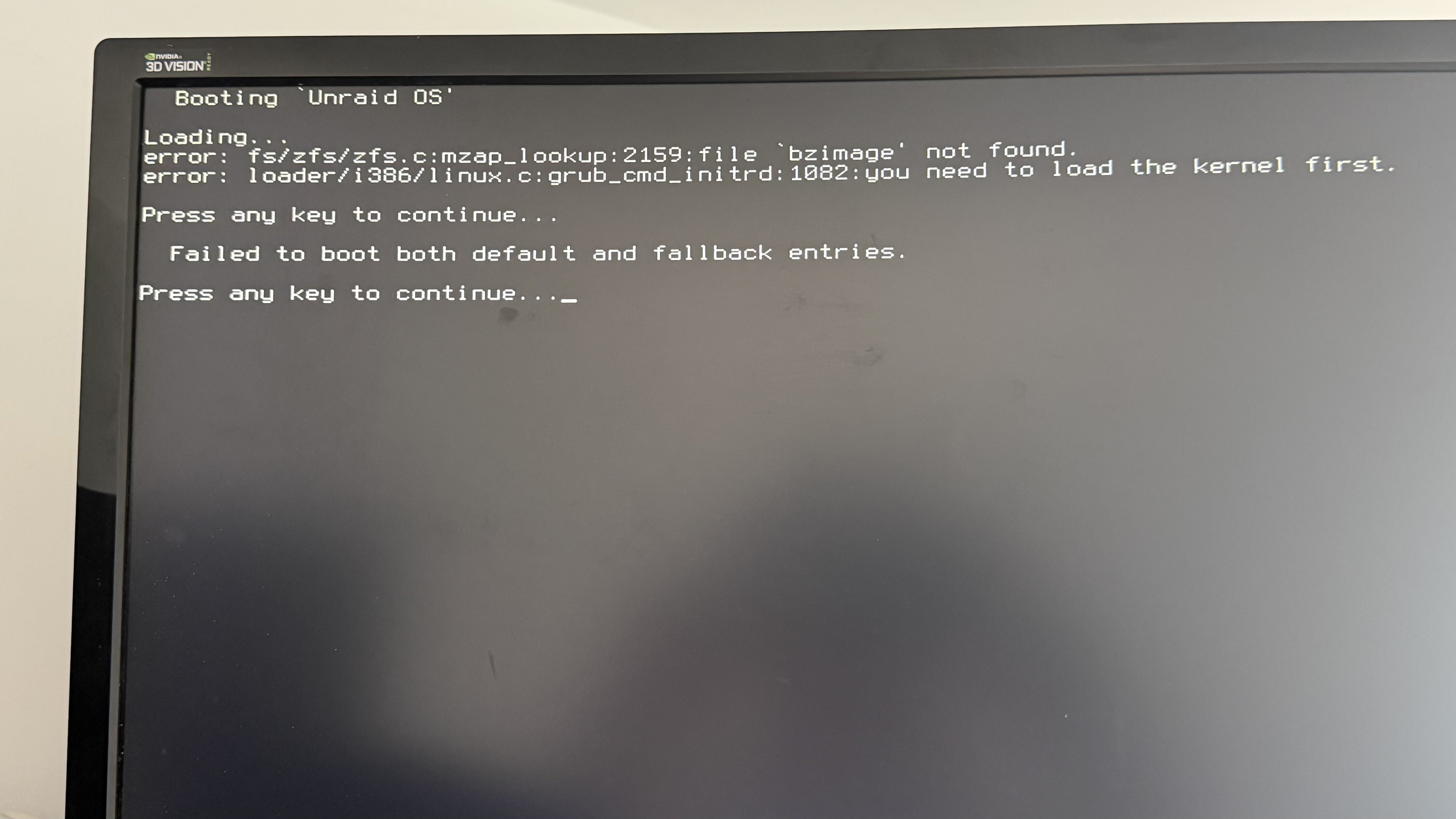

I have it back up and running but it will only boot from USB. I get this notification : Unraid Booted from USB Device26 Mar at 10:35 Internal Boot AvailableThis system supports internal boot, but Unraid is currently running from a USB flash device. Please change your boot order via your motherboard BIOS. And I now have only 1 SSD in the cache obviously. No idea how to fix now so that I can use internal boot because the Onboarding Wizard no longer works. Changing boot order in BIOS results in the missing bzimage error etc..
I have an unusual setup.. and a question!
I got back in by changing boot order to USB. But now I have this and can’t get into the Onboarding Wizard, it just doesn’t open.

I have an unusual setup, because I don’t have an array. I have 2 cache drives in a pool (basically mirrored I think) and I use SMB on a UNAS PRO as my storage. I watched SpaceInvader One’s video about migrating to internal boot, but I have no options to use the mover etc. As I have a cache which is a 2 SSD pool, is there a way to separate it temporarily or something, reformat one and then copy the data back from the other and then add the drive back into the pool? Or maybe add a USB drive as an unassigned device and copy the data to that? Just don’t want to lose my Unraid config because all the apps have been fine tuned over time.
