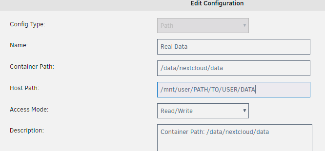

  11. Just create a new path like this (replacing host path to the path where you want the data to be stored at): This will overwrite the the real data folder where the user folders are created at, this works even though we're already passing through the root /data folder.
