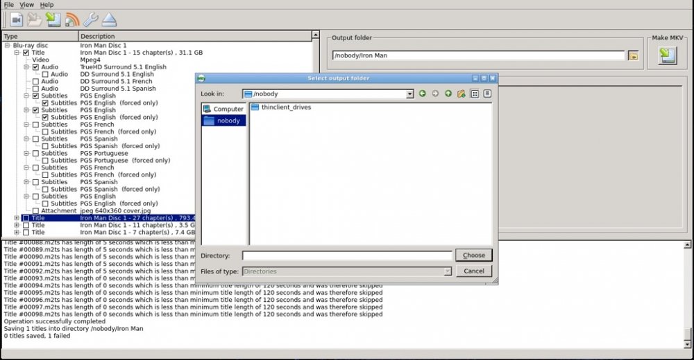

  15. I also deleted the /appdata folder too just in case. The command finished successfully! MakeMKV Docker is up and running! Thanks everyone for your help, this was really bizarre and hopefully doesn't happen again.
  16. Ok, rebooted, no changes. Can't even get Docker to run. How should I proceed now? Delete docker.img from /cache ? Or is there more to it than that...
  17. I'll try the reboot first! I'm not opposed to re-creating the Dockers as I don't have very many or complex setups.
  18. You made me do the math... My docker.img is 10GB. The dockers I have are: 2.114GB, 1.15 GB, 2.132 GB, 1.024 GB, 541.5 MB, 603.9 MB 2114+1150+2132+1024+541.5+603.9 = 7565.4 Should have ~2.5 GB of free space in there still.
  19. Ok, I did that and now the Docker tab is not re-appearing. Hmmm... root@Tower:~# docker -d INFO[0000] [graphdriver] using prior storage driver "btrfs" INFO[0000] Listening for HTTP on unix (/var/run/docker.sock) FATA[0000] Error starting daemon: Couldn't create Tag store: EOF
  20. CONTAINER ID IMAGE COMMAND CREATED STATUS PORTS NAMES f92a0a4d2e20 l3iggs/owncloud "/root/startServers. 5 days ago Up 5 days 0.0.0.0:8000->80/tcp, 0.0.0.0:8443->443/tcp ownCloud cfdb258b9c04 sparklyballs/handbrake "/sbin/my_init" 3 weeks ago Up 3 weeks 0.0.0.0:1010->8080/tcp HandBrake 3661cf18e903 captinsano/rutorrent "/docker-entrypoint. 4 weeks ago Exited (137) 5 days ago ruTorrent 8e2dc27dce5a needo/plex "/sbin/my_init" 4 weeks ago Up 3 weeks PlexMediaServer Maybe there's something "stuck" in the background with Docker? Is there a way to stop/restart the Docker engine? I can always reboot the entire machine to try and get back to a clean slate.
  21. REPOSITORY TAG IMAGE ID CREATED VIRTUAL SIZE <none> <none> 9242a6055753 12 days ago 2.114 GB tobbenb/makemkv-rdp latest 9fcc556701fc 13 days ago 1.15 GB l3iggs/owncloud latest a68bea84a28f 4 weeks ago 2.132 GB sparklyballs/handbrake latest 7912e0056bbc 8 weeks ago 1.024 GB captinsano/rutorrent latest 3f638c0d04d3 4 months ago 541.5 MB needo/plex latest 8906416ebf13 5 months ago 603.9 MB
  22. I get this error message: Command: root@localhost:# /usr/local/emhttp/plugins/dynamix.docker.manager/scripts/docker rmi 9fcc556701fc Error response from daemon: No such image: 9fcc556701fc Error: failed to remove images: [9fcc556701fc] The command failed.
