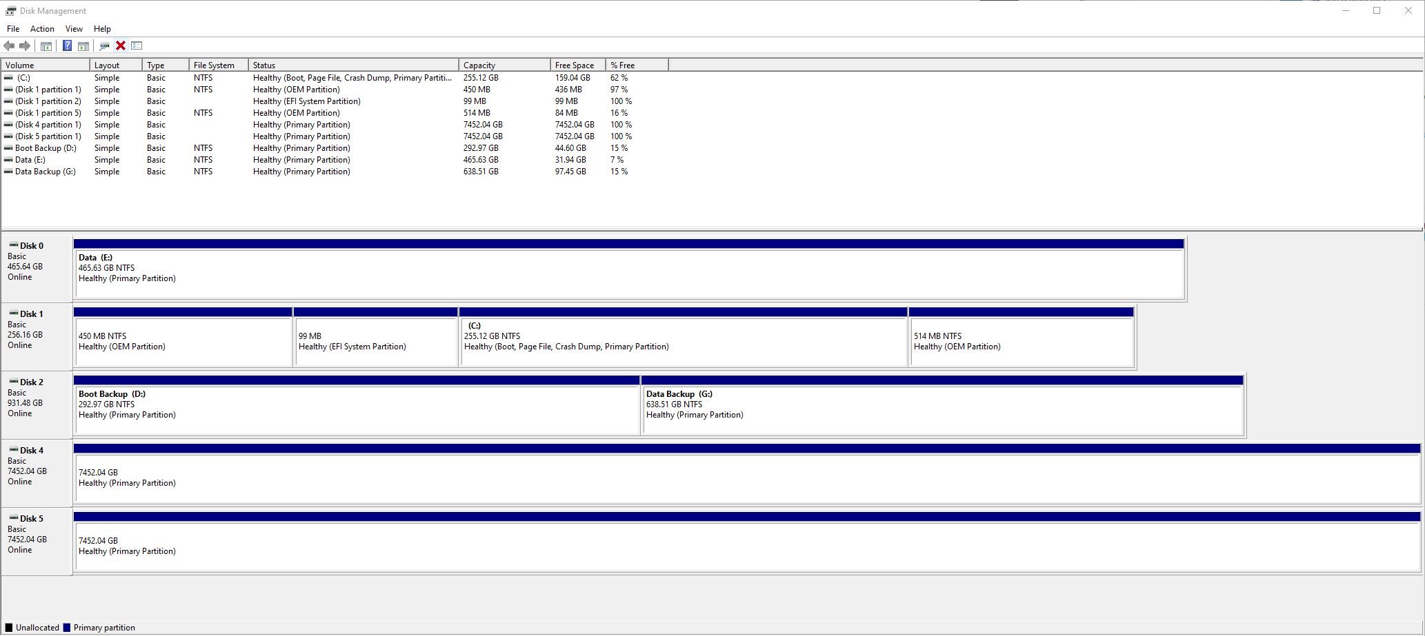

  8. Just recently I pulled 2 8TB Seagates Compute (SMR) drives to replace them with 2 8TB IronWolf Drives and found problem. Please let me know what I did wrong. My understand was that since UNRAID was not a RAID I would be able to pull any drive (minus parity) and access the data using my USB 3.1 Drive HUB or other enclosure. Well, I tried this theory and found that the drive which had 5TB out of 8TB used showed up as empty. See screenshot attached. ( DISK 4 & DISK 5 ) I have all the data archived so it's not an issue but since I'm rebuilding this array from scratch I want make sure the new setup drive array will be fully readable outside of the server just in case there was a hardware failure. Please advise and thank you in advance for taking the time!
