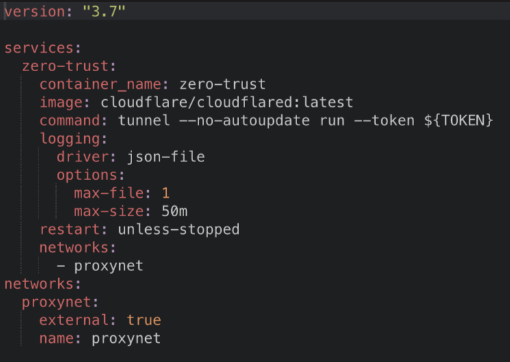

  1. That’s a work around that I’ve used before. I prefer using docker compose due to its portability but that’s a totally viable alternative.

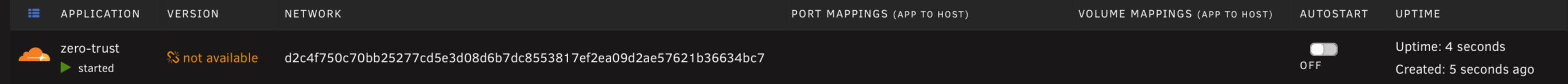

  2. Sure didn’t. It’s not a deal breaker, just makes the ui look weird. It only stresses me out when I’m checking in on a docker issue so I haven’t spent too much time on it.

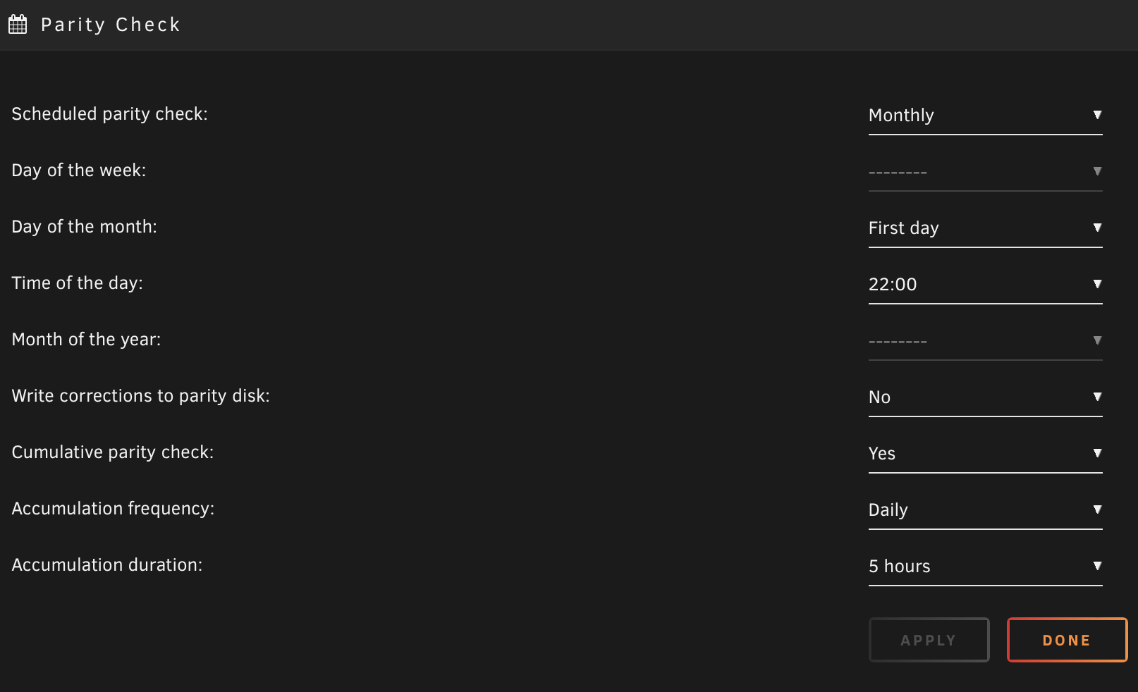

  11. Well another month has gone by and my parity still is not running incrementally. Once parity starts it continues to go until completion. What am I doing wrong? I feel like this should start a parity check at 10pm on the first day of the month, run for 5 hours pause and do it again the next day. Repeat until complete. Am I misunderstanding this?
  12. Discrepancy noted, and corrected. 😉
  13. I recently changed my Parity Schedule to run under custom conditions. I wanted it to run every other month on the first Saturday of the month and only to run for 5 hours a day until parity is complete. Here is how I set it: Scheduled parity check: Custom Day of the week: Saturday Week of the Month: First week Time of the day: 00:00 Month of the year: January, March, May, July, September, November Write corrections to parity: Yes Cumulative parity check: Yes Accumulation frequency: Daily Accumulation duration: 5 hours Today is the first day for the run and as of 10:55 my scheduled parity is still running. My understanding was that my parity would pause at 05:00 and resume daily until parity is complete. Are my assumptions incorrect or is this a bug buried in the custom schedule? In the interim I will switch my schedule to monthly and see if that works. Thoughts?
