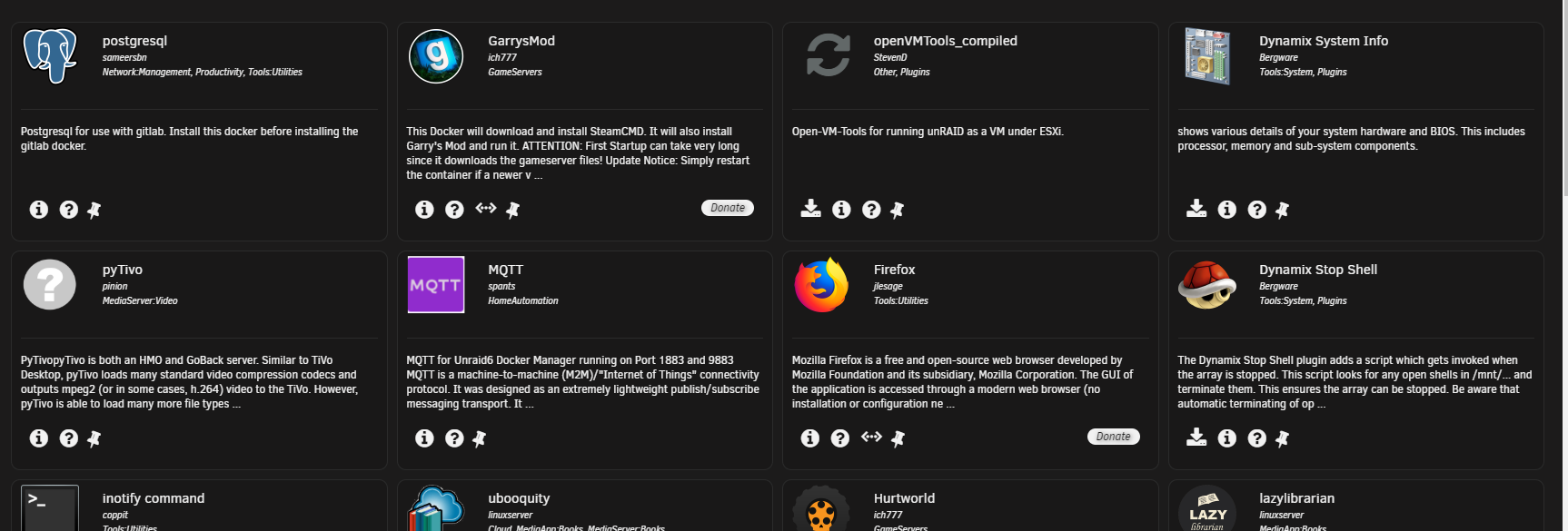

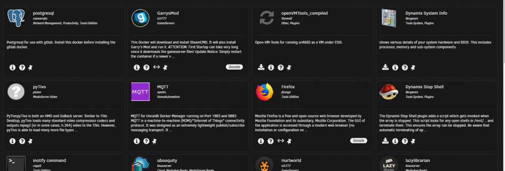

  9. New to unraid trying it out and I have downloaded CA and pinned quite a few apps I wanted while my 24 drives formatted and formed the cluster. Now that the cluster is online every single pinned app has no download button: I thought this was due to a setting or something but I went into the Random Application tab and it shows some do have download buttons and some dont: Anyone have any thoughts?
